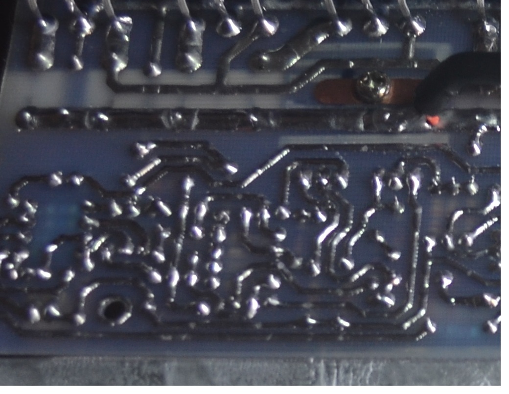

Sir TRMS DMM is to expensive for me .I have only dmm .I know that I need but can't adorable for me . Because I am not belong rich family.is that any way to solve this đŸ˜¢đŸ˜¢đŸ˜¢
hi there sir Sunny22g
i had taken a look at your work seems ok, do not worry about the DMM i made my first B500 and AX14 with analog multimetre only.
bear in mind these module has been made by DIYers and most of them satisfied with the result, so might be the factors will be from us to wit
a. quality of materials though they are not genuine atleast measure it one by one before soldering it, i had been a victim of some counterfeit before but still it work just a little low on efficiency. (now i buy parts from authorized dealers only)
b. did you place some lamp on the other side of the board after soldering to check if some tracks were not shorted? i do that all the time.
c. in cases of doing all means but still does not work you CAN solder all tracks sometimes it can have gaps due to overly soak to etching compound.
i am uploading back your picture and my sample of soldering all tracks

Greetings Sir Sam I am fully satisfied with u .Sir. Tell me if PCB components are touched with other then it's mean some thing Short .And series bulb brighter.but bulb is no brighter.and if short with in 1 min components are burn.but they are not burn
I don't think it means you will have a short, it could be that you are turning on or off the wrong transistor, or pushing current through a cap (that can take it) but shouldn't see that signal.
Just because you have incorrect soldering, does not always mean a short is the result.
Use your DMM to check for continuity in those areas, if so, then correct the soldering and check again. Always start with the easiest things and then move to actually removing parts and testing out of circuit.

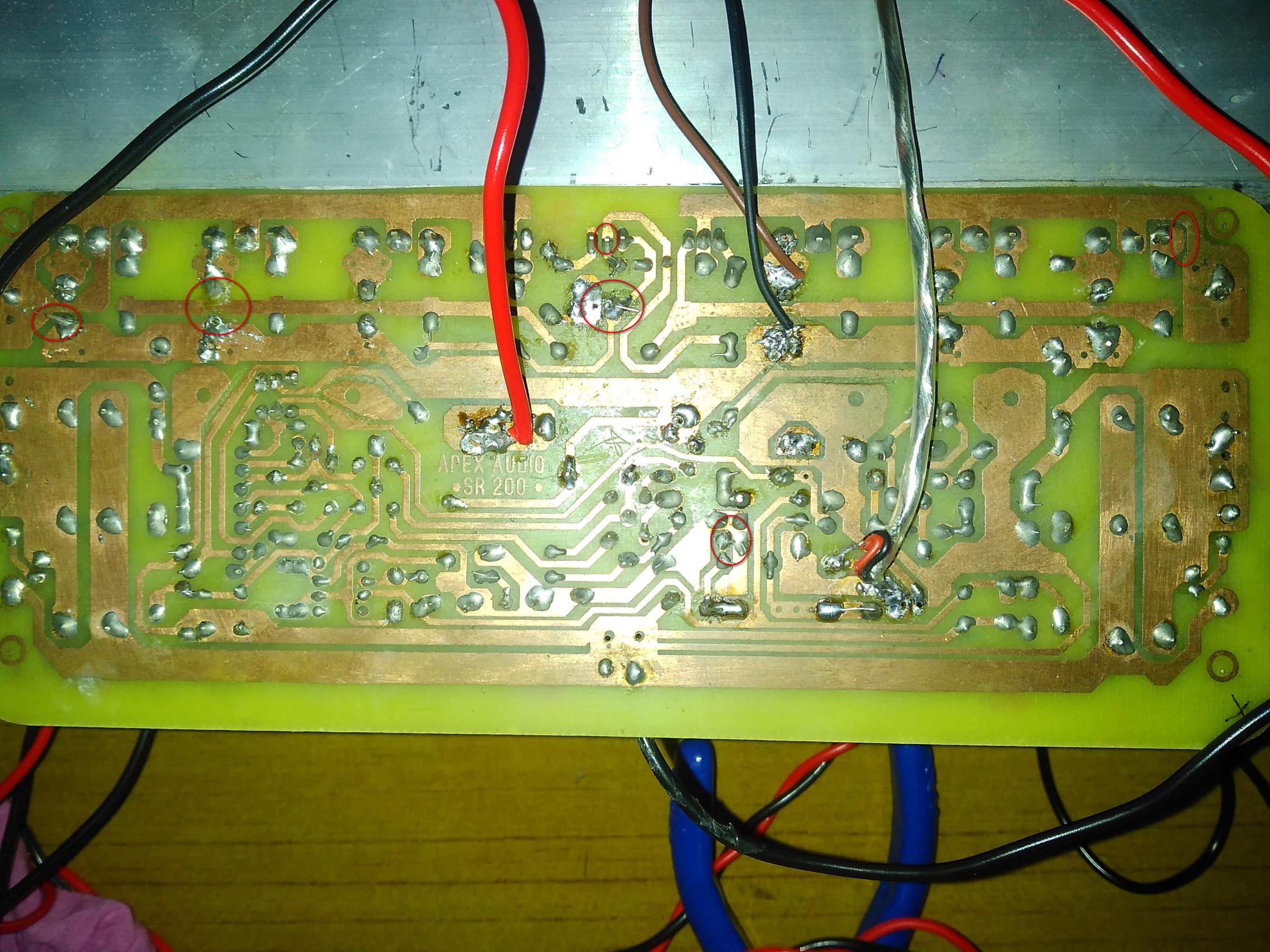

Sunny, please take a picture of the top and bottom of your finished boards and post them here so we can try to help you. You have to give something in order to receive something. We can't help without some information.
hi sir, when i told you to use lamp i do NOT mean the series bulb tester but it should be used to look for short/broken tracks like this process see attached picture coz that is the way i checked the tracks aside from continuity tests.
do not expect us to be able to diagnose if the tracks are shorted to each other. WE only suggest to check those points, but it is you who can assess the precision. Now it seemed that you do not measure voltages of your amp that is why nobody can give advice. people here needs data if you do not give their request then do not expect for answers.
if you start all over again that is ok but it will not teach you troubleshooting problems. you cannot solve problems by avoiding but by facing it.

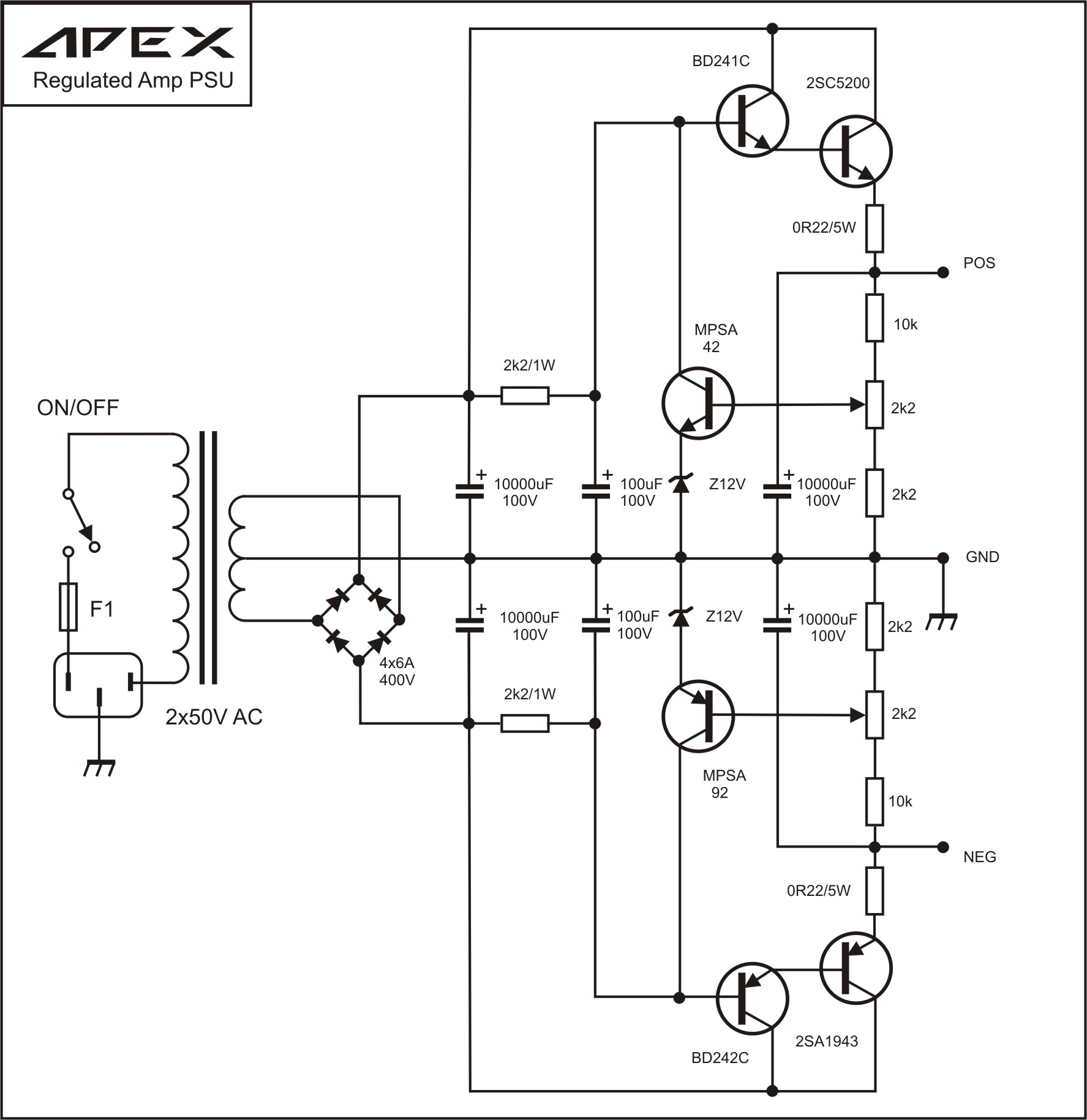

Is it possible to run the SR150 off 42VDC (30-0-30/6A transformer) without losing its qualities ?
I also have doubt about the voltage of the SR150, maximum 55vdc, but the ideal would be 50vdc?

Is it possible to feed two sr150, with this PSU, with 2 pairs?
Hello, do I need to make any modifications to PSU 05 if 25 VAC or 35 VAC is used?
Grateful
Grateful
Use 6V2 instead 12V zeners.
