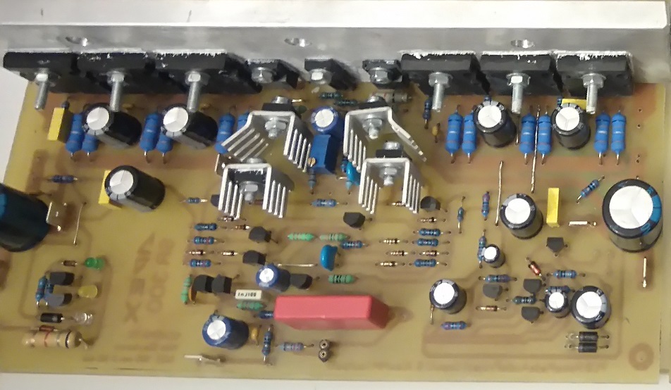

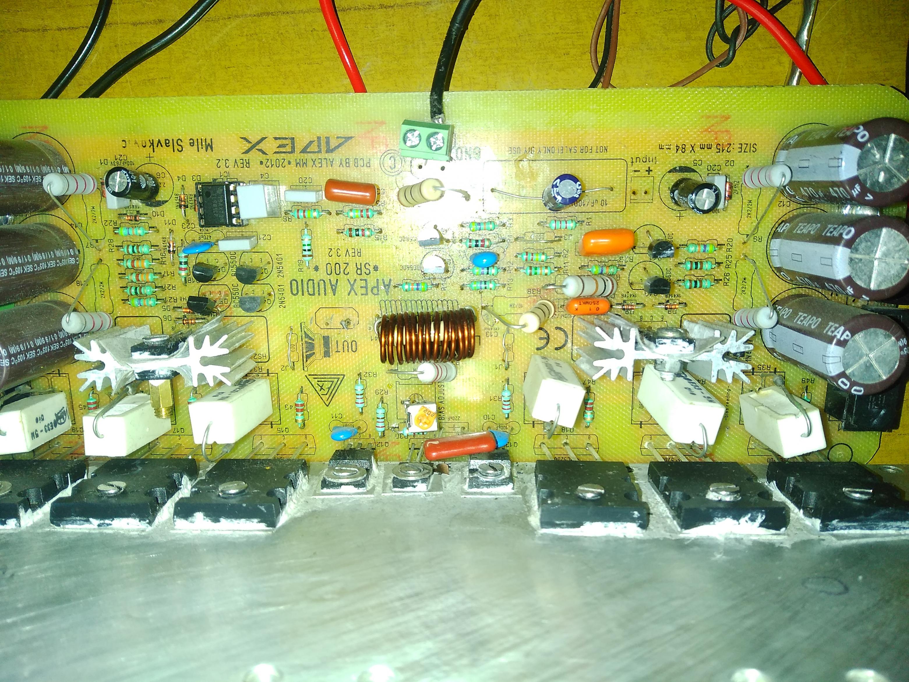

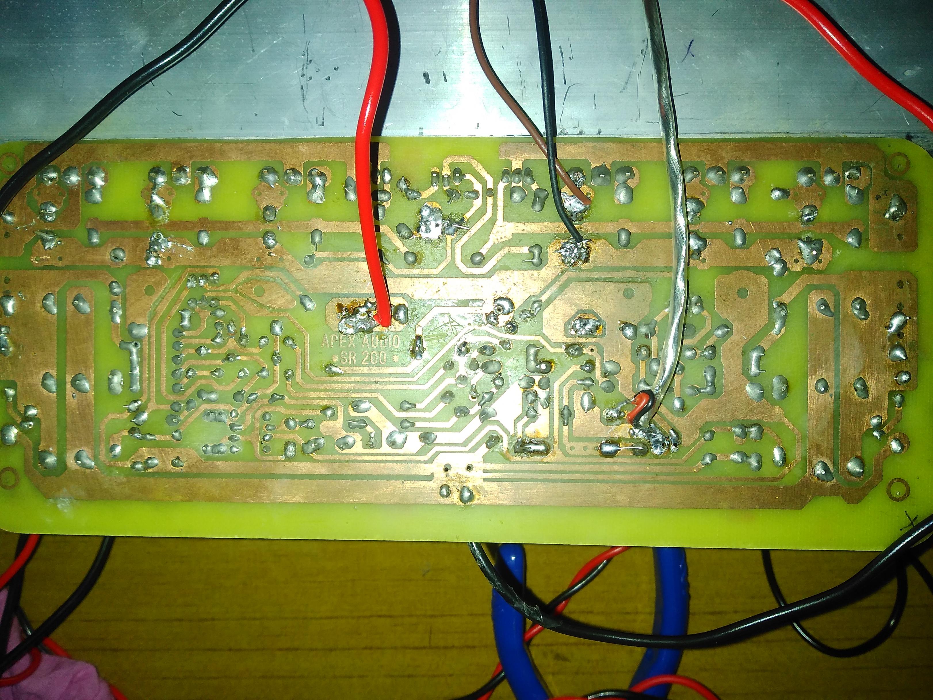

Here is pictures my sr200.up side and down side.sir apex plz check.my bais is 26 millivolt

Finally My SR200 is perfectly working. Lf411 is available in my area so I use TL071. But with TL071 .400 mv DC on speaker out terminal. Now I change TL071 with AD711, now DC is 000 on speaker out terminal. Now my sr200 sounds superb.I think my tl071 fake or may be its gain too high for this amp.
Thanks Mr. Miles for this such good amplifier and Thanks for other Diy members who very helpful for save my Dream.

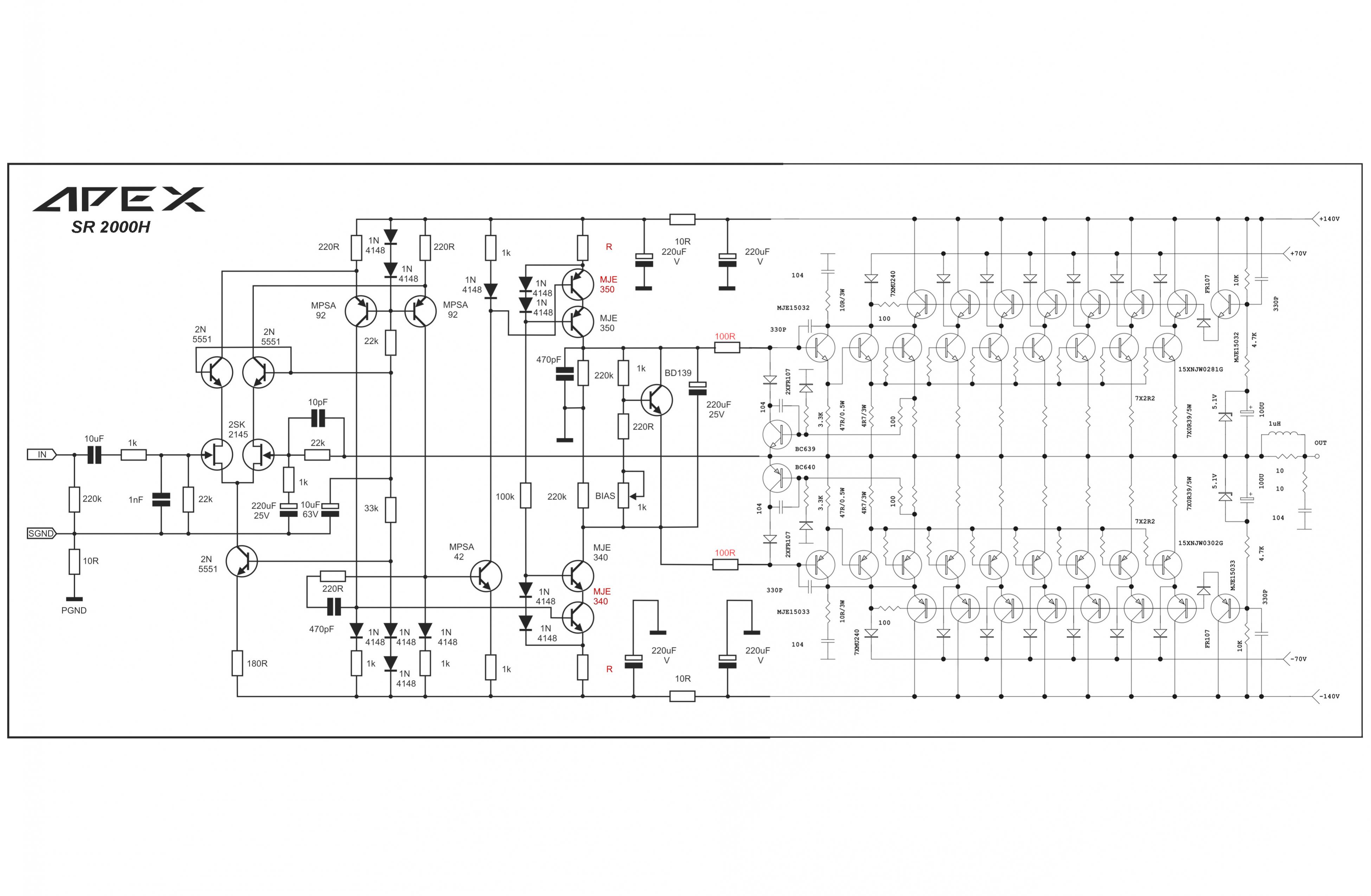

Greetings sir mile will this be possible for SR300 Input-VAS added with BA2000 Output? or what changes of values of components,,,
i have complete components for SR300 but just thought to have it in Higher Voltage
