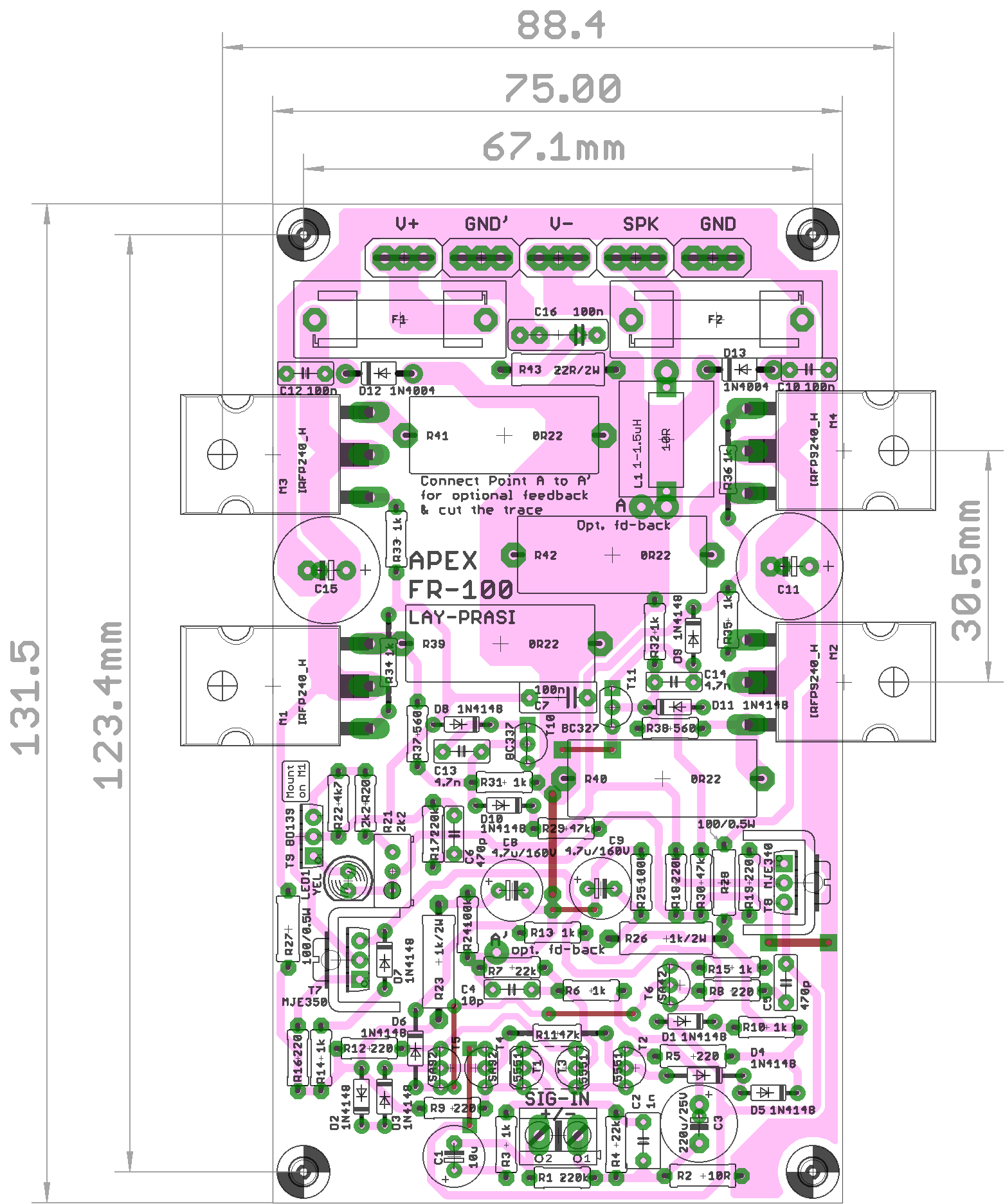

Nice layout design Prasi ,

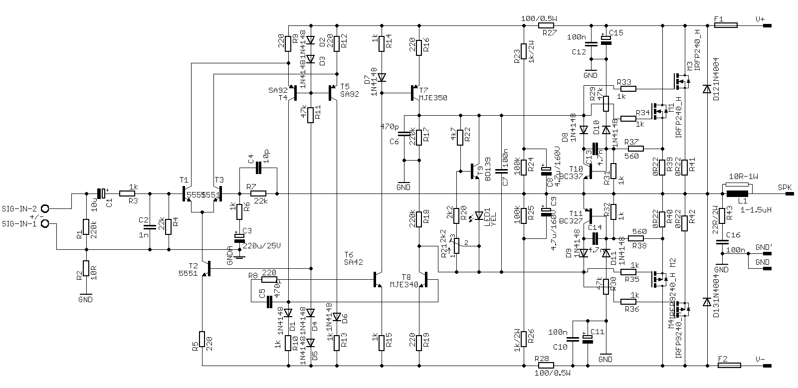

*please be corrected again in part (M2 IRFP9240) the red circle . I think the connection is reversed between pin D & S.
*Emitter T10 & T11 must connect with out/spk, please see Apex fr100 original sch.

Thanks Kuntarman,

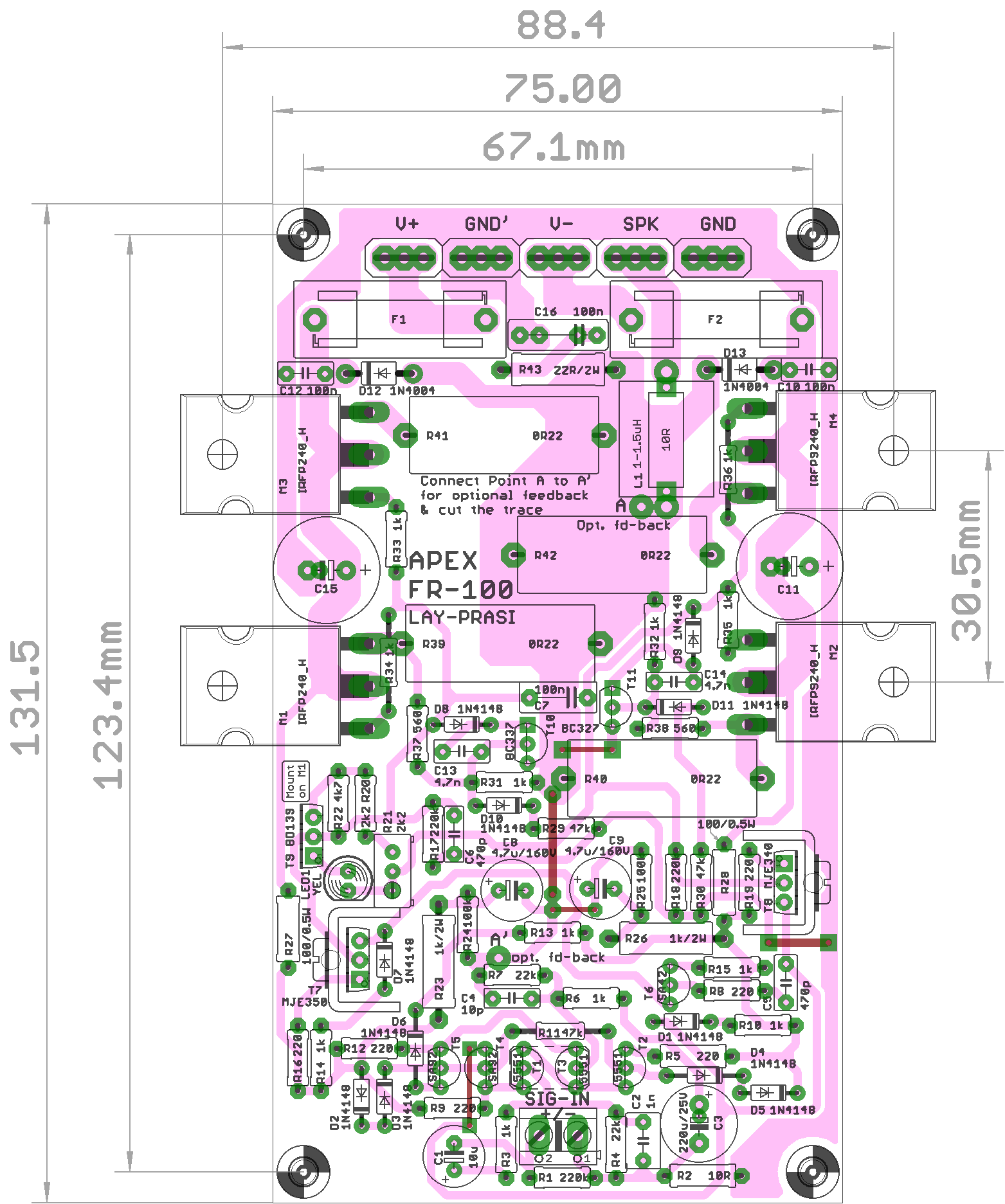

I noticed too, it was a mistake in schematic, here is the corrected and improved version with less jumpers.

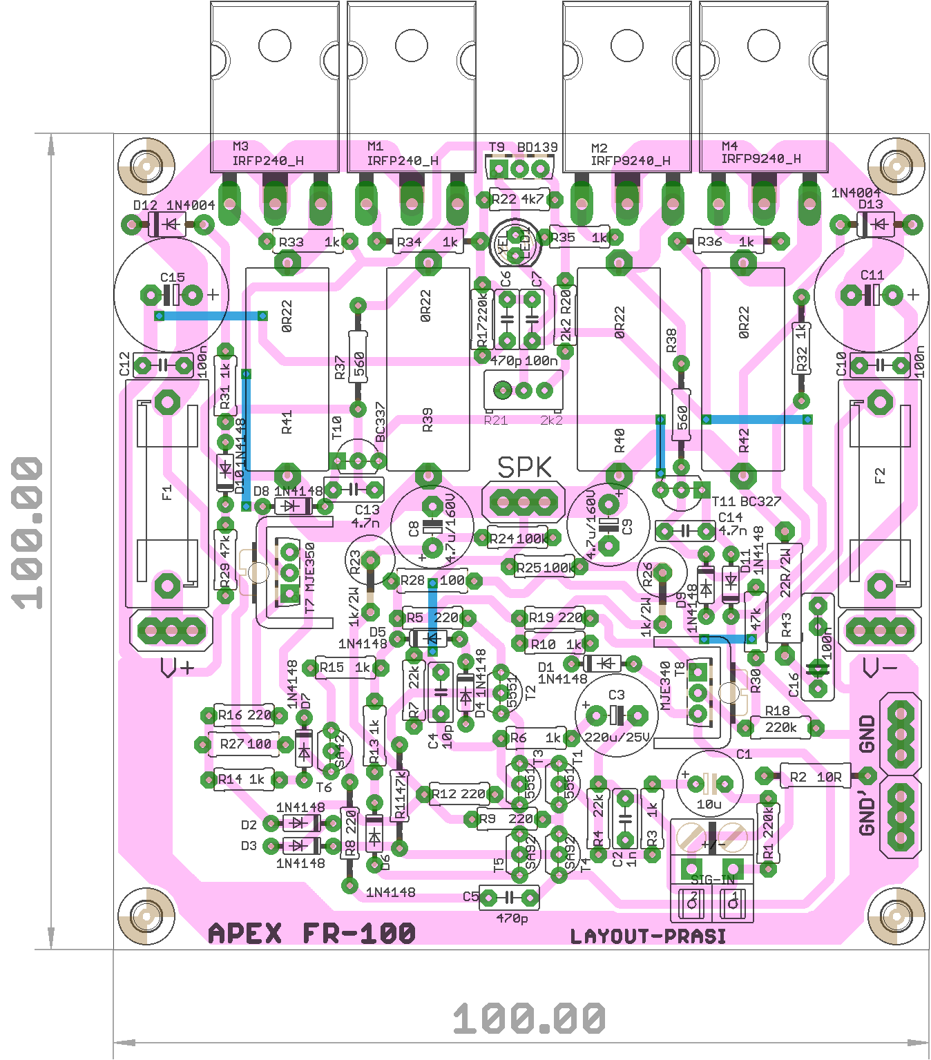

I wasn't too happy with the vertical side-by-side mosfet layout. So made a new one with Olaf style opposite-ends-mosfet-type. Includes Fuses and full Thiele network. Was trying to upload since evening, but DIYA site wasnt loading.
So here it is.

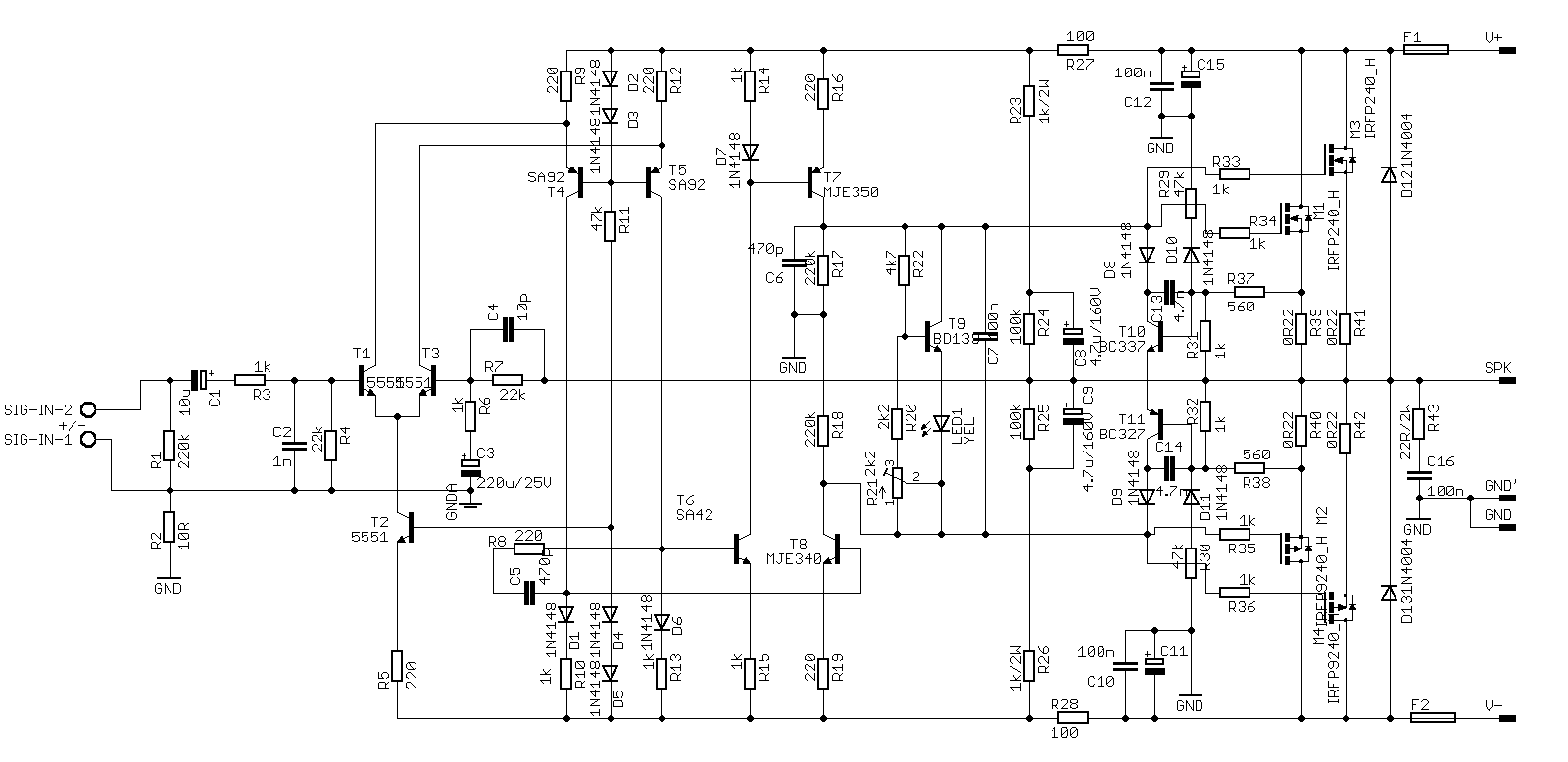

T6 base isn't connected to all the stuff.
Good catch!
The mistake is on the schematic, prasi look here.
Hi Keantoken, What "kean" eyes you have, great catch🙂. Thanks. Yes, as Thimios pointed, it was a mistake on sch.
So two jumpers later, here is the revised layout.

This is a much better layout.
The loop areas of the power inputs to the power returns and the speaker output to the speaker return are very much smaller than the old post2181
Thanks Andrew,
That was one of the considerations for revised layout + to have more spacing between o/p devices + to have decoupling closer to mosfets.
