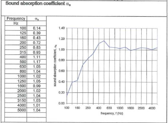

Part of the issue is that standard acoustic measurements tend to want to measure only around 250Hz or more. Not sure why, but I think that's historical.
Best,
Erik
I actually found measurements! Also, there IS a GIK Europe. Check these out. Most acoustic panels are shifted to the right on this chart. Having something that absorbs well at 80Hz is a wonderful thing.

Dimebucker you should try to simulate your basstraps using the second link i gave in the previous post (acousticmodelling.com).
It's simple you just use the porous absorber calculator en you enter the thickness of material used (don't change anything else it'll just give you an idea for the same you have build but with some rockwool instead of glasswool).edit: If you want to simulate your's change the flow resistivty to 5000.
Once you have the graph go back in the thread and compare versus the data provided by Erik, you'll see why you've got different results.

I fully agree Wesayso, but i think that what happened here is that once you've got tools you start to make measurements and once you start and you had already build something that could have fix issues you think where there and you collect data showing not really... 😉
Dimebucker: for what i've simulated your already build 'basstrap' are quite effective sidewall treatments to lessen first reflexions! (from my sim they have nearly the same response as Erik's wall treatments). And if you can do some 'ray tracing' and angle them the correct way, you could achieve some kind of RFZ. 😉
