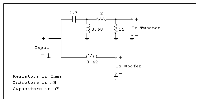

thanks for that info, i originally shyed away from TL's due to the extra work, ill give them a look though, cabinet design is not a problem for me, it is the crossover......

Im currently working on the cabinet dims for the FB1. I have the external dims which can be downloaded from the pmc website. Ive managed to cut and paste the 'cut away' image of the FB1 (showing the TL and damping) onto the drawing with the external dims. Now all I need to do is find out what thickness the panels are and I'll be able to work out the rest of the dims. (A freind is a CAD expert so he will help me here) Does anyone know the cabinet wall thickness? (below is an example based on the OB1)
Next question is of course on the xo. Ive been searching and searching for a schematic of some sort but nothing yet. Ideally I'd like the latest 'i' version but the '+' would suffice. Anyone here own FB1's or know the xo setup?
