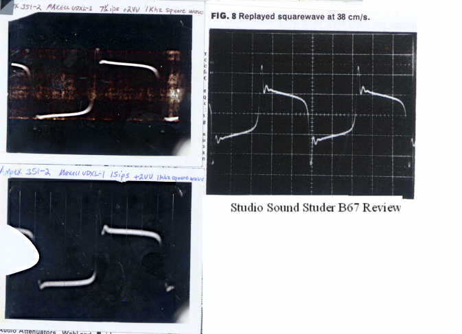

record/playback square wave photos
I found a couple scope photos I took back when I prototyped the phase correction circuit for a recorded and played back signal. At the time, I always had it set for one compensation which I dialed in at 7.5 ips, so it didn't do quite as good a job at 15 ips, but I plan to have individual compensations for each speed in the new version.
For comparison, I show the 15 ips record/playback square wave response of the Studer B67 as reviewed by Studio Sound when it was a new product. It can be seen how much less leading edge overshoot there is and much less horizontal section tilt to the square wave with the phase compensation in (to be fair, I did something at the low end also that helped the latter).
