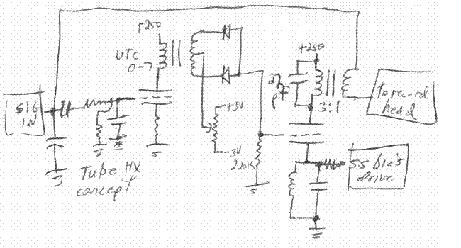

I re-simulated my playback phase correction circuit since I realized a better way to select values.
One thing that is cool about this circuit is that you can create an RC network *second-order* all pass phase correction with a single triode section that only passes the HF content to be corrected. You can even throw in a couple db HF eq for low tape speeds, if desired. Everything else at lower frequencies is summed through a separate resistor - this is about as close as one can get to non-sonic signature signal processing and this topology is suitable for the input to the following stage in the same tube bulb which will have the peak unlimiting. Component sensitivity ought to be low enough with this topology to allow it to be used without special gain trimming.
When you don't want to use a shipload of ICs, you need to make fewer tubes do more. Btw, I never saw any reference to such a circuit which is reasonably understandable because most people don't consider phase correcting LP or tape response to the HF limit - I worked it out myself and proved its efficacy by prototyping.
