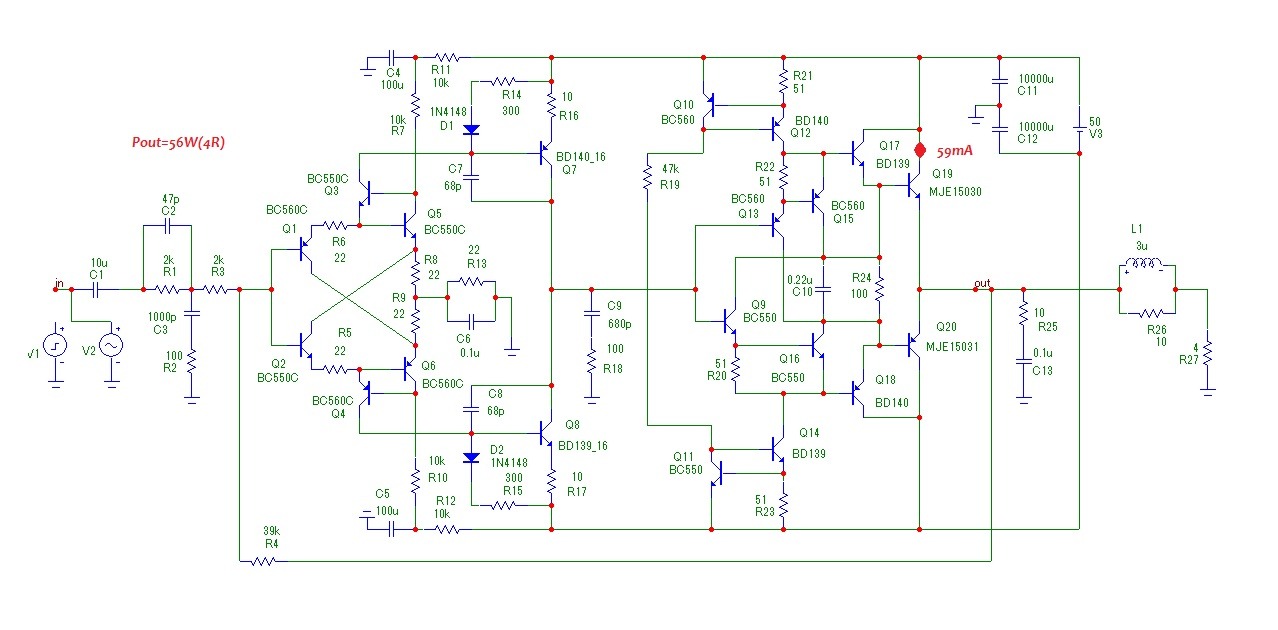

slightly upgrade the circuit:
* The output stage is a structure of low-, medium- and high-power transistors , the initial current is 59 mA, which weakly depends on the supply voltage, the output stage is thermally stable with a negative gradient.
in this configuration of the output stage it was possible to obtain +6 watts more power, i.e. the output power is already 56 watts at a 4 ohm load.
*The input stage, with the addition of the R13C6 RC circuit, received an open loop gain of 96 dB. However, the configuration of the input stage has significant nonlinearity. Therefore, despite the fact that the voltage amplifier is a two-stage structure and relatively deep negative feedback, for high-quality and pleasant-to-hear sound you will have to look for another solution, because It is not possible to correct the nonlinearity of the input pairs of transistors of the voltage amplifier.
We'll keep thinking....

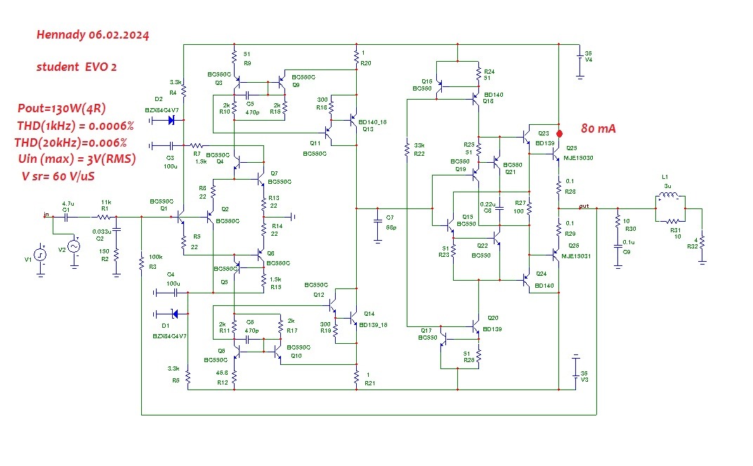

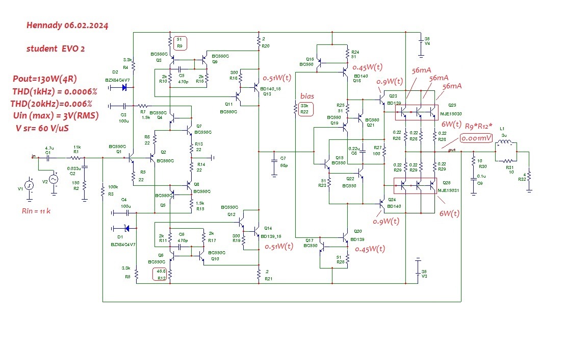

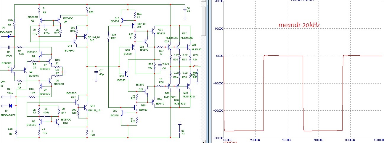

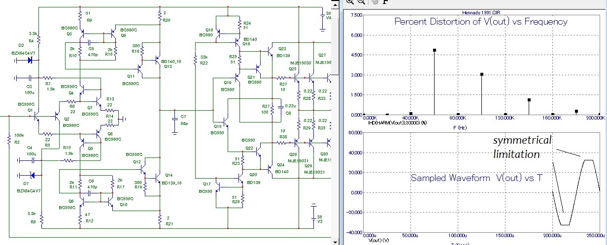

Please:
*bipolar power supply +/-36 volts, no servo required.
*0.1 Ohm resistors in the emitters of the output transistors, initial current 80 mA
*a converted voltage amplifier, which has a high overload capacity, i.e. at the input voltage is permissible up to 4 volts amplitude, i.e. like a tube cascade.
*as a result, the output power before the sine wave limitation increased to a crazy 130 watts at a 4 Ohm load with a power supply of +/-36 volts
  • input stages are linear until covered by negative feedback,
  • open loop gain is 80dB, pole 1kHz
  • unity gain frequency 10 MHz
  • progressive correction
  • Slew rate 60 V/µs
Despite the apparent complexity of the structure, the amplifier retains 2 amplification stages with maximum linearity of the frequency response until covered by Negative feedback and high overload capacity.
