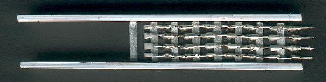

After swapping parts, fitting Blackgates BG-N 33u, and exchanging the lt1085 for a 317, I still had the same problem...:dead:
Then I had to do what I didn't want to do: desoldering the DacTower with the 8 pieces of TDA 1543...😡
Then I put in one TDA without heatsink. For the first time I could hear undistorted sound coming from the dac...🙄
The sound I heard was indeed lively in the midrange. The bass was somewhat lacking in dynamics. The treble however was harsh and undetailed. Not smooth at all, and without any sophistication...:smash:
Compared to my already heavily modified Philips DVD 963 SACD this sound wasn't very promising...:xeye:
I must add however that only ONE TDA was running at its nominal 5 Volt (because of lack of heatsinking), that there hasn't been any break in period, and that the output caps were not a Blackgate N in super-e configuration like it is in the DVD 963 SA.
So maybe it will all improve dramatically. :clown:
Now I must consider building a new DacTower, or start a new pcb with 8 pieces of TDA sitting in a rectangular shape with a heatsink on top of them. We'll see...😀

First flight...
I had ordered some new TDA 1543 chips, so I finally decided to build a new Dac-tower...
And indeed, it had been the old DAC-Tower that prevented this Doede Dac to work from the start. Maybe one of the TDAs has been faulty:cannotbe:
For the first time I could hear this design with 8 paralell TDAs.
