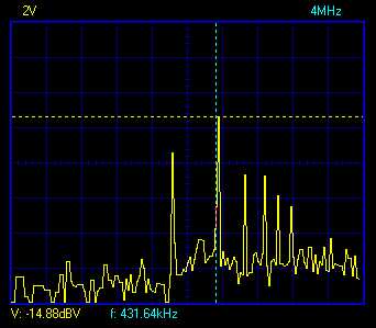

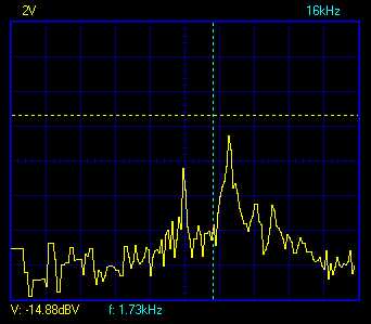

OK, I think I found the problem. It is 100% the LT1085....
When it starts cold, there is oscilation which can be heard as hard noise. In my DAC at home after a minute or so it is gone, I thought it was the DAC biasing and did not cared too much, as every thing worked fine after warm up. My tube amps have to warm up also, eh?
BUT, it might be, that in some other (critical) situations, the 1085 does NOT STOP making noise !!!
I have just measured it and just check the scope pictures....
Please do note the difference in scale !! When the warm up is done, the rest-noise is at an average of -90dB. This is ok enough, although I am sure some will diasagree, 🙄
The cold pictures show clear hard stuff !!!-15dB is not particulary a good noise floor level 😉
ANYWAY: try a larger C at the output of the 1085 or take a LM317.....
Will make notes at the WEB Site as well....

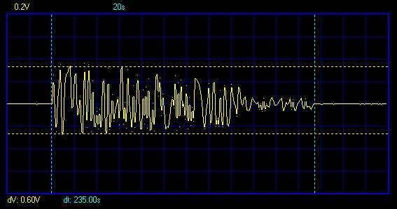

OK, last image on this issue..........
This is a time recorder of the output of the 1085.
After switch-on the oscillations start at aprox 0,6 Volt (!)
As time goes by, the oscillations start to decreas and suddenly disapear after aprox 235 Seconds.....
OK, 4 minutes warm up, never realized it is that much
for easy to copy DIY-stuff I may be had better not mentioned the 1085 as an "alternative" for the LM317, which is clearly more stable!
doede

I could not stop 😉
So close........., so I did some more checking. I tried a few capacitor values at the output and every thing above 40uF stopped the noises at cold start !!!
My suggestion: Increase the Value of the output C to 47uF - 100uF when a LT1085 is used..........
This can be done emperical of course as you can hear it, no need for scope 😀
I am glad as well, as now I have no "warm-up" time any more of 4 minutes.... hahaha !!
