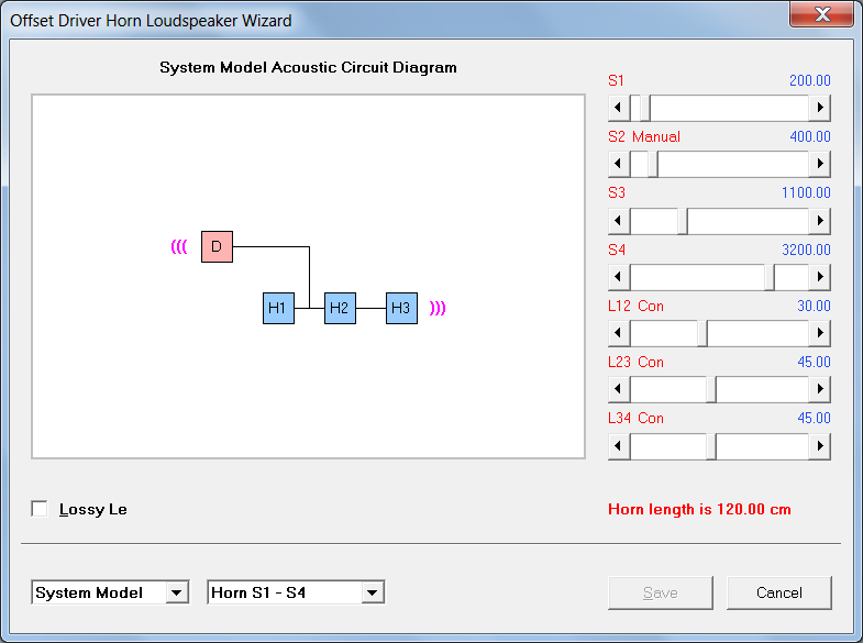

Attachment 1 shows an offset driver horn. The horn has three segments (H1, H2 and H3) and an offset driver (D). The throat of the horn is closed.

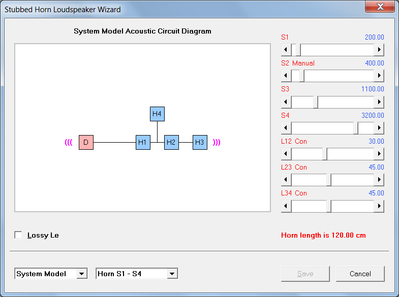

Attachment 2 shows a stubbed horn. The horn has three segments (H1, H2 and H3) and an offset stub H4. The mouth of the stub is closed. The driver (D) is not offset.
Try Googling 'transmission line stub' instead.

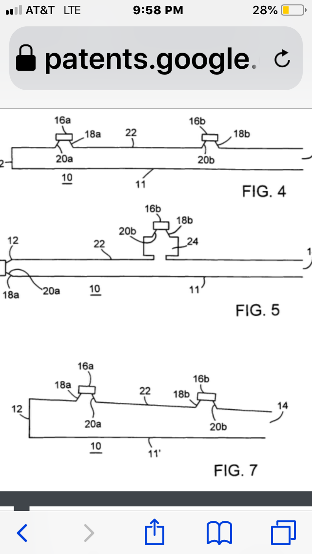

Did I understand it right that a stubbed horn is an FLH with a quarter wave transmission line(stub) attached somewhere down the length of the horn?
What is the engineering purpose of such a stub?

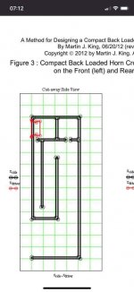

ask Martin King if you dont find me helpful. He can explain, if you get lucky and dont **** his ego off trying to ask him. in other words, try it yourself and see, then take it to him. Prepare to be removed from his facebook page though...
He wants that to be his next moment or idea to show us all how we are dumber than him.. unfortunately, he didnt realize we were already figuring it out while he calmed down from whatever happened to him 10(?) years ago?? I dunno, but the man is bitter sweet. i owe him a lot for all the learning he gave me and he can pretend only he knows it or appreciates it no matter what i try and show him as a result of that(and anyone else has too) ... a gift he cant even appreciate the rewards of. we are all just harmonics to him... he is the fundamental. and he doesnt even like qw, he mass loads it, lol!!!

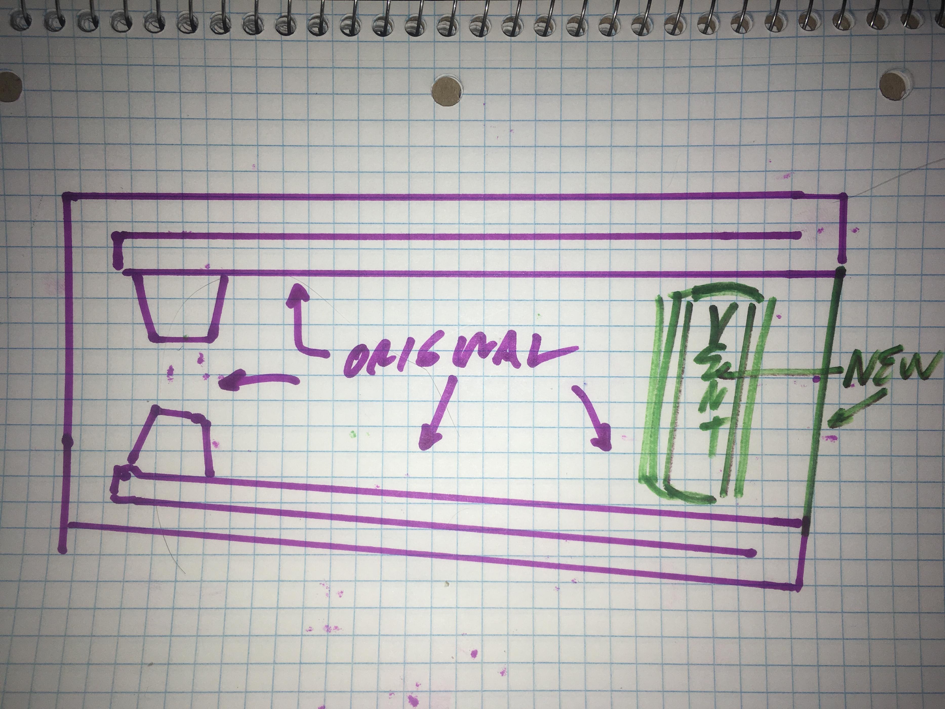

The vent is another one. 😉
Note that driver, vents ideally need to be at an acoustic odd harmonic, so more to choose from depending on the desired performance.
GM
I havent ‘mastered’ this one ‘yet’. But ill be darn if it isnt an absolutely wonderful thing in a ‘Regular ‘TL’. so much so that i am Trying to find the sweet spot in higher order versions (pic): Its there, i cant quite figure it out though. Hard to bolt on various ‘windows’ to decifer whats changed for what reason.
