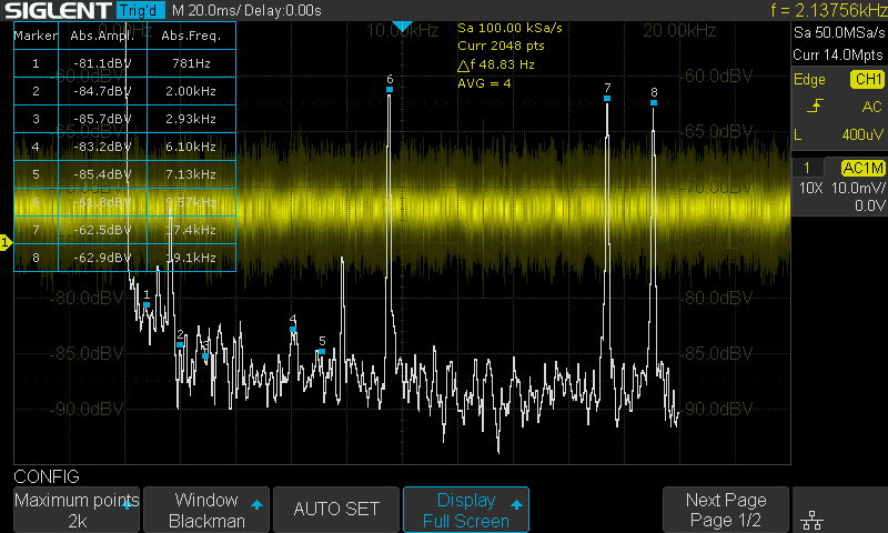

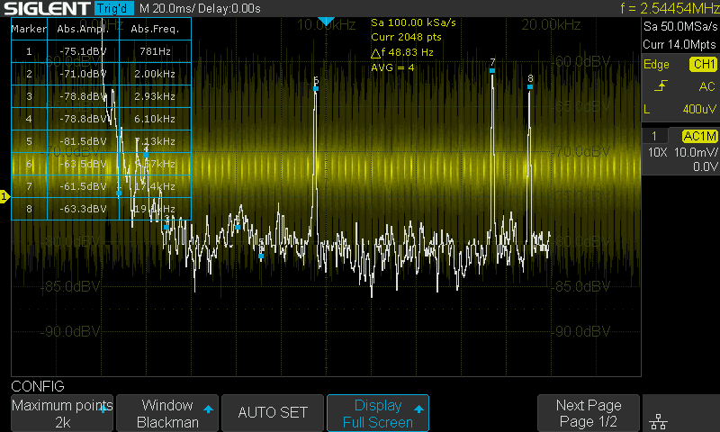

As I have said before I would use lab supply for MCU+mic and Mean Well only for LEDs with 0V from both tied together. If the LEDs don't work properly that way there is something else that is wrong.meanwell power supply
USB soundcard can be yet another cause for ground noise. Do you see the noise with scope?with the soundcard

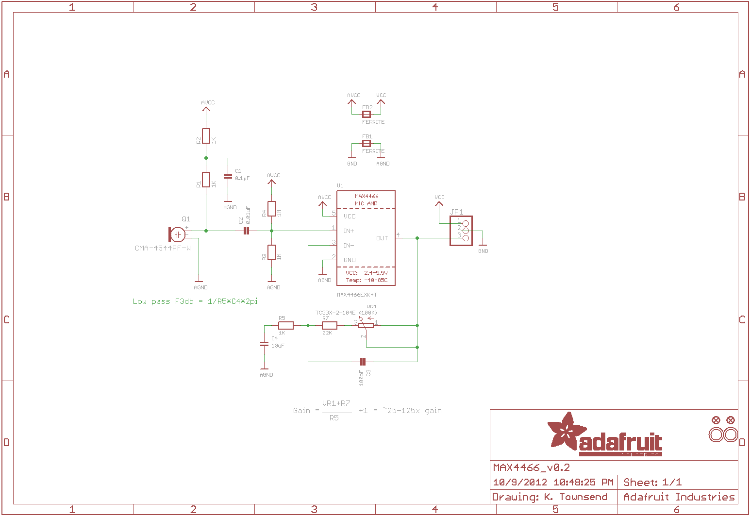

https://github.com/adafruit/Adafruit-MAX4466-Electret-Mic-Amplifier-PCBs
PCB files for Adafruit MAX4466 Electret Mic Amplifier. The format is EagleCAD schematic and board layout
I tried to read it in in an antique version of Eagle that I have somewhere on my computer, but that only led to an error message. Fortunately they have it in a more generic format on https://learn.adafruit.com/adafruit-microphone-amplifier-breakout/downloads I think the creative commons license (see your github link) allows me to share it here, so here you go:
Connecting a 100 uF electrolytic capacitor in parallel with C1 and a 100 nF capacitor in parallel with C2 should make this circuit far less sensitive to ripple on its supply. There is no need to replace the the resistor that supplies the microphone capsule with two resistors in series, as it's already two in series.

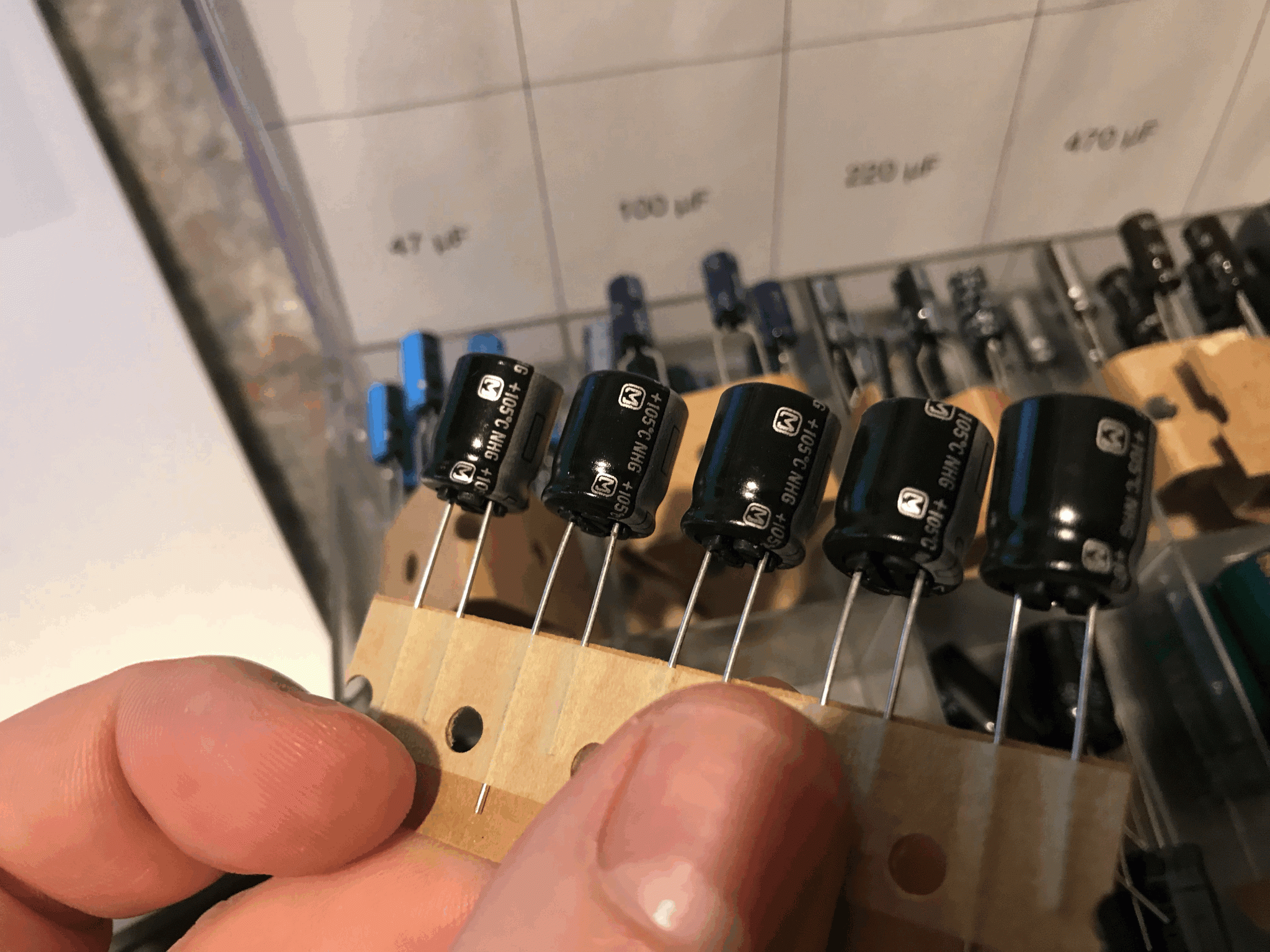

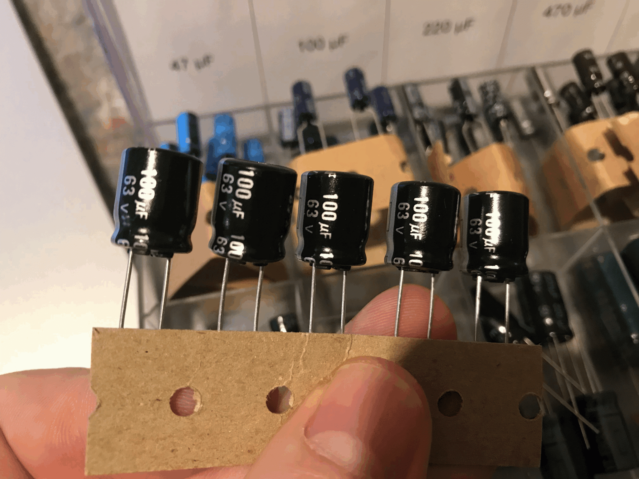

can i use these caps?i dont have good caps.
i have 16V elkos also. but what is better?
Yes, you can.

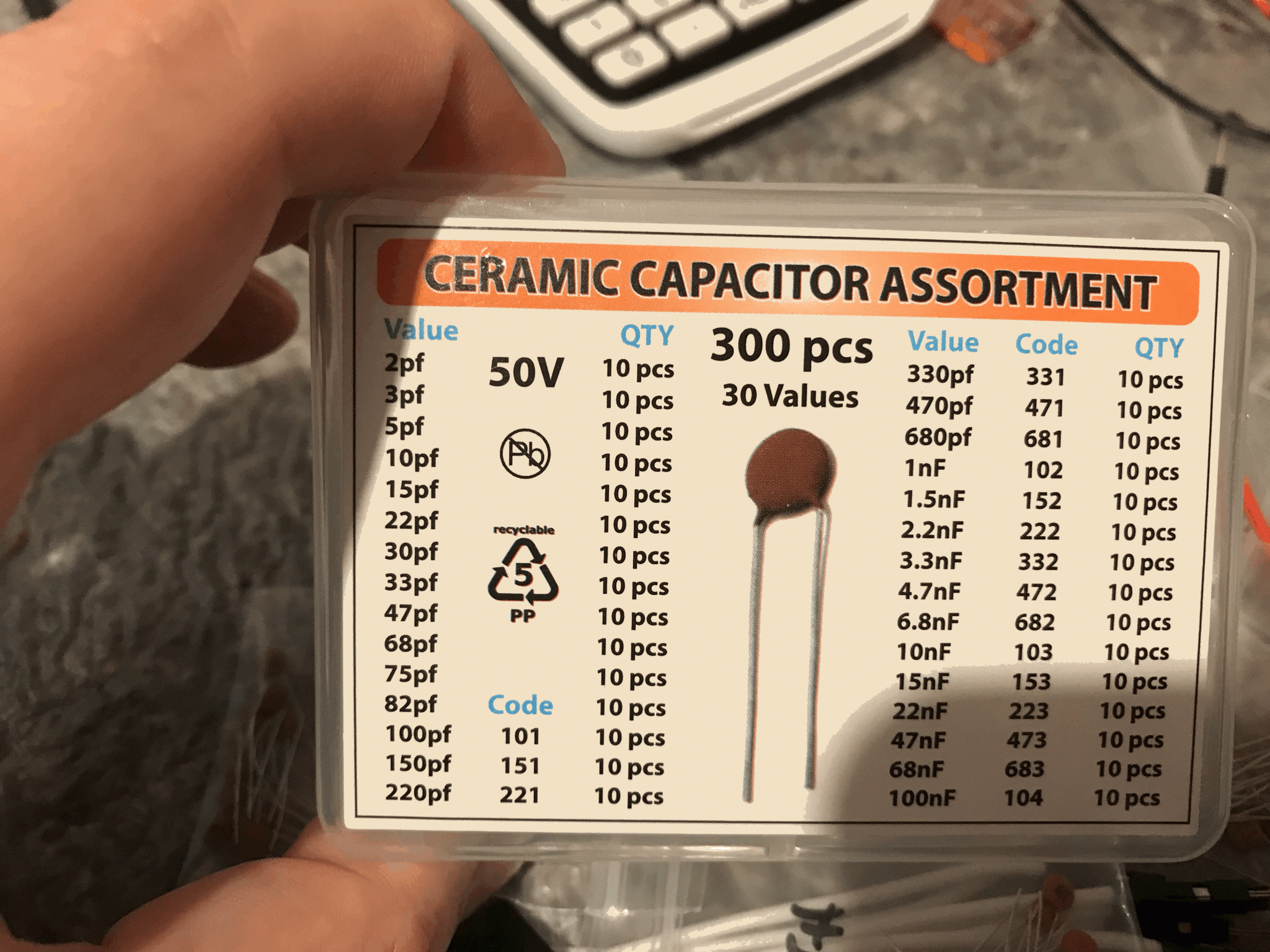

I could write a long story about class 1 and class 2 ceramic capacitors now, but the signal voltage across the coupling capacitor will be so many orders of magnitude below the ceramic capacitor's voltage rating that it will work fine no matter what class it is.
For the electrolytic capacitor, I'd check which fits on the PCB best, the 16 V or the 63 V part. If it makes no difference, use the 63 V part, as those usually have a slightly lower effective series resistance.

Damn. Long story short tale. The microphone is broken. Somehow I must have shorted it out. I have ordered new ones. But I don't have one now.
I have another question. How do I get the noise to not go from one microcontroller to the other?
I have 2 microcontrollers running now with different power supplies. And they have no direct connection to each other except the 230V phase and neutral.

Hi XerXes777,
I don't remember the details of this thread, but I think you had a crosstalk issue from a microcontroller to a microphone/microphone preamplifier board, and there was some reason to believe it might partly or completely couple via the supply.
The circuit shown in https://www.diyaudio.com/community/attachments/1166552/ uses a low-pass filter consisting of R2 and C1 to suppress interference on the supply, but it can be made more effective at low frequencies by using a much bigger capacitor. Unfortunately C2 and R4 then limit the efficacy, which can be solved by also increasing C2.
Marcel
Marcel
It seems not to affect the performance at all, the voltage noise density plot is clean up to 1MHz or more - I suspect its freq much higher than that and is billed as low noise charge pump - however it probably means decoupling advice is mandatory.According to chapter 7 of its datasheet, see https://www.ti.com/product/OPA322 , the OPA322 uses a charge pump for its input stage. If the charge pump switching frequency ends up at the ADC input, it might alias to an audio frequency.
