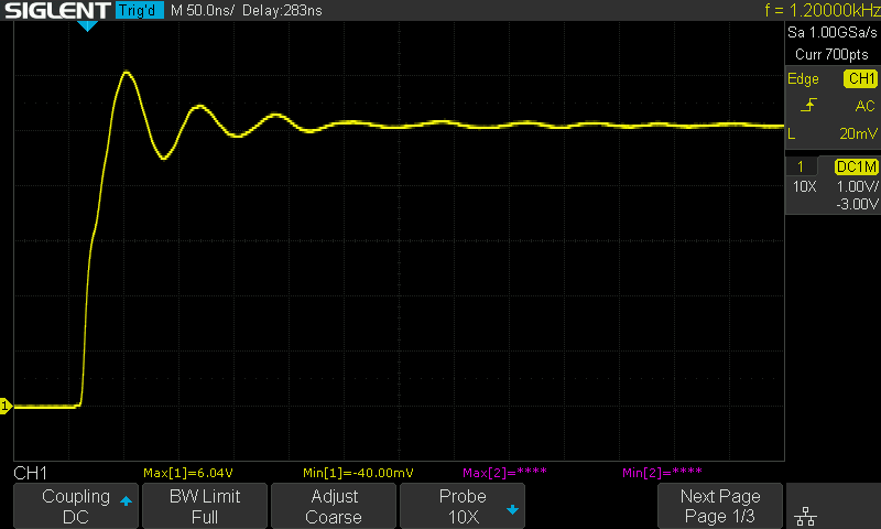

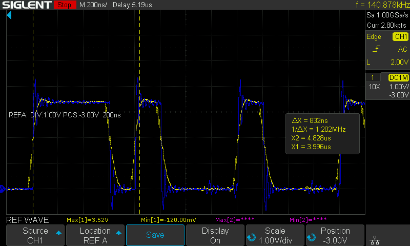

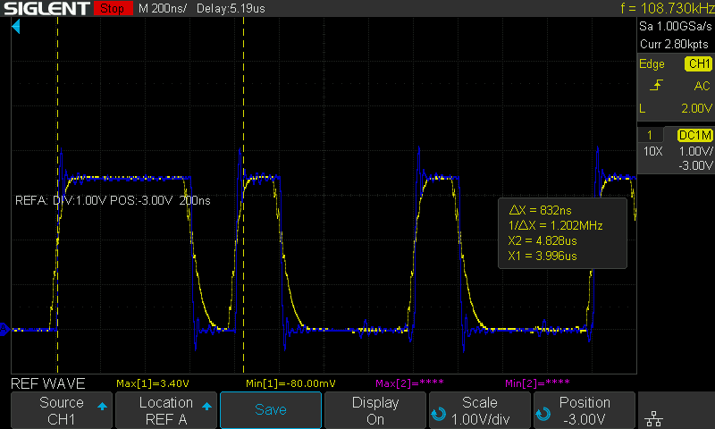

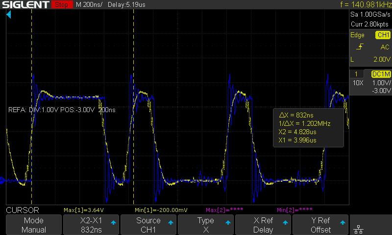

Here is a picture to show the SPI_0 direct comes out from the microcontroller.
Blue is without a cap.
yellow is with a ceramic cap and the GPIO port current is limited.
i played with different sizes.
what do you say?
what do you say?
If you are worried about the overshoot my recommendation is to use series termination resistors.
This covers common termination techniques for transmission lines:
https://www.ti.com/lit/an/scaa045a/scaa045a.pdf

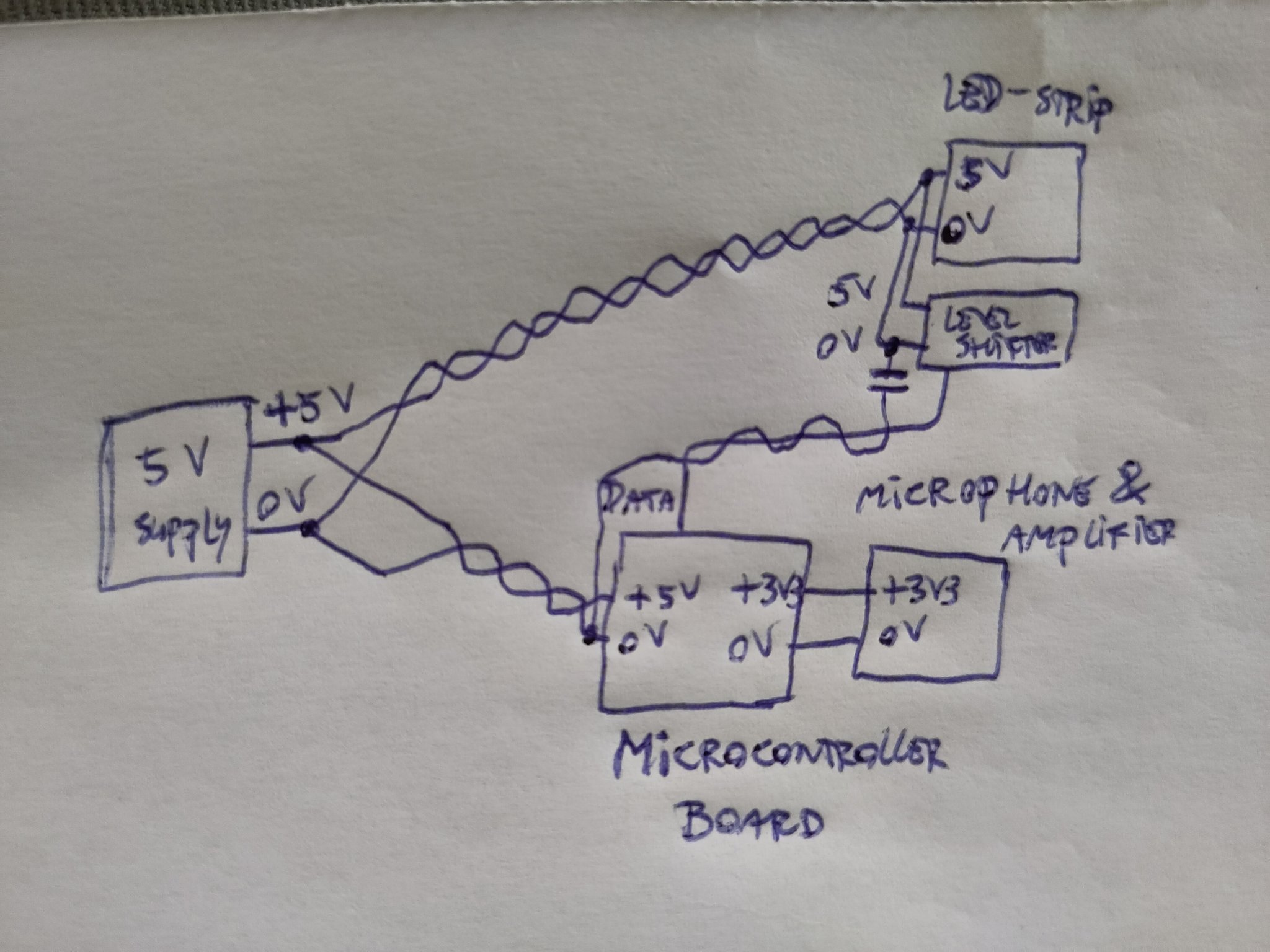

Assuming the crosstalk comes from the LED strip's ground current, this would be one way to lay the wiring out. Star connection at the supply to minimize the mutual impedance, twisting to avoid magnetic coupling as much as possible, capacitor reduces efficacy of the star connection, but provides a return path for the data signal close to the data wire. Value of the capacitor to be determined experimentally, you could try 0, 1 nF and 100 nF to get an idea what works best.

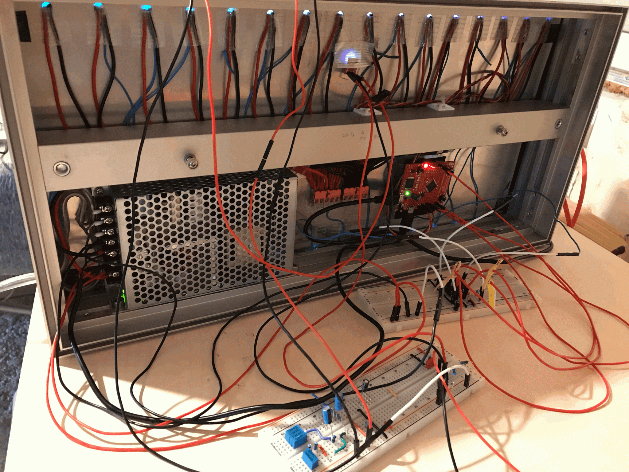

I have just noticed that. Meanwell power supply is connected to the strips and to the microcontroller. The microphone is connected to the lab power supply and the microphone is connected to my usb sound card. this is enough to turn on the meanwell power supply and send led data. only when sending, there is again a strong noise on the mic. what is happening? i don't understand it.So is this the situation?

could be difficult. see my picture. please dont fire me...twisting to avoid magnetic coupling
i did it. see my pdf.Value of the capacitor to be determined experimentally, you could try 0, 1 nF and 100 nF to get an idea what works best.
