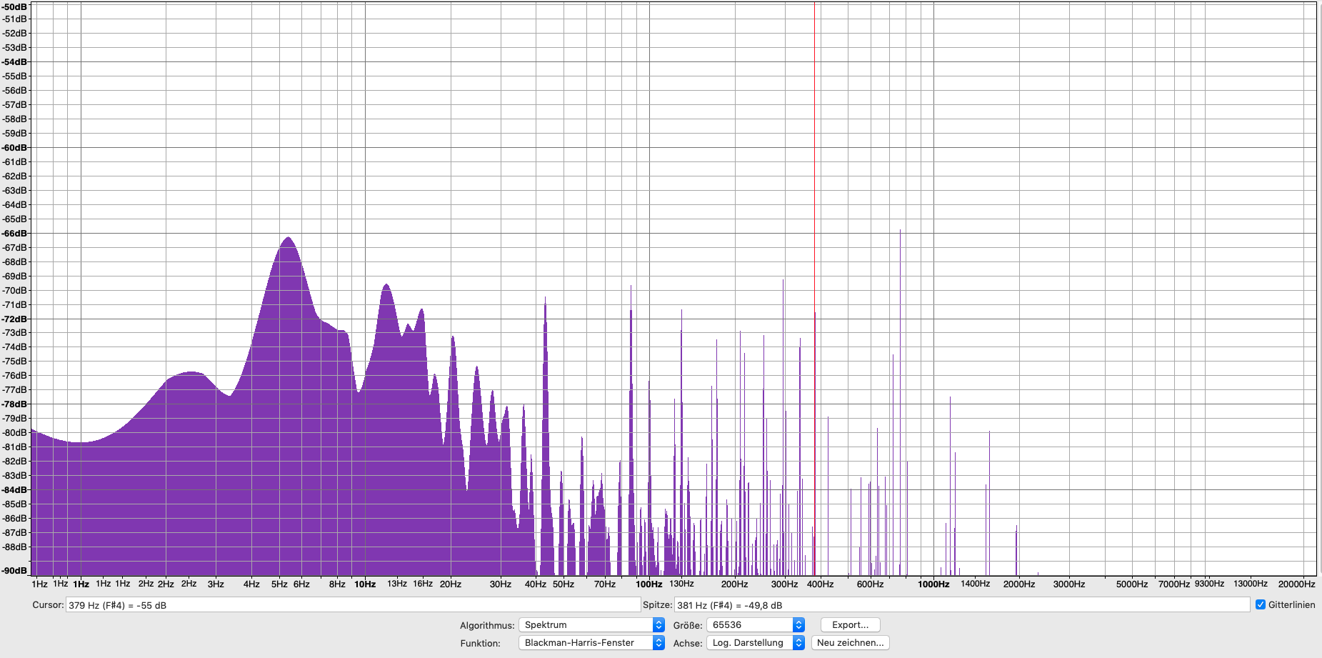

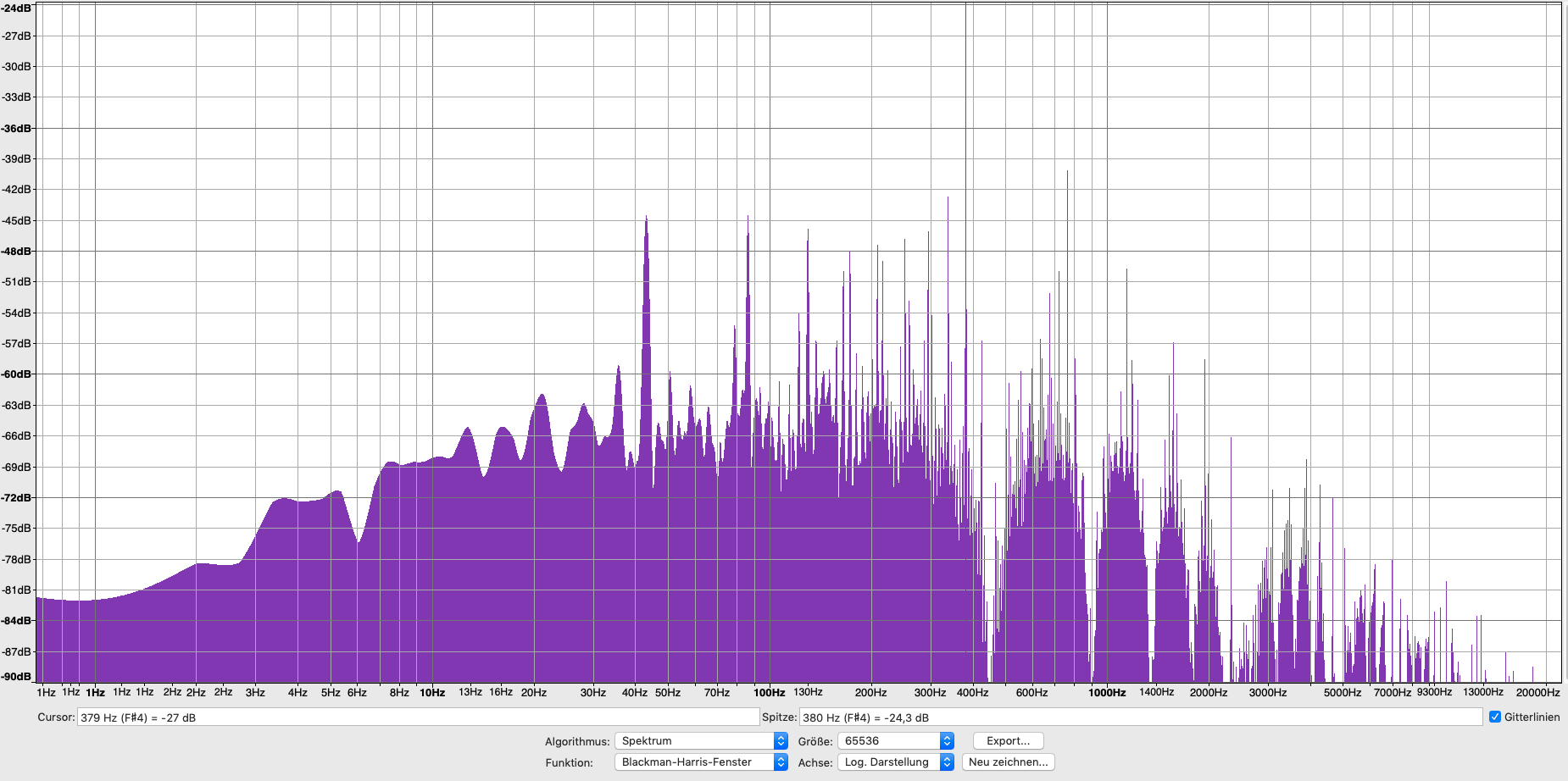

I have made 2 recordings with the same microphone once with the
power supply from the lab power supply 3.3V. There the noise is
clearly smaller. And once after a 230V / 5V power supply for the
microcontroller and from the microcontroller the 3.3V. And there I have almost
30dB more noise on it.
How do I get the noise reduced?

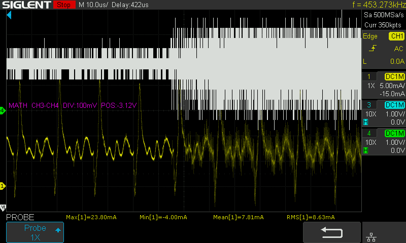

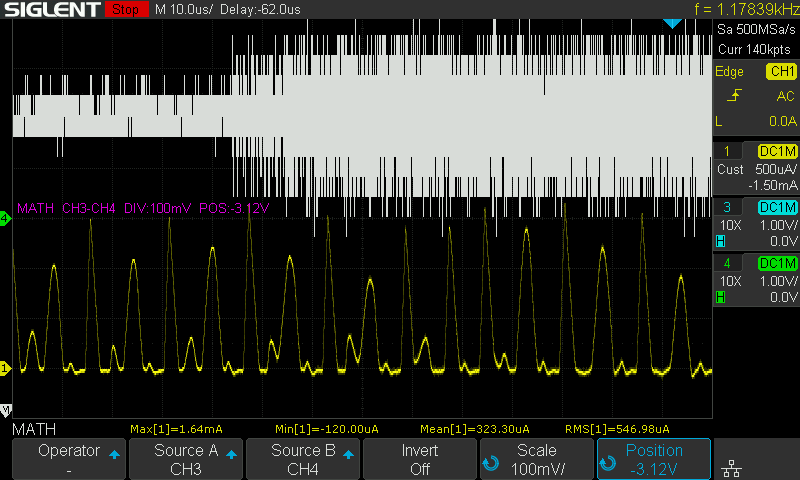

I take some measurements with my low current measurement tool and my oscilloscpe.
Here are the pictures:
voltage and current messureing between mic with soundcard:
voltage and current messureing between mic without soundcard:
and i find out that when i connect my usb soundcard (behringer uca202) to the mic. that the current is increasing.
from 300microA rms to 8mA rms.
i only connect the mic to the soundcard to find an error. i can evaluate the mic with the mikrocontroler. but i can only get to the sample values in a very complicated way.
the white signal is the voltage 3.3V and you can see sometimes it will be noisy.
i am not sure yet how to improve this. unfortunately i do not know what brute force filtering is.

I just meant a cascade of a couple of low-pass filter sections, like the LC section and two RC sections between the 5 V supply and the microphone in the example I gave.

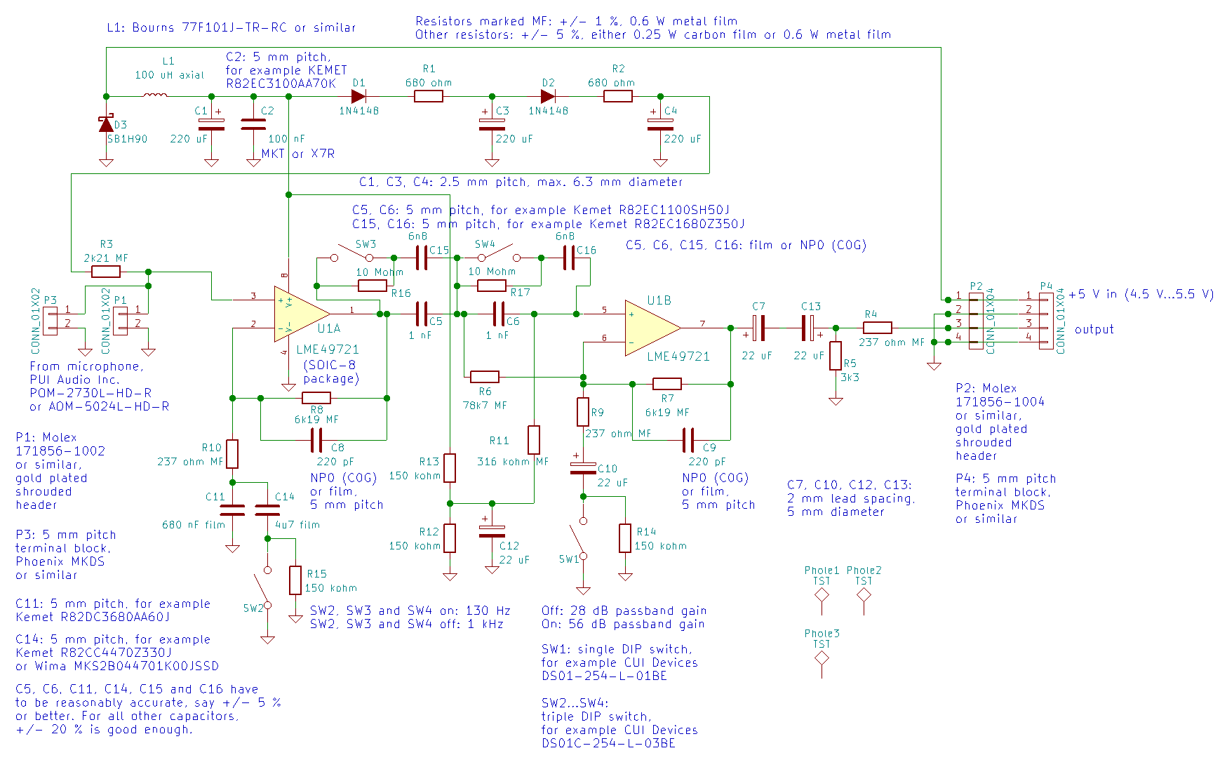

Can you imagine helping me to redesign it electrically? The electronic part is not so strong with me ;-)
I tried to start with it and made a sketch.
I will upload this as a PDF.

Some remarks and a question:
C3 is a bit small for R1 = 2.6 kohm. They form a high-pass filter with corner frequency 1/(2 π R1 C3).
R1 can best be thin film because of 1/f noise.
Resistors and capacitors normally have certain standard values, see https://en.m.wikipedia.org/wiki/E_series_of_preferred_numbers . The availability of capacitors with E6 and E12 values is much better than with E24 values (E24 values that are not E12, that is). E96 capacitors are very rare. E96 resistors are no problem, although they may be slightly more expensive than E12 and E24. I've never seen E192 resistors.u
What ADC sample rate do you use? Unless it is very high, you can best use a relatively large value for C2, as it is your only anti-aliasing filter besides microphone roll-off. That is, choose a corner frequency above the audio band, but don't exaggerate.
As long as the RMS random noise is greater than about half an LSB, the noise dithers your ADC and you should be able to see spectral peaks far below 1 LSB - provided the interference issues are solved and the ADC behaves close to ideally.
Replace C5 with a short, because the ADC needs a DC bias at its input.
R6 can then be left out, although it may be a better idea to replace it with a capacitor. You then have some extra anti-aliasing filtering and you keep the ADC's sample current spikes out of the op-amp. It may or may not be advantageous to increase R4 then.
It may be advantageous to use slightly unequal values for R3 and R5 to bias the ADC not exactly in the middle of its range; ADCs usually have the biggest deviation from linearity at half scale, where all bits switch. By biasing it at a slightly different voltage, you avoid that for small input signals.
Gain switching could be done by switching the feedback network with an electronic switch, photoMOS relay or electromechanical relay. I don't know which models are suitable for 3.3 V.

According to chapter 7 of its datasheet, see https://www.ti.com/product/OPA322 , the OPA322 uses a charge pump for its input stage. If the charge pump switching frequency ends up at the ADC input, it might alias to an audio frequency.
