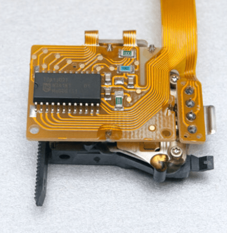

I did as I planned. First I took out the pickup. You have to take out the big white gearwheel using some force. To release the chrome rail you have to pull out the white clamp, The ending switch has not to be unscrewed but it's a chance to clean it as well.
To get into contacts on the pickup the metal shield has to be removed. It is soldered in two places. To take it out I used desoldering wick. After removal I saw preamplifier chip made by Philips with following description TZA1022 TS; V7247 01;Dn 602092. I resoldered all joints by applying some fluid flux and touching with soldering iron tip. My iron has ca. 220 degrees Celsius so it shouldn't damage the electronics. The chip connections are ultra small so I just crossed them with hot iron. Then I cleaned everything with alcohol and assembled back and put the VAM1250 into Marantz DR4050. It started playing immediately !

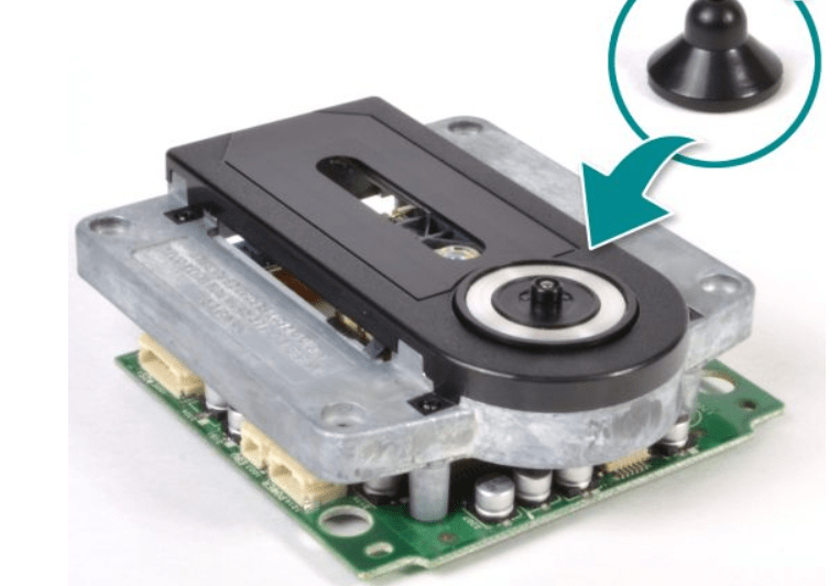

I have just purchased B&O Beocenter 2300 with Beolab 6000, but CD player seems to have issues with the laser, showing <> symbol when Play button is pressed, what indicates that the laser cannot read the disc. I have found an information that it is a matter of replacing 4 capacitors in CDM12.4 head board to make it working, but unfortunately the capacitors are not described on the PCB, so no way to decode their capacities.
How can I figure out which capacitors to use for replacement? I have checked CDM12.4's schematic, but capacitors have no values 🙁
Any help will be appreciated.
I've never heard of any caps failing on the CDM12.4 pickup. The older swing arm pickups were the ones that suffered with cap trouble (on the servo board).
Do you have a reference for this information you have?
Hmmm. I've worked on CDM12.4's from day one and never come across any caps issues on the head unit. In any case they are all SMD parts.
Are you sure they are not referring to caps on a board under the pickup such as an rf amp/servo/decoder
This is a CD12.4
If it looks more like this then small those small electrolytic caps on the main PCB (visible in this image) could be a failure item.

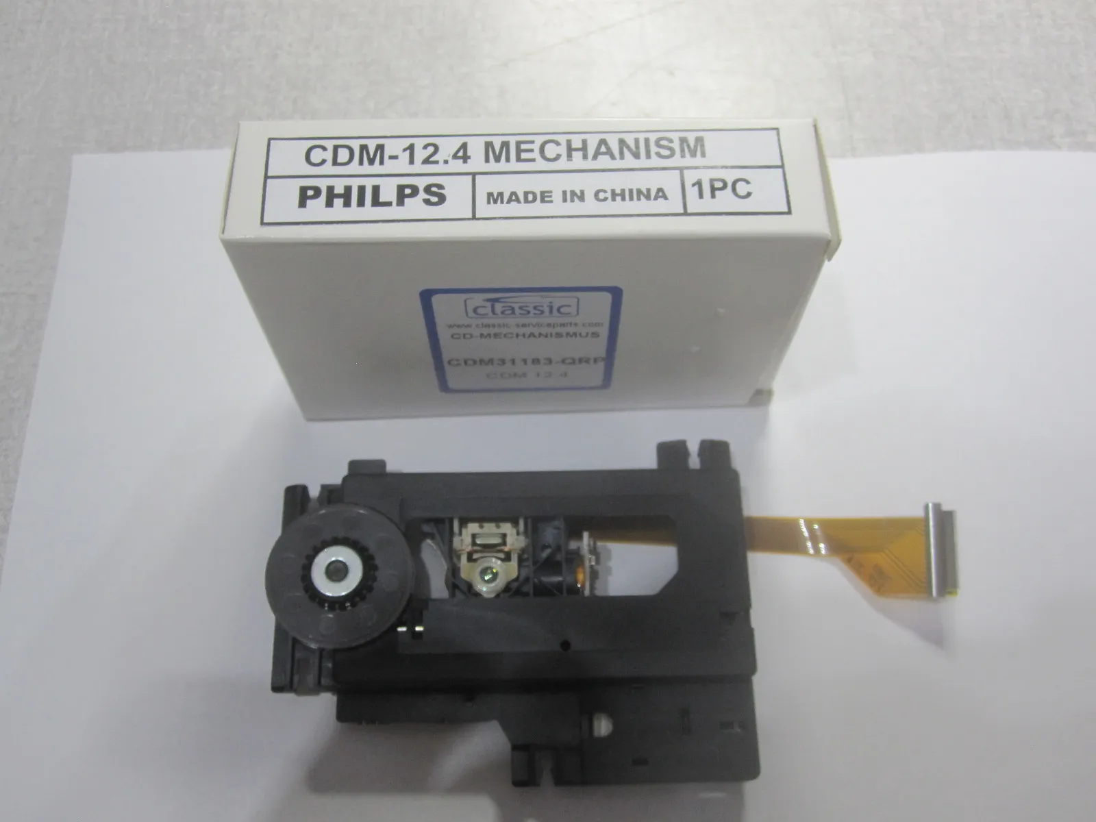

Nothing comes to mind beyond thinking there is some issue with the replacement. I'm assuming none of the assemblies available now are genuine Philips parts but are either copies or some other combination of reclaimed.
I know the CDM12.4 like I linked to in the image become a problem with the replacements being of poor quality.

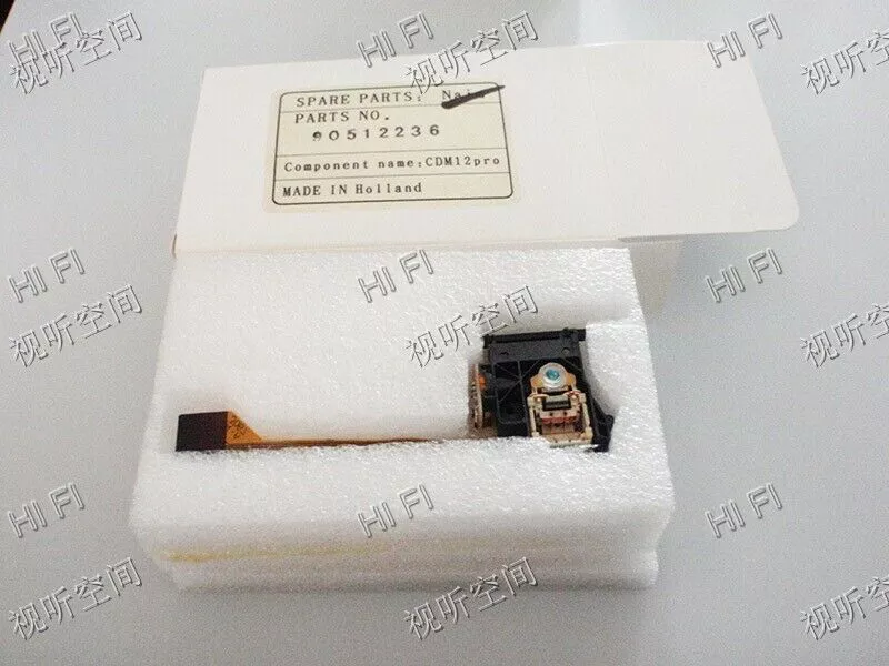

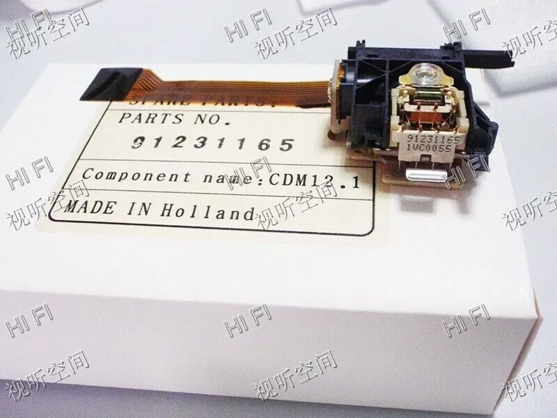

In the meantime I note exorbitant cost explosion on CDM12.4 laser heads, if there is a package with "Made in Holland"
https://www.ebay.com/itm/181222073022
https://www.ebay.com/itm/133360624251
most expensive is this offer with 842,61 €:
https://www.ebay.de/itm/387383683994
and
https://www.ebay.de/itm/166969486185
Concerning special features I don't understand this term:
"gold-plated quality socket"
There also CDM12.4 heads, where is to read "Made in Japan" -check out last posts under
