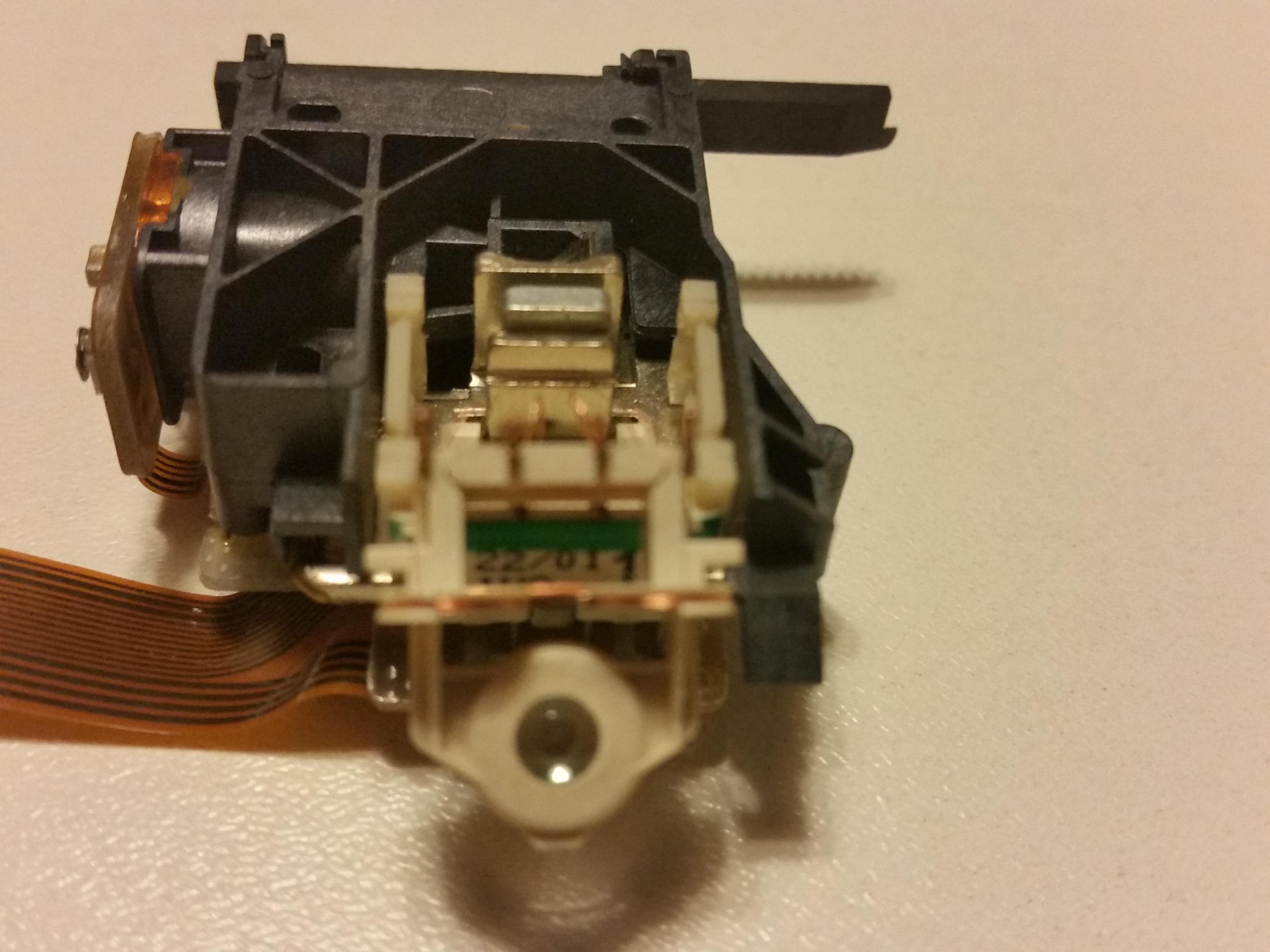

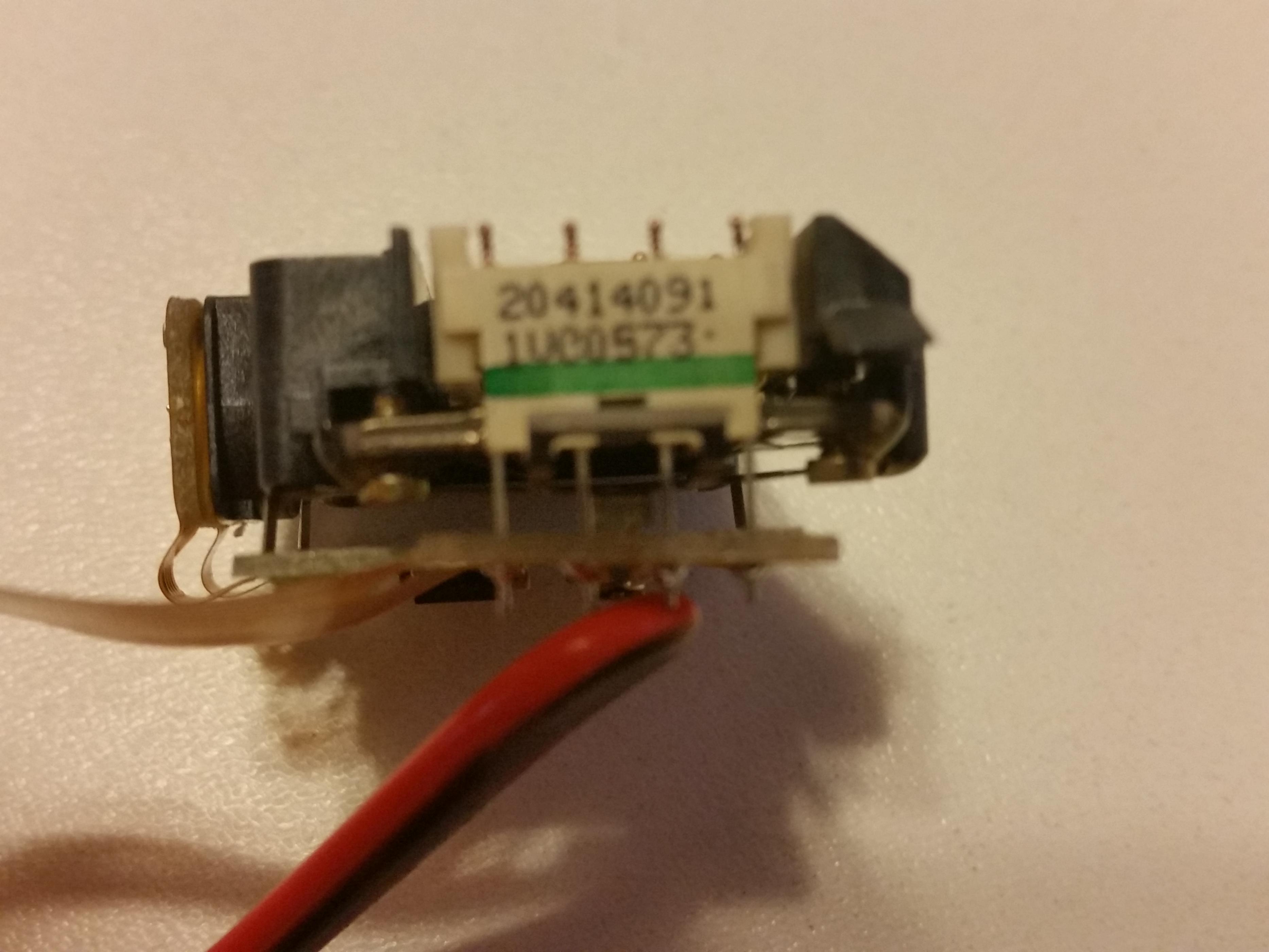

I did as I planned. First I took out the pickup. You have to take out the big white gearwheel using some force. To release the chrome rail you have to pull out the white clamp, The ending switch has not to be unscrewed but it's a chance to clean it as well.

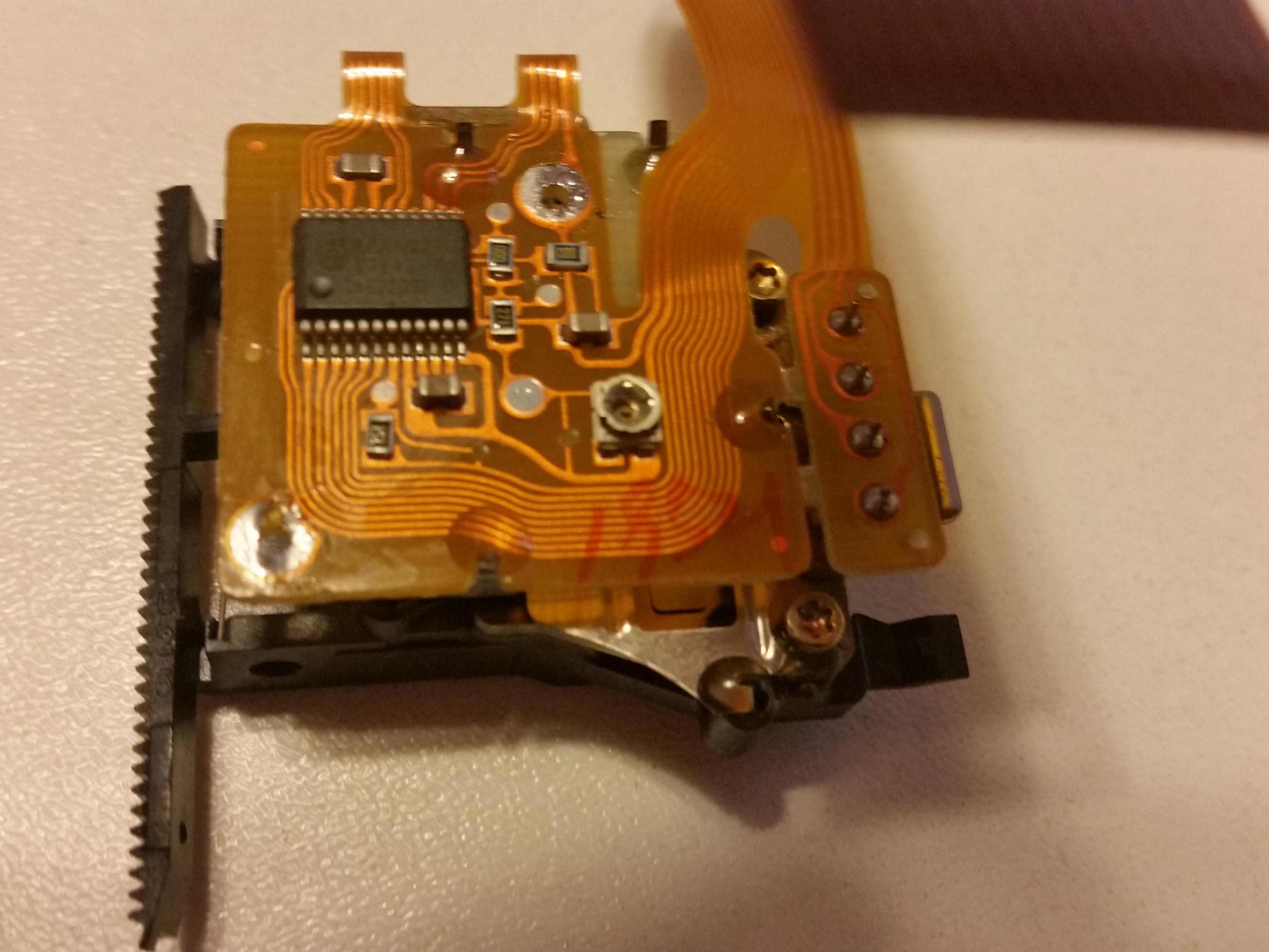

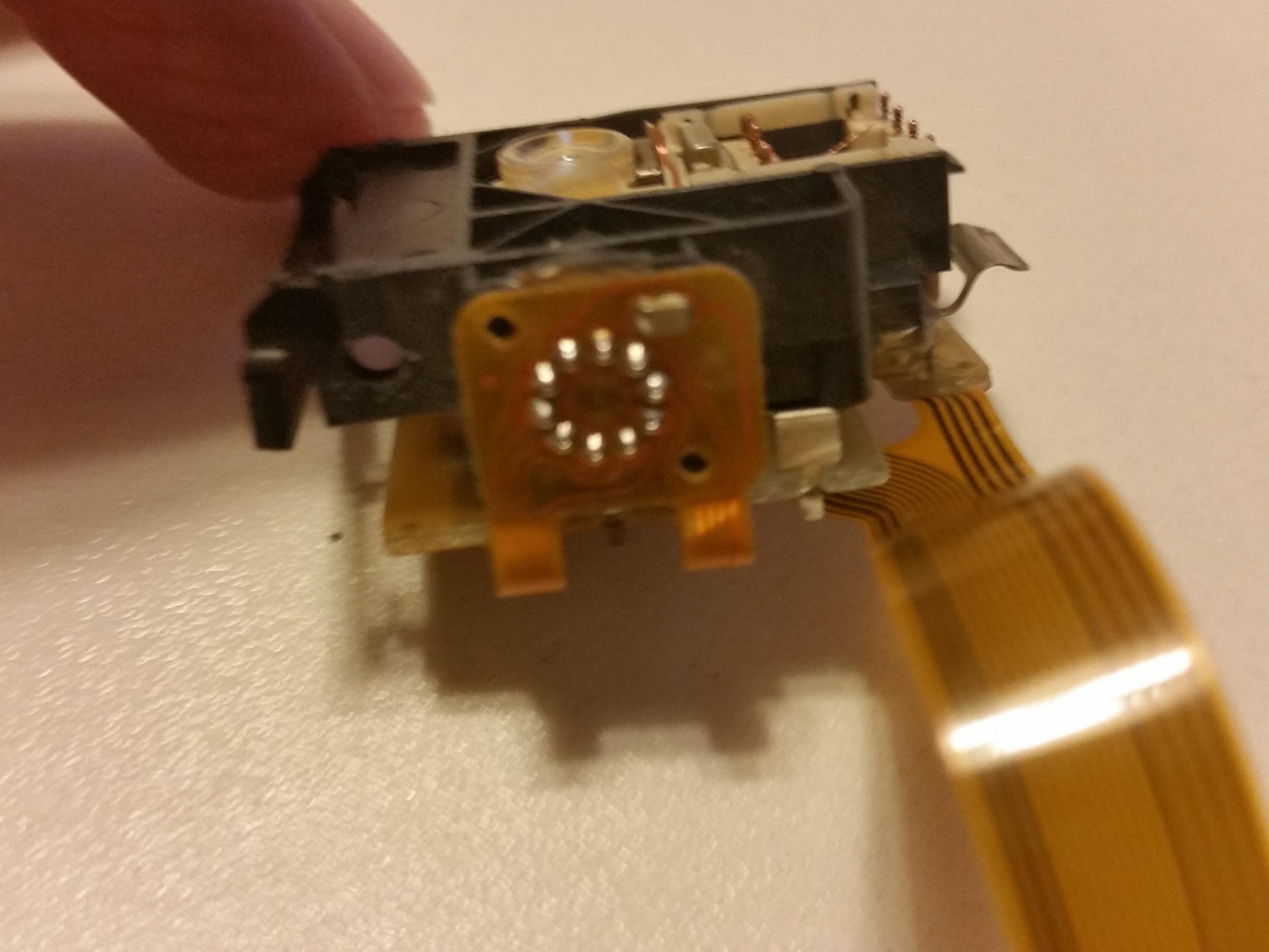

To get into contacts on the pickup the metal shield has to be removed. It is soldered in two places. To take it out I used desoldering wick. After removal I saw preamplifier chip made by Philips with following description TZA1022 TS; V7247 01;Dn 602092. I resoldered all joints by applying some fluid flux and touching with soldering iron tip. My iron has ca. 220 degrees Celsius so it shouldn't damage the electronics. The chip connections are ultra small so I just crossed them with hot iron. Then I cleaned everything with alcohol and assembled back and put the VAM1250 into Marantz DR4050. It started playing immediately !
I have general question: it is not written on a pickup that it is VAM 1250. In my pickup the description is 1VC0573 does it mean anything ? How do you know having just a pickup to what VAM or CDM it belongs to ? Just from description on a box ?

As far as I know the only way to reliably tell what you have is from the description/code on the box. The other number seems to relate just to the lens and its holder, or possibly some in house production code.

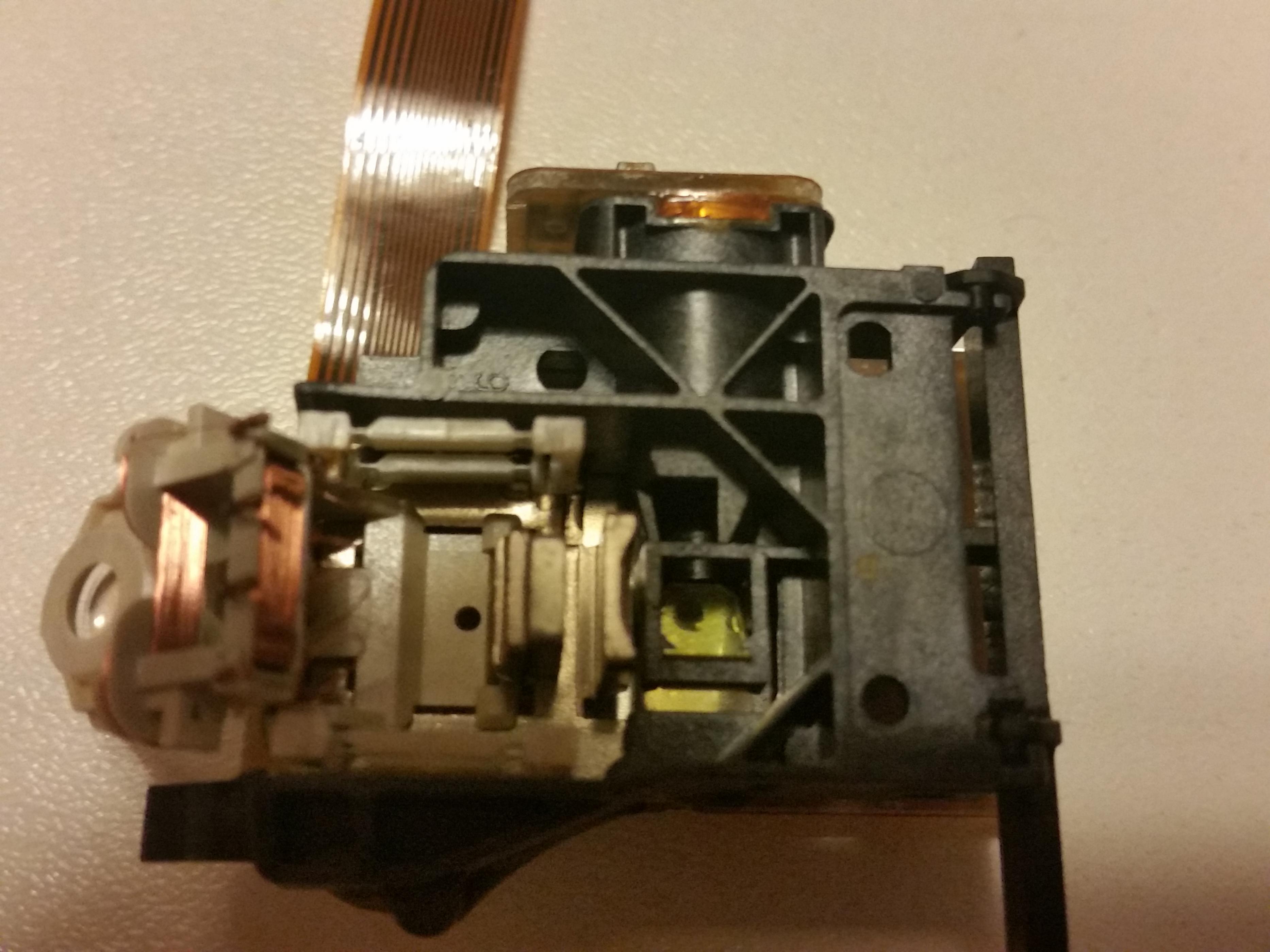

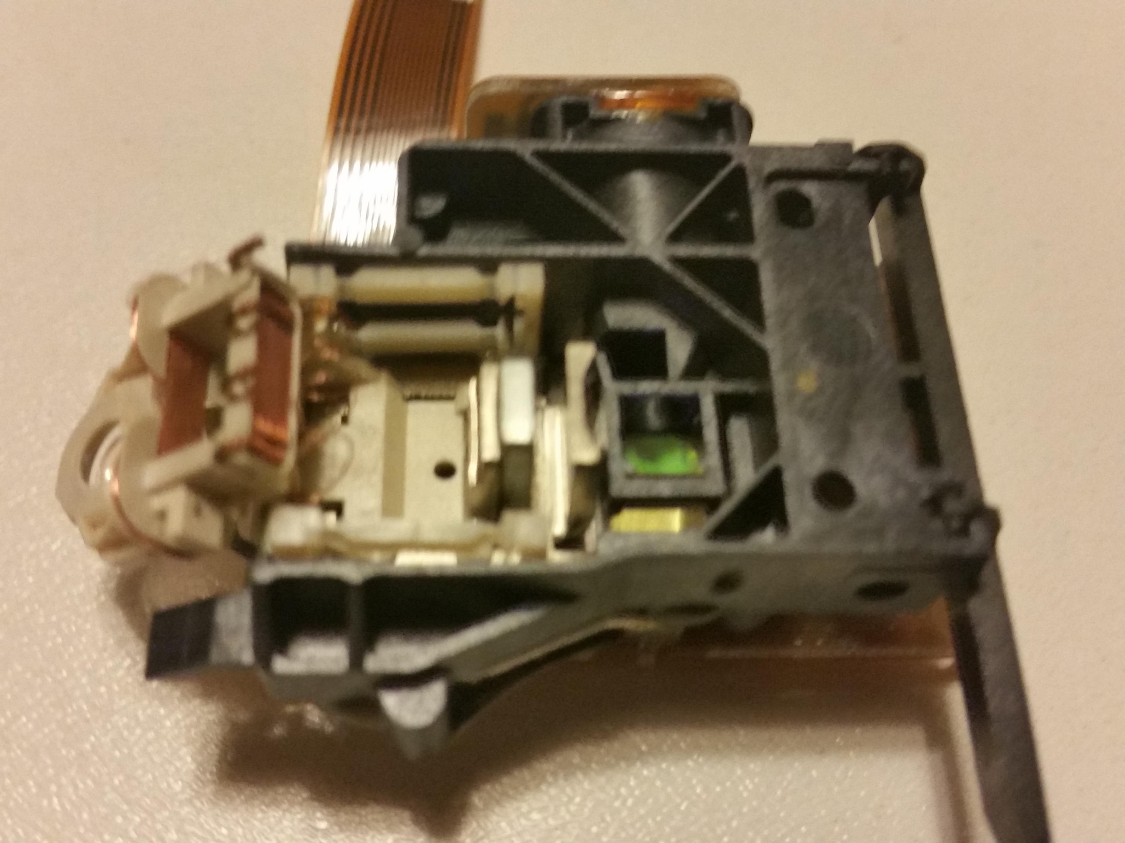

Having a chance to buy an unused CDM 12.6 for equivalent of 5 pounds I decided to use it for scientific purposes. I wondered if it is possible to take out the lens assembly in order to have acces to bottom side of the lens as well as to the prism and "diode cave". The lens assembly is hanging on four "hands" made of very thin plastic. There are 2 hands on each side connected vertically and clamped to the lens assembly. You may lift the lens assembly up to a certain point and that's it. I have used toothpick as a wedge and was able to unclamp the assembly and turn it upside down. You have to watch of course on focusing wires as they are extra thin but having time and doing everything carefully there's no big risk for damage. Please have a look on pictures !
Nice work 🙂 It would be good to have a player to test it in. Having gone this far you could also try cracking the LD out of its housing. The epoxy glue cracks very cleanly and easily.
I will test it in the nearest opportunity. My idea was to know what to do in case of a need for cleaning the pickup which is actually playing. As to LD cracking - perhaps for curiosity, but on this topic I can see how the LD looks like. The original diode is on e-bay for ca $36 plus mailing. Noone sells it in Poland. So Iwill rather wait for a bargain.
