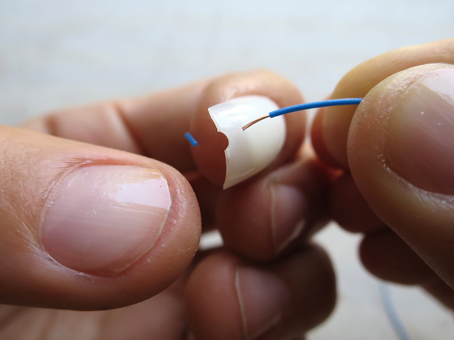

Yes, JMF is serious about wire stripping fingernails!

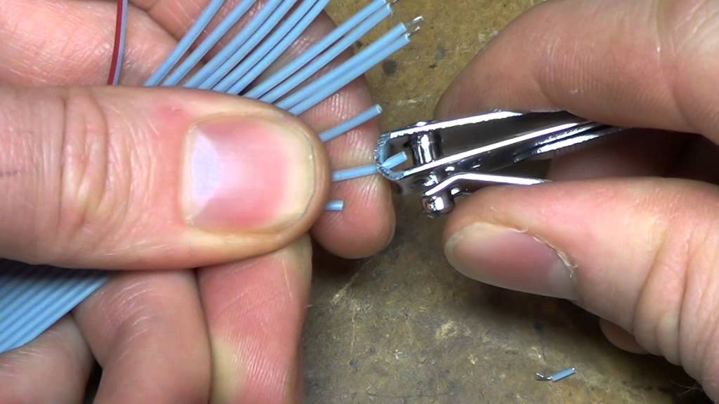

Personally, I use nail clippers to strip fine wire.

While nails are hard enough to bite into insulation yet not nick copper.
FWIW I do not use weak index nails (shudder) but only twice as thick thumb ones, and have turned that into a reflex habit, not even think about it.

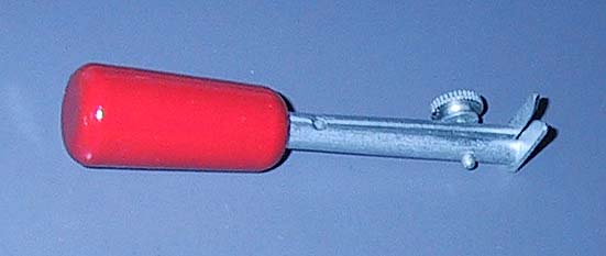

The early Antex irons used to have a tubular attachment around the bit which had a protruding blade with a 'Vee' cut out of it, this was so that a wire could be rotated in the Vee and cut through the insulation. I have copied it onto bigger irons.

By the way, a chip-off in one of my upper front teeth serves also, but not on global application.
