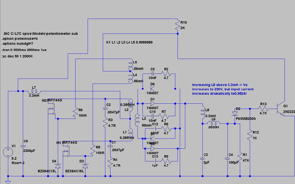

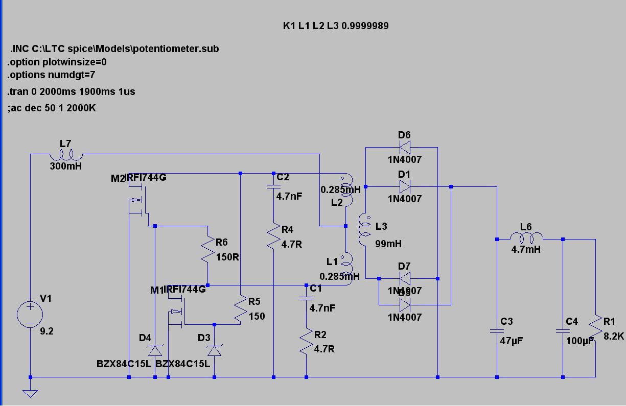

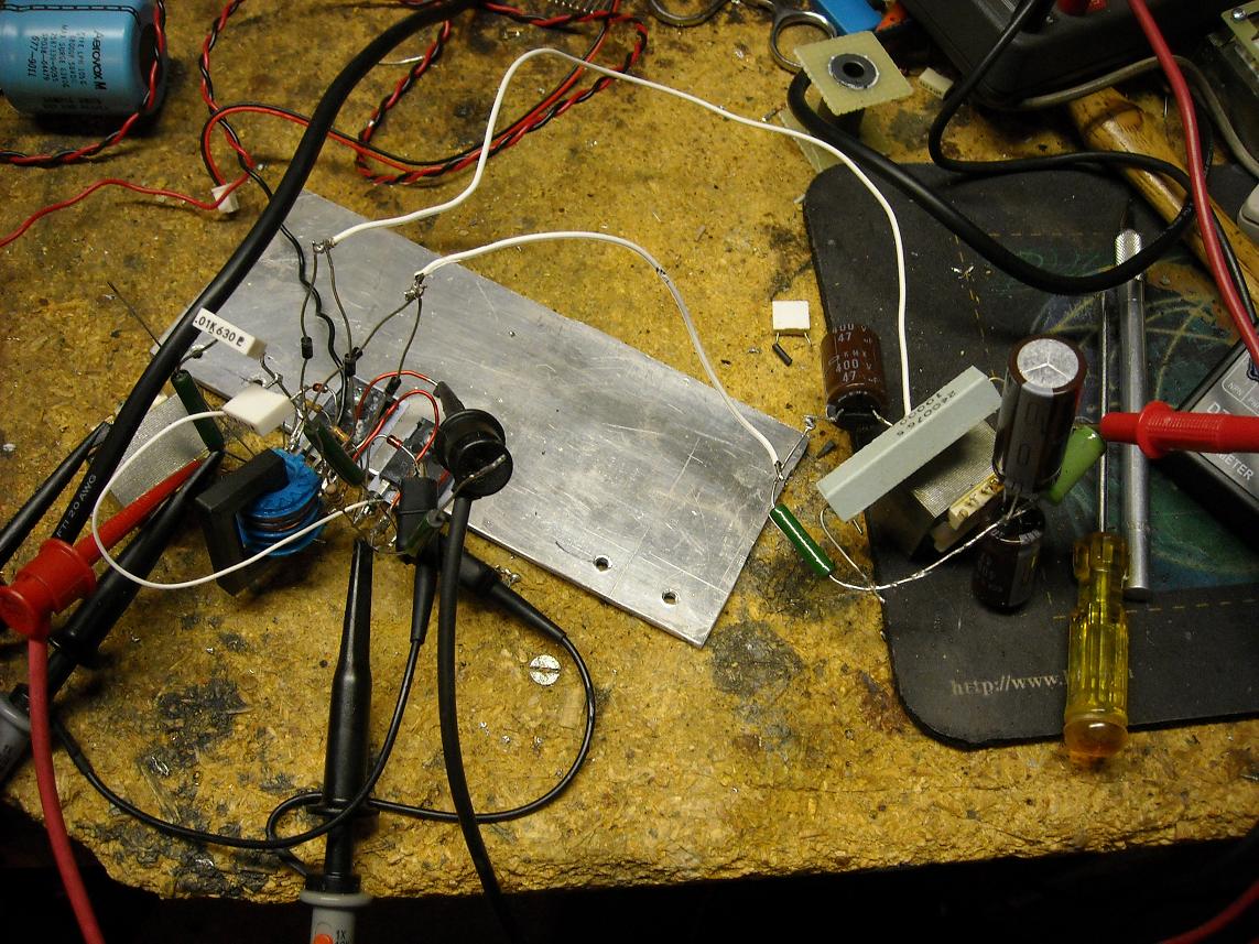

Strip off the windings but leave one attached at one end. Use it to wind the primary of 8T, twist a loop as Center tap, and wind 8T more. Connect the end to the other end posts.
Wind a secondary on the remaining two form sections. I used about 30ft of 28AWG wire. I lost count of the number of turns.
A shuttle is needed to wind the secondary.
So far I'm getting 200V at 25mA at 55% eff.
I suspect the primary inductance is too high as the only way to shift the frequency is changing the input inductor. Changing the snubber value has little effect. Adding an additional cap across the primary has little effect.
Transformer inductance values in the schematic are measured values, iirc leakage inductance was 1/100 of primary inductance.

No singing, although I probably couldn't hear it at 18KHz any way. The dogs didn't notice so I suspect it is not singing.
I've got some UF4007s I can try, for now I am concentrating on the waveforms. Snubbers tame the ringing on the leading edge.
The overshoot without snubbers is 100% the switched waveform height, and ringing proceeds for over 50% of the pulse width. With snubbers it is a slight overshoot (maybe 1V) which is not quite critically dampened.
I was hoping to get 85% eff, but it looks like it will take a lot of work to get there.
I rewound the primary using 5 turns bifilar wound and measured the transformer this morning at work.
Measured values are now:
Lp1.......=142mH.........Rp1........=0.018R
Lp2.......=142mH.........Rp2........=0.018R
LP1-2....=615mH.........Rp1-2....=0.036R
Ls.........=99mH...........Rs.........=1.44R
Cp-s......=0.006nF
Leakage inductance = 0.0036mH
I'll try it tonight.
Pretty much the same results. 50-55% eff depending on output voltage.
I switched to UF4007s and the output went up but eff remained the same.
I tried snubbers on the 1N4007 and was able to tune the overshoot to critically dampened, but never could get rid of it.
Interesting exercise, but I think I've about run my course.
It is running at 26KHz so I managed to move it out of the audio band by reducing primary inductance although even out of the audio band artifacts can still be an issue.
The power supply works best if tuned for power out, so the best approach would probably be to follow it with a simple series pass regulator with a shunt regulator to keep the load constant.

I tried one more experiment tonight. I wrapped a crude feedback loop around the converter.
Crude, poor regulation but it works. So I can set the output voltage level high enough under expected load conditions to allow for a series pass regulator without dissipating lots of excess power.
I'll come back to this later and wind a smaller core to see if I can get the eff up.
