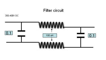

Here is the filter that fits between the Inverter and the Maida regulator. Similar circuits have been used in other posts!

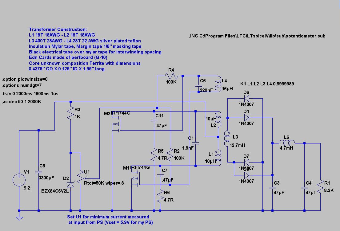

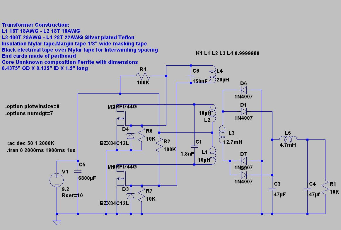

I built the power supply (just curious as I have no real application) and got lousy efficiency (17%).
So, after several attempts to tune it, I changed to a Royer topology. I'm up to 45% with 250V and 30mA out. I can crank it to 400V and 50mA with 41% efficiency.
I'm using FET with the Royer.
I've tweaked it about as well as I can ( including operating frequency, snubber values, etc). Right now it is running off a wall wart supplying 8.35V at 2A. Using a power supply with 13V it will draw 3A with the same 8.2K load, but deliver just over 400V.
Has anyone gotten better efficiency?
I suspect the core used has a lot to do with the design, and I am using an unknown core. I could use (Steward 615-867-4100) but it is shorter and would be more difficult to wind. On top of that I don't know that/if it would work better.
The winding is dual 14T primary, 400T secondary, 28T Tertiary for gate drive.

I guess you looked at the other links just for interest:
Photos Section
Jan's Inverter Instructions
This is only part of the fun, you have to power some tubes and get it sounding "good". 🙂 I chose ECC88 just because they are supposed to be good but guess what..the heater current is higher than garden 83..81 ect.
The inital problem I set myself was, I can only have pure DC at a single low voltage ie laptop psu, It must power an Aikido line stage with its quirky top tube heater /cathode requirements, and two EM80s + selector. So how do you keep the HT off the dc low voltage and lift the heaters? 😀 (Then again do you need to?). I found that most people seem to avoid the inverter because of the Tx required..so this just uses a large ferrite bead..just for fun of course 🙂
A fun project..with many unusual problems..just for fun..and because it gets you thinking..Its still working with no problems since the build.

Yes, I looked at those. The initial design was using a ferrite rod, and I had several so I used the one which was most physically adaptable.
He reports good efficiency with a pot-core, but I don't have any on hand.
I suspect my core is the problem since ferrite cores can vary considerably in their properties and this one has no part number I can look up.
I may try disassembling a transformer for the cores by boiling as is suggested on Jan's Inverter Instructions.

Please post your inverter schematic,
The interest with this kind of build is you can mix and match and build all kinds of projects..OK the HT is dangerous but no mains..🙂
Hopfully you will build an inverter project just for fun (dual channel)...getting the ripple out of the B+ and getting good sound is interesting..

Ripple is in the audio range (135Hz IIRC).
FETs were STW9NB80.
I found C6 to be more effective in controlling the frequency than C1, but also found it would not oscillate between 30KHz and 1MHz. At least I could not find a cap that would work in that range. As I came down from 1MHz, it jumped to around 27KHz.
Power dissipation at 1MHz was excessive and at 3MHz it only put out 24V.
Oscillation frequency is load dependent.
Operation at 400V out 50mA load, resulted in a 50degree F rise in the transformer temp. At 250V out 30mA load the temp rise was only 20degrees F.

This is the updated schematic as of tonight. I use the pot to set the bias current for minimum. This corresponds to the maximum output.

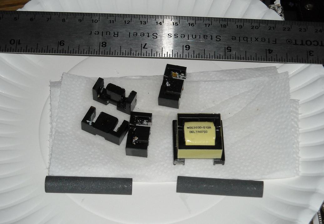

The second is a photo of the cores I took apart tonight. I tried boiling them in water to no avail. I finally had to heat them in an oil bath to almost 300C before they would separate. Needless to say, this destroyed the plastic coil forms so I will have to bust two more to recover the coil forms from them.
Fortunately I get them for free so I only have a little time in removing them from boards as an investment. I suspect they will be too small for the number of turns i need to wind, however they were rated at 24W for the 120/240 to 24vdc switcher they came from. I think it operated at 400KHz.
In addition there are two of the cylindrical ferrite forms I used in the original switcher.

Thank's for posting the schematic,
Yes I tried to use various switcher cores, I found they tend to be fragile and break at the corners. A real pain to strip. Then you need the mylar tape and winding with any magnet wire over size is almost impossible.. I have 350-400V from the ferrite bead and just the two windings.. 🙂...Then again I found the the experiment very interesting and realy enjoyed this project..😀
