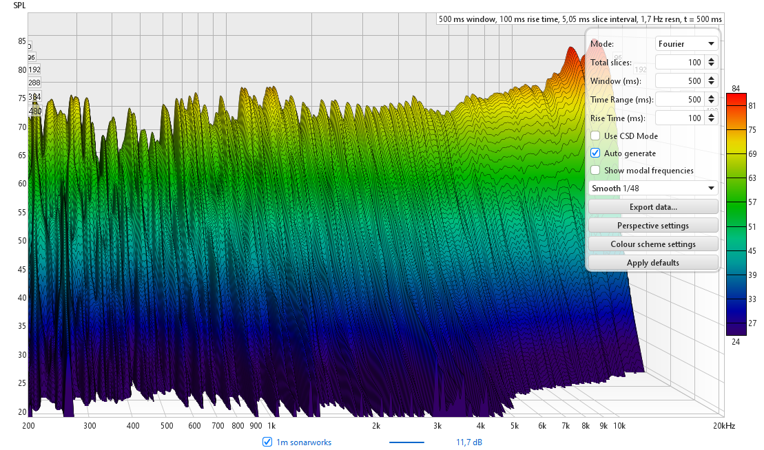

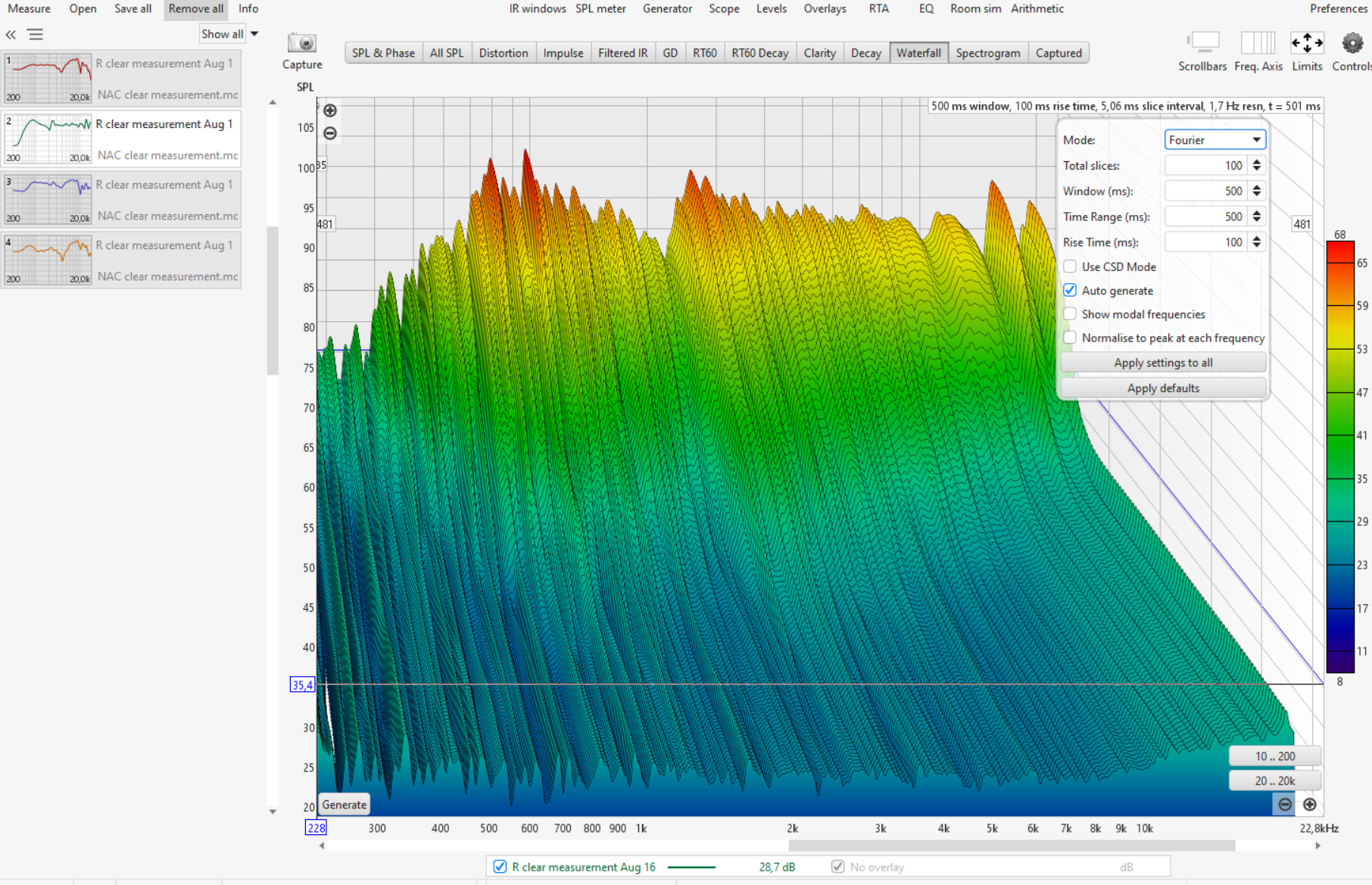

I find what cause the "ringing". It comes from way you display waterfall. If you choose Burst Decay mode then usually time axis is not time but periods of sinus signal at particular frequency.
From REW help: The Burst Decay mode provides a way to more easily distinguish resonances of similar Q but different frequencies. It does this by showing the way a shaped tone burst at each frequency would decay, but along an axis denoted in periods of the frequency rather than time. On a period axis the extent of a decay is the same for resonances of the same Q regardless of the frequency of the resonance.
If you select Fourier mode, you get standard waterfall what is also way how producers and others display the results. There is no ringing until level where noise will be visible.
There are still 3 peaks/dips on graph from 10 to 20kHz and the first two can and will be heard. There is smth wrong with sound reproduction hardware or measurement setup hardware/software. I checked my measurements - there are no such peaks on any of the worst drivers.

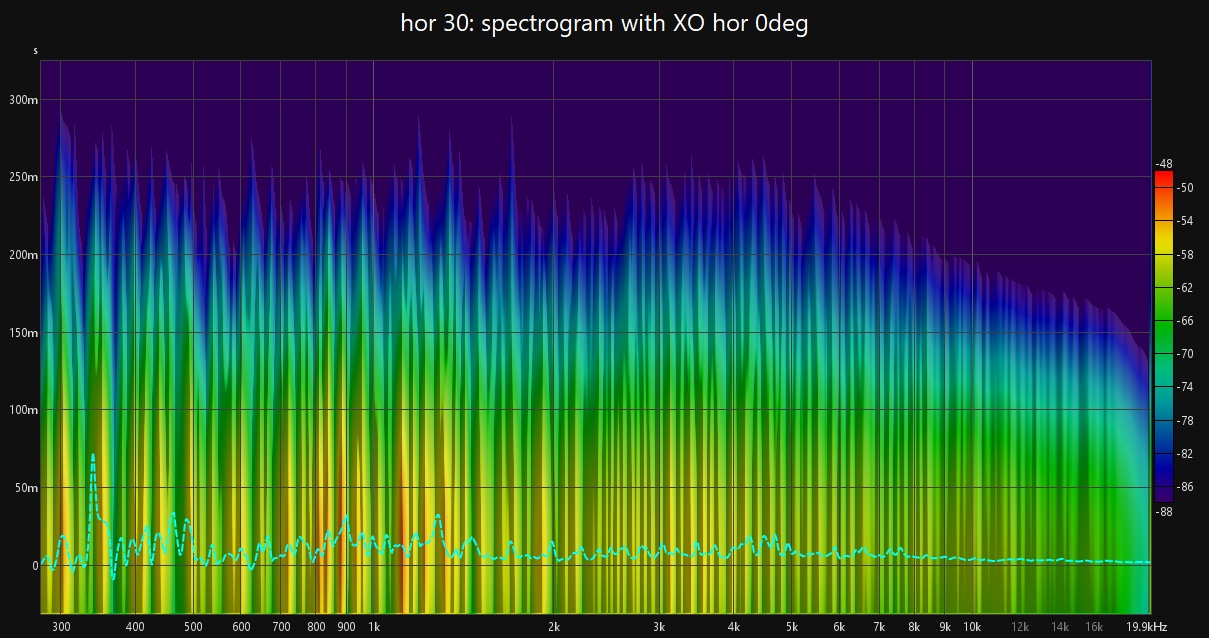

I just checked
I changed the view from Burst Decay to Gaussian
Basically spectrogram of tweeter w/o XO still have some 'fires" above 10kHz (as svp noted) probably some errors due equipment or noise.
Then I checked the measurement of the finished speaker with crossover
Ta-Ra!
All the ringing disappear!
Thank you very mach for the advice! I never thought there was a difference between the two views and that one shows the spectrogram in cycles and the other in time.

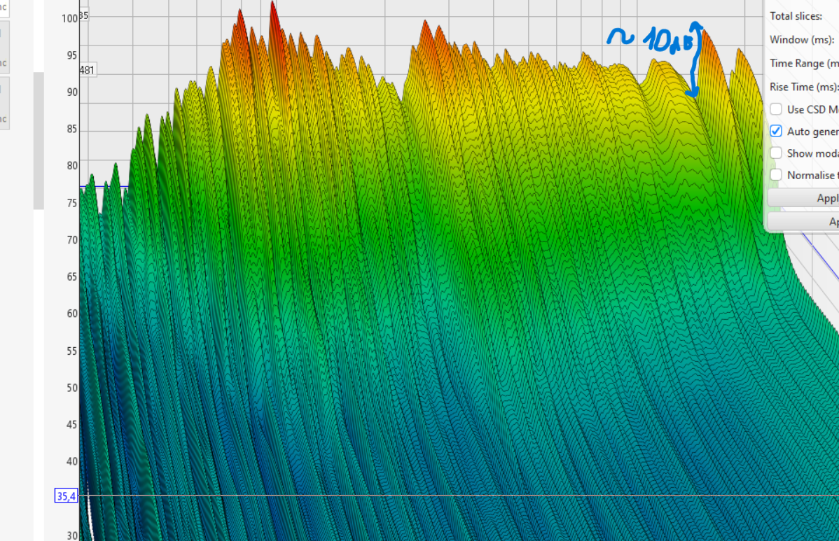

I wanted to emphasize that this is not how the SPL curve should look of pretty good and expensive tweeter:
The dips/peaks are +-5dB, or more, or 10dB overall. It is not how should plot a good tweeter.

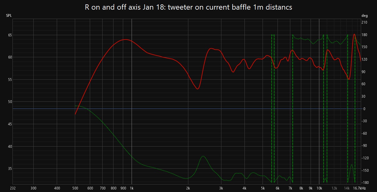

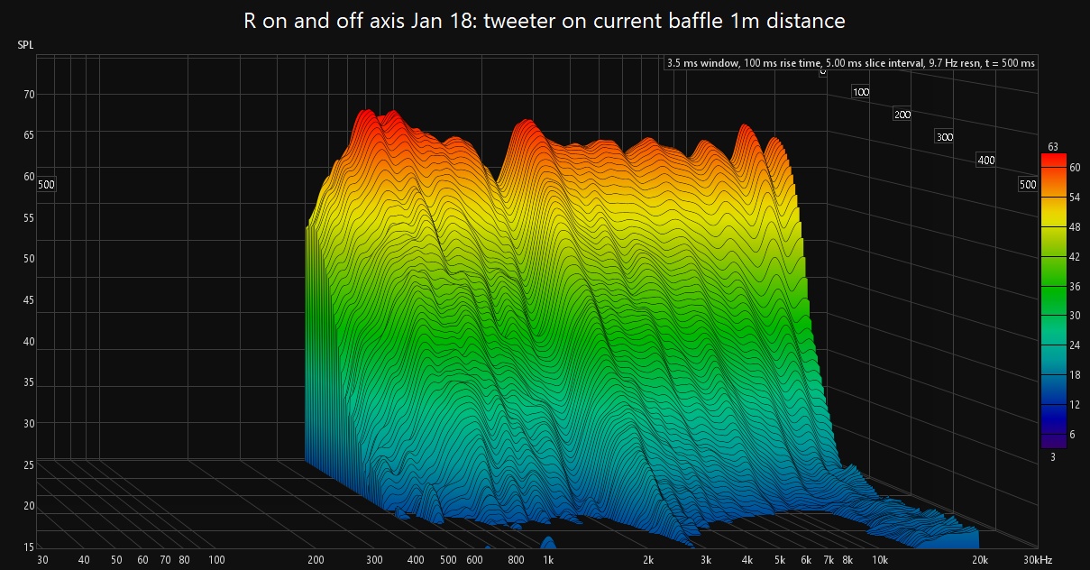

The first measurement was farefield 1m

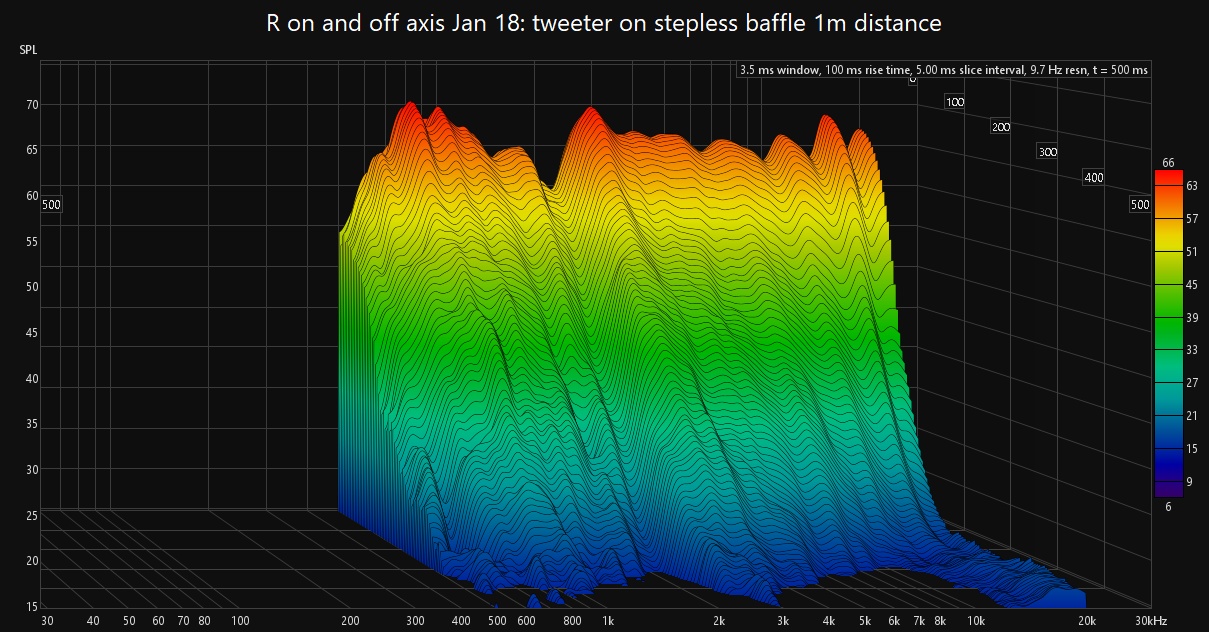

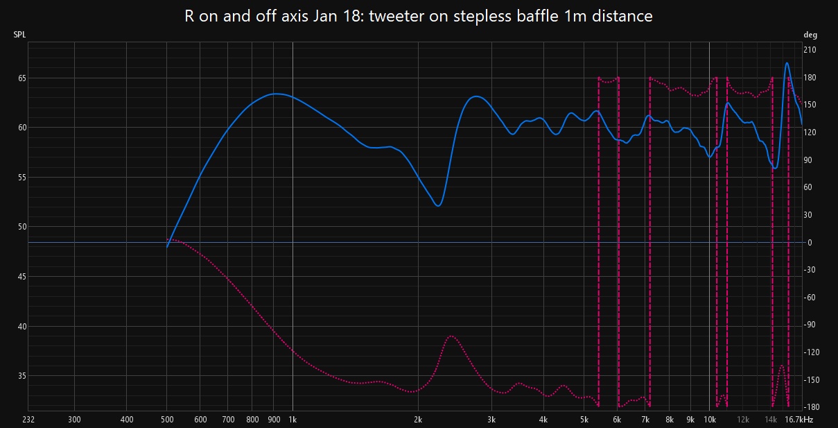

After that I placed the tweeter on the new stepless baffle keeping the same distances from the edges.

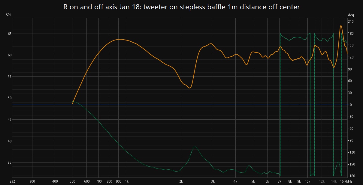

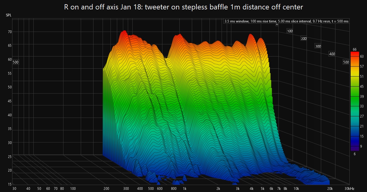

On the third measurement I moved the tweeter off center.

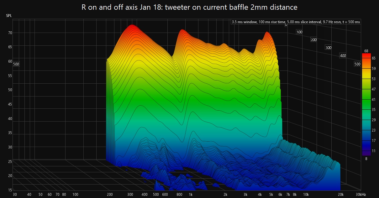

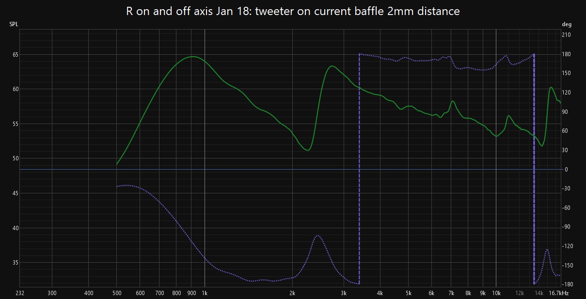

And finally I put the tweeter back on its place and moved the mic 2mm close from the phaseplug

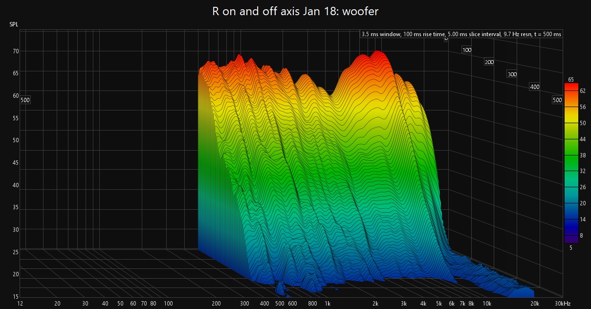

In the frequency range above 7kHz the baffle doesn't have significant impact over the tweeter's behaviour. The tweeter's ringing isn't linked to the baffle step or the tweeters position.. The possibly of defective driver is rather insignificant, as the both units acting the same way despite they was bougth at different times.
I have doubts about the quality of the used equipment as some of the guys assumed. Probably the amplifier or the sound card are producing some hissing noise as the same ringing appears within woofer's waterfall at the frequencies over 13kHz.
What your ears say? If the sound is good - probably it is good.
For me at 2mm the drop of 10dB from 3kHz to 15kHz is not how it should be.
Yes, it could be hissing of some component, but that component can be analog part of inside USB mic also.
Or it can be measurement procedure. For analog mic I use this one, as most of us here: https://kimmosaunisto.net/Software/VituixCAD/VituixCAD_Measurement_REW.pdf

Measurement at very low levels can be the cause of such artefacts. I do not have very accurate SPL meters, but for my ears from 70 dB to 80-85dB levels show pretty much everything speaker has to offer.
I read also that ASR thread - it is more for measurement finished products, that one manual from Kimmo is for DIY designer (as you are) and is much more concentrated, and for measurement of separate drivers, before you build crossover for them.
You measured drivers with crossover, right? When measuring tweeter, what you did with woofer and vent? Covered it with pillow or smth?

No crossover used during the last measurement.
When I measure the tweeter, the woofer is off (unsoldered).
