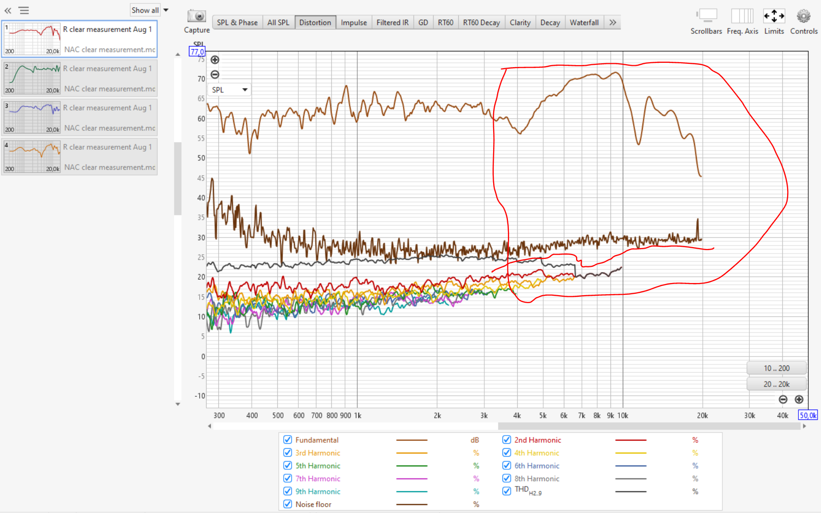

Please post the impulse response for the first 2ms of just the tweeter if possible.
Baffle diffraction does not cause sustained ringing, is it possible the tweeter is missing the damping material in the rear chamber?
What could be happening is the baffle step is reflecting a 16KHz off-axis resonance into the listening axis.
Try filling in the crevice at the baffle step with clay or just a sloppy application of tape. Also try using tape to square up the beveledge edge of the step, which is the right angle to reflect something toward the listener.

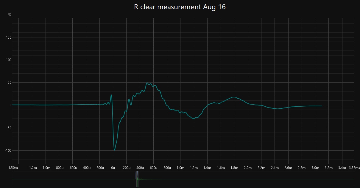

BTW the impulse response looks a bit swingy. Maybe that causes the weird ringing?
But on the other hand that will impact the overal tweeter response not only certain frequencies.
The swinging in the impulse response IS the ringing, the impulse response is the same data that is in the frequency response, but displayed in the time domain instead of the frequency domain. Anything that is visible on the frequency response can be found in the impulse response, but each makes it easier to see different things. Use the EQ tab in REW to add notch filters (negative PK filters) to remove the ringing, then you can more easily see the other things like reflections and diffraction.

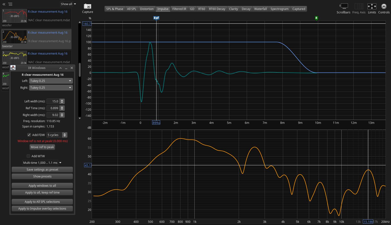

Look waterfall in first post, it shows ringing until 20 -30 ms, impulse response on image is only to 3 ms.The swinging in the impulse response IS the ringing, the impulse response is the same data that is in the frequency response, but displayed in the time domain instead of the frequency domain. Anything that is visible on the frequency response can be found in the impulse response, but each makes it easier to see different things. Use the EQ tab in REW to add notch filters (negative PK filters) to remove the ringing, then you can more easily see the other things like reflections and diffraction.
As I remember levels were 68dB SPL and I didn't change the settings between woofer and tweeter measurements.
However the process is not reversible. If an impulse containing excess-phase information is "flattened" to a response plot, it loses information that cannot be recovered.Anything that is visible on the frequency response can be found in the impulse response, but each makes it easier to see different things.
For an impulse to be correct it needs to be directly recorded and preserved that way.

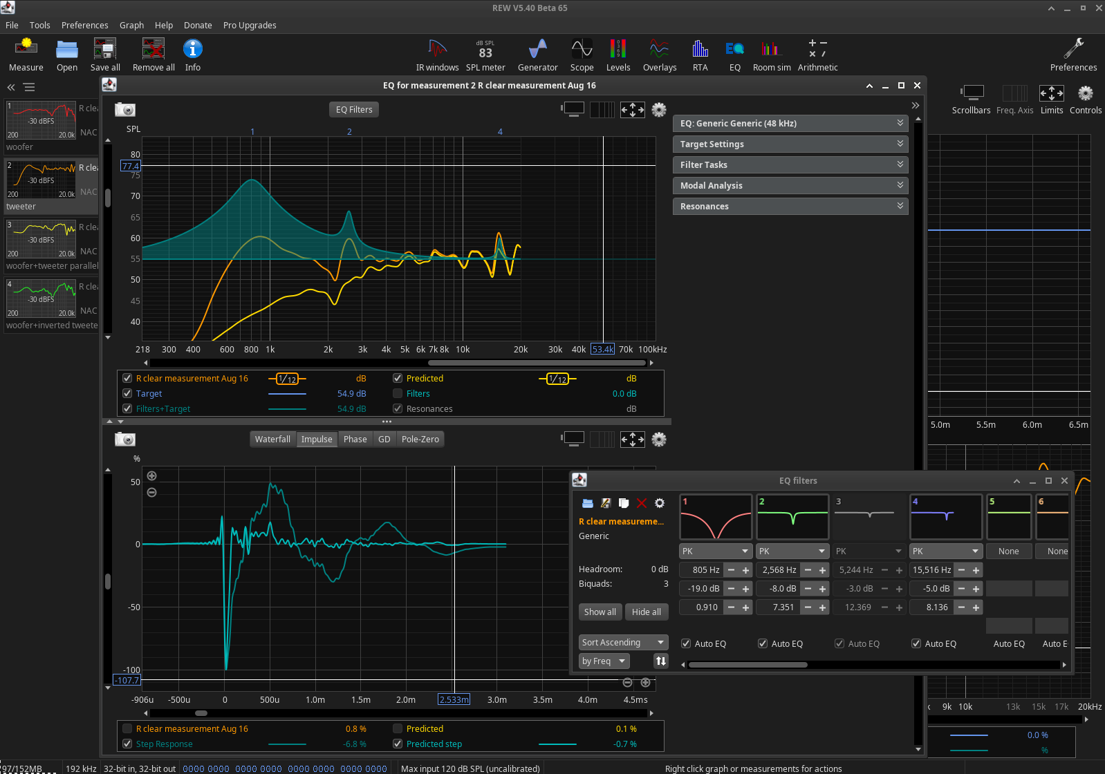

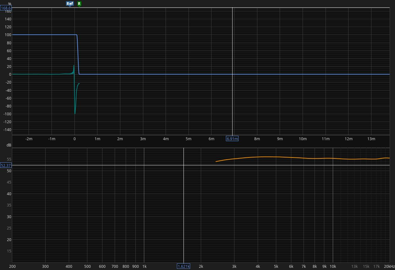

Here is the step response with some peak filters. You can remove ringing and then you are left with reflections.
Target settings -> none, then click the EQ filters button at the top and add some PK filters. With the filters we can clearly see reflections at 250us and 500us (3.4 and 6.8 inches).

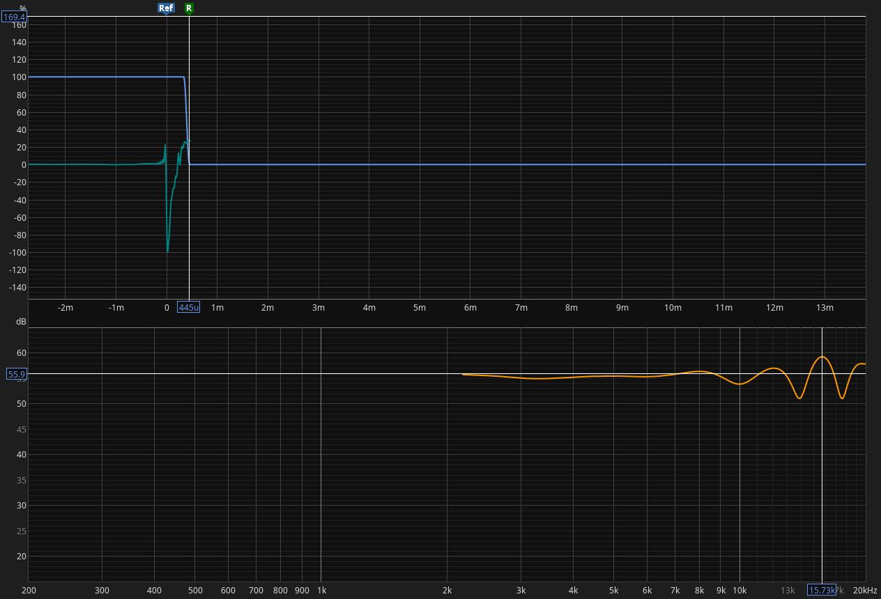

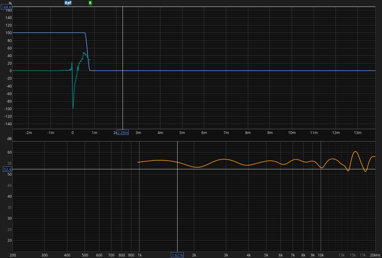

Adjusting the windows, we can see that before the first reflection the impulse response is pretty much pristine.

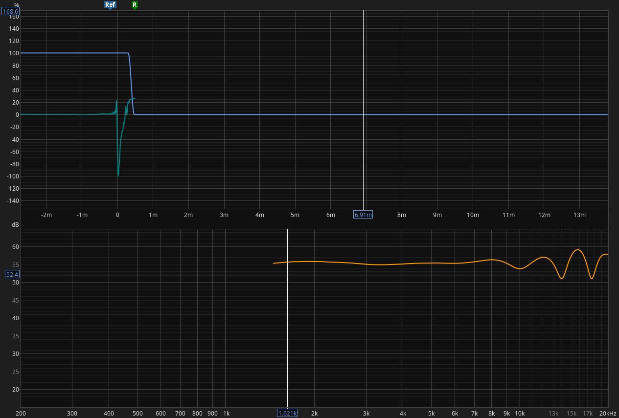

The first reflection at 250us causes comb filtering at 16KHz
The next reflection after that causes comb filtering throughout the upper mids and treble.
However scanning backwards through the step response with a short FDW window, we find that there is a sustained ringing at 15KHz which overlaps with the comb filtering, but they are two separate mechanisms.
So the tweeter is definitely ringing, and the baffle seems to be reinforcing it. If you change the tweeter position you could possibly get the ringing to land in a diffraction null instead of a peak. To know whether there is anything wrong with the tweeter itself you would have to test it in another baffle or possibly without the mounting plate, but I wouldn't blame the tweeter yet although the ringing is concerning.
