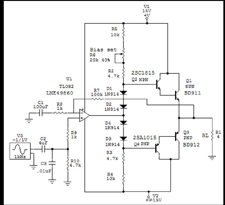

Those output devices would work in this very clean simple little amp. 😉
But do learn what Bias means as it needs to be set in this design.

And how can the bias across the diode stack change?
It's a sub amp, remove one diode and let it run class B.
Better yet, run a couple of emitter resistors on the drivers to the output section, run three diodes, and call it class AB+B. Add some emitter resistors to the outputs, maybe some base resistors too, and maybe base resistors on the drivers, and a small resistor on the IC out lead.

djk,
Yes it would be good to add some emitter resistors but I didn't have any handy at the time, so I didn't employ them.
The bias is adjusted with the 20K pot R6 using an ammeter in series with one or both of the collectors and the power supply.
I forgot to mention that the schematic doesn't give the exact percent ratio for the setting of the R6 20Kpot either.
But I can assure you that this schematic works as is, and, was drawn directly from the actual working circuit that I had on my protoboard.
It was not just for subs and it worked great for the full range of the audio band.
I ran this circuit through it's paces and used output loads as low as 2 and 1 ohm and it worked as expected using a supply that has an ample current potential.
Not a lot of power but good enough to drive any quality speaker with very good sound.
I had as much as 1 amp to as little as 10 ma of bias flowing through the output transistors.
It had maximum of only 10ma or less of bias current offset at any setting and stayed balanced with no change in the current offset at any stetting.
The output offset voltage (Vos) was that of the opamp that used, typically less than 5mv or better.
All of the devices were very closely matched as is right out of my junk box.
I had already posted this circuit before in another discussion but I couldn't find the thread.
I had though about using just three diodes but I never tried it.
Since they are in a darlington configuration they needed more Vbe than what one diode would create.
So, I just used 2 of them for each the top and bottom to keep everything symmetrical.
I also had matched up the diodes Forward voltage drop (Vfr) of each pair so that they were equal for both halves.

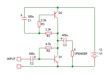

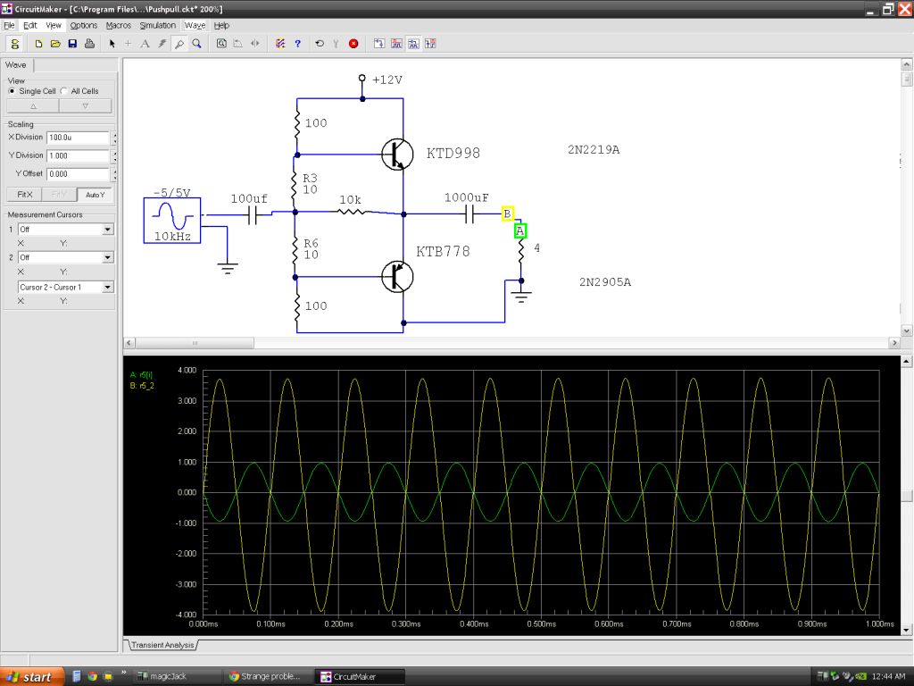

Here is another very very simple amp that I just whipped up in CircuitMaker that may work as well.
The green trace shows a peak of 1 amp through the 4 ohm load.
And the yellow trace shows the voltage across the 4 ohm load.
The gain voltage Gain of this circuit is less than one at 3.71Vp/5Vp= Vgain .742
Although the voltage gain is low the current gain at 10X is high enough to drive a speaker when driven from a headphone amp.
I used small signal transistors for the model, but should work just the same using the Power transistors as stated.
The 100 ohm resistors should be rated for at least 1 watt.
Make sure that you use a heatsink on the transistors as well as they will be dissipating some heat.
jer 🙂

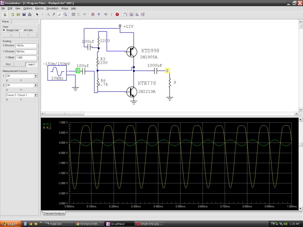

Godfrey have you verified your circuit in a simulator?
Just curious becuase I just tried in in Circuitmaker and it does work with some nice voltage gain but it is very nonlinear.
Cheers !!
jer 🙂

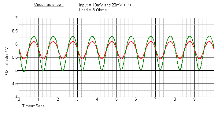

Nope, I drew it in a simulator, but didn't bother to run it. 😱 I'll try that now.

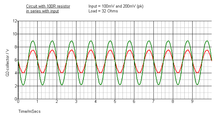

That's about what I expected. Distortion will be bad with more than about 10 or 20 mV input. It could be worth adding a resistor in series with the input - say 100R to 1K. That will reduce gain but should give less distortion for the same output. Alternatively, a resistor of one or two Ohms could be added in series with the emitter of the NPN transistor, for the same effect.
Here's some results. I don't have the right transistor models, so I used some other power transistors instead, but it should give an idea.
Transistor idling current is only about 125mA or so, depending on the transistors, so output voltage is very limited, but increases with higher load impedance (see third pic). The output impedance is high too, so with normal speakers there'll be quite a bit of bass boost. 😀
