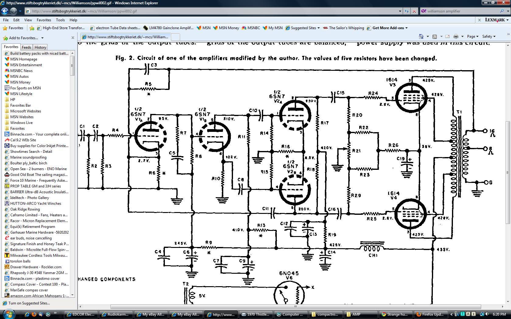

In the attached schematic R7, C5 create the dominate pole for Amp's stability. The capacitor can be increased for stability but excessively large with decrease the power bandwidth.

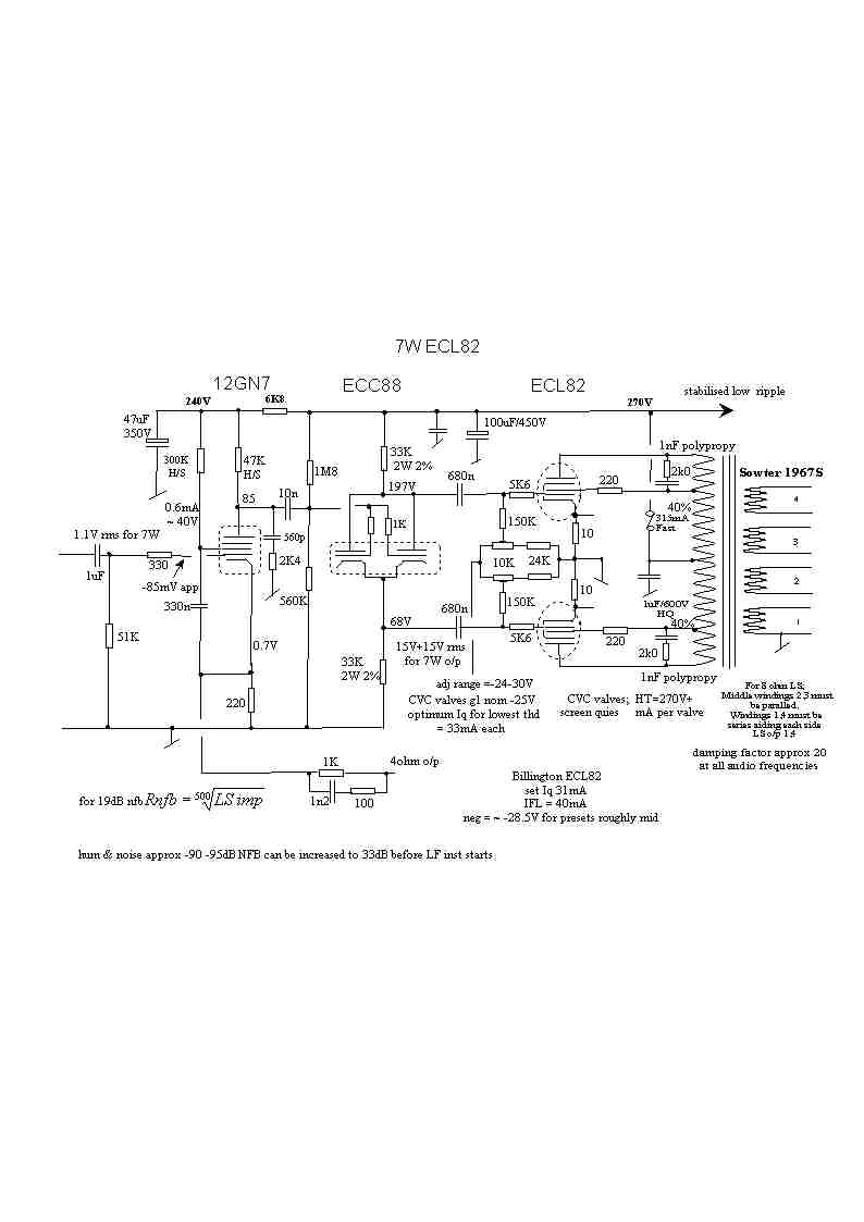

Oscillation can sometimes happen with UL. If not already present, try adding grid stoppers to the output control grids. Then g2 stoppers (say, 470ohms or 1K 2W wirewound). Finally, you may have to add snubber networks from each anode to g2.
Confusing ? See pic.
The principle applies whatever the poweramp rating esp when the UL tap is a greater part of the primary. In UL designs using high gm tubes and wide bandwidth transformers which may appear stable without this Zobel, there are other advantages in implementing it.
richy

You now need to adjust the compensation to get it stable. A capacitor across the feedback resistor, with or without a resistor in series, and/or a lead-lag CR network at the inout stage anode. The circuit shown in post #13 has both of these, but you need to adjust the values to suit your circuit/OPT/layout.
