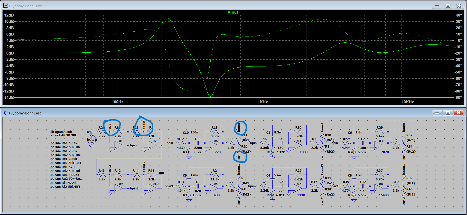

At the summing section - should be the "Cut! and "Boost! connected as well to the op-amp "Cut" and "Boost" or is it just to simulate pot?
In LTSpice, nodes with the same label are all connected together.
Some things don't look right in the plot, e.g. the 430Hz band seems to be the one with the lowest Q and it's supposed to be the highest at 1.5, the 1080Hz cut clearly has a higher Q than 0.3... Please double check...

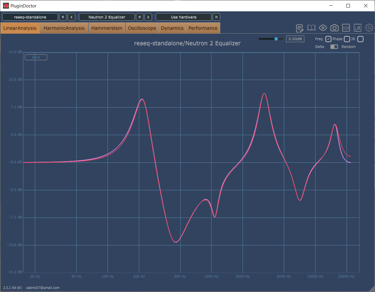

Since the circuit seems to be closest to the iZotope Neutron 2 response, I installed ReaEQ, tweaked Neutron to match it, designed the bandpass filters per the tweaked Neutron ones and now the circuit pretty much nails it.

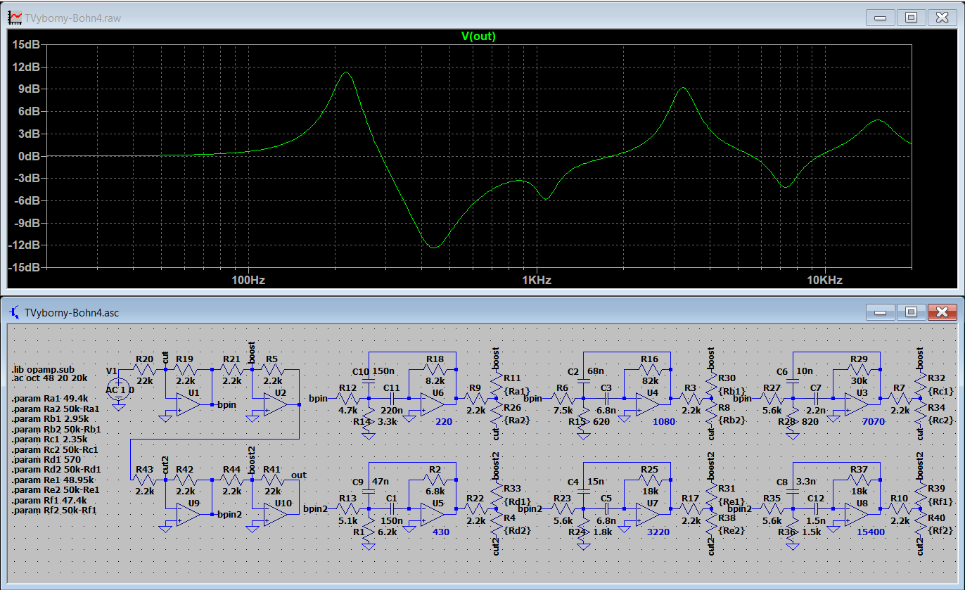

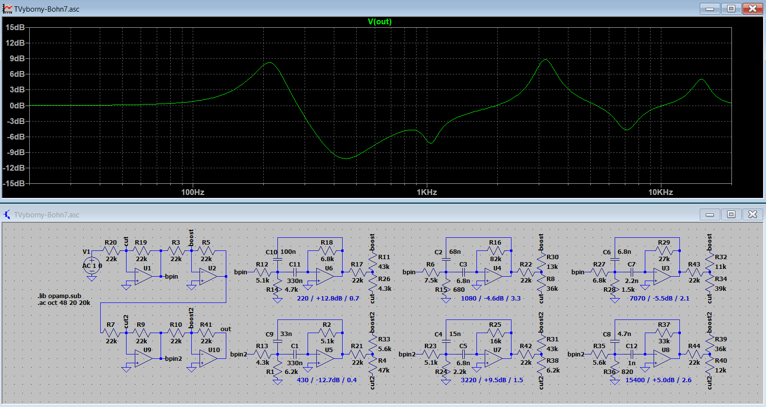

Krivium is right that even with trimmers this could be too bulky to go inside a guitar control cavity, so if your friend is positive that this is the response they want and is ok with it not being adjustable, fixed resistors are the way to go.
I wasn't crazy about the gain structure and, as it turns out, replacing all 2k2 resistors with 22k not only eases significantly the load on the opamps but also makes a few of the pot settings much less extreme, which in turn makes it easier to find fixed resistors that will give the right response, see attached (the gain and Q values shown are what I had to use in Neutron to match ReaEQ, you can ignore those, I put them there for convenience).
