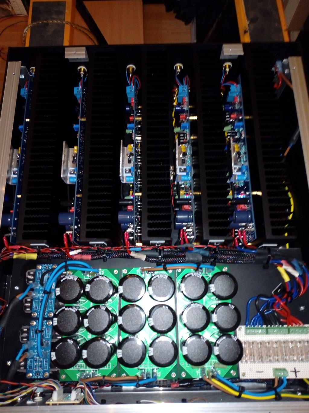

This one. A 5ch class A/B amp, is sitting at about 10C above rom temp. Whit internal sinks. 5x 4U300mm sinks. Best estimate is that internal chassis temp is about 3C above rom temp. so the sinks sits at about 7C above ambient. With 130W powerburn at idle/mild use.

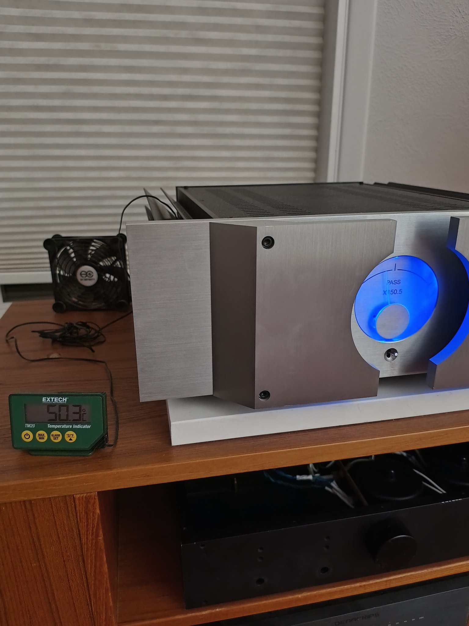

Or you can turn up the bias beyond power dissipation spec for dead air and move some air. It takes some temperature monitoring, but it is amazing how much heat dissipation can be achieved with a small amount of airflow. PS ambient 18 deg C in picture so no fan.
