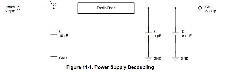

I jiust went through the LMK1C110x datasheet and it gives indications on the decoupling of the power supply (attached below). I'm not clear on how should be addressed the power supplies of the NDK oscillators and the associated buffer:
Help welcomed about good practice there.

For the oscillators decoupling caps, what would be a correct value? I see 10nF C0G 0603 proposed by bohrok here https://www.diyaudio.com/community/threads/general-purpose-dac-clock-board.413001/post-7703184. But I don't know if it is to complement a larger cap (in some design I see 10uF).
The aim is to eliminate noise from USB or MCU board to reach DAC. USB noise can be mitigated with USB isolator between host and device. MCU board noise can be mitigated by using isolators between MCU and DAC. For this to work all signals between MCU board and DAC should go through isolator (I2S, I2C, GPIO, MCK from DAC to MCU). In this case you would need several multi-channel isolators. Fast low jitter isolators are quite expensive.I still don't grasp the key aspects of the noise propagation in the design from USB power to DAC, need for isolators and good engineering practices there.
Oscillator and clock buffer decoupling is another design decision. LMK1C110X datasheet gives some advice on using ferrite beads. Their purpose is to decouple clock circuit from rest of digital circuit.
Local oscillator decoupling caps should typically have self resonance at clock frequency or at expected noise frequency. For this 10nF C0G should work well. Larger caps or caps with lower self-resonance frequency can be used in clock PSU but for local oscillator decoupling they are useless.

- usage of LDO with High PSSR, like the TPS7A20 you suggested,
- independant LDO for the MCU, the Clocks and buffer, the DAC,
- usage of ferrite bead and 10-100nF Cap between USB connector and 5V rail (ex https://e2e.ti.com/support/processo...get-strong-noise-immunity-on-am335x-vbus-line) ?
- Cap and ferrite bead decoupling of critical loads as per LMK1C110X datasheet.
Is it correct? Any other "good engeeniering" feature missing in the list?

I spent a a bit more time trying to find some application notes on USB DACs and look at some tear down on Audiosciencereview. We can see some Common Mode Line filters on data lines. Some filter between the USB connector shielding and the board ground. Even on the cheap SMSL SU-1.
I looked at the AK4493 datasheet and evaluation board, a chip that can reach very high standards. Nothing too fancy here also:
So the foreseen design does not seem should prevent achieving DAC datasheet performances 🙂
I have now to move on: finalize the schematic, complement the BOM, toute the circuit (more pitfalls there)
- separate LDO for Digital and Analog parts,
- clock on the Analog LDO, with decoupling capacitors
- separate ground planes for the digital and analog parts, with a split in the middle of the DAC chip,
- BA033 and LT1963 LDOs, hich don't have very specific performances (Low Noise: 40μVRMS, when TPS7A20 is at 7μVRMS).
