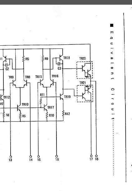

Interesting. A quick scan of the data sheets (for the Class b and the class ab) both show a darlington output stage with zero bias. Bases of the outputs connected together.
Suitability for high quality audio based on that at face value... zero I'm afraid.

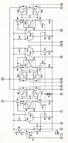

Check those datasheets again.........
The ones I have on my HDD show all of the chips have either a VBE multiplier or two biasing diodes for the output stages. Only exception being the 392-110 having zero bias output stage, and class "B" operation is even mentioned in the datasheet for the 110 only.
The 110 IMO being class B, could possibly be used just as a VAS stage to drive an output stage.
The 250, 560, and 040 have output currents of 3,5, and 7A which look like they should be able to drive a speaker.
I like the idea of using a several Mhz capable op-amp to drive a large parallel output stage, or for other audio uses.
Some have, some haven't. I looked at the 120 variant as well as the 110. That shows class b as shown here.
You could power one of those up in minutes into a dummy load and do a quick scope check on things like squarewave response and bandwidth.
You are 100% correct, I double checked the datasheets. I now see both the 110 & 120 are class B. All the others are class A/B though. The class B chips could still be used as a VAS stage for a power A/B output stage, using the chip to source/sink the bias current to keep the chip biased on (class A).
I'm about to hook up a couple different ones and see how they play. I like the idea of using big power op-amps because they are already frequency stablized, and I have less to worry about with things like DC offset, setting bias current, and oscillation, etc, compared to building a raw discrete amp.
