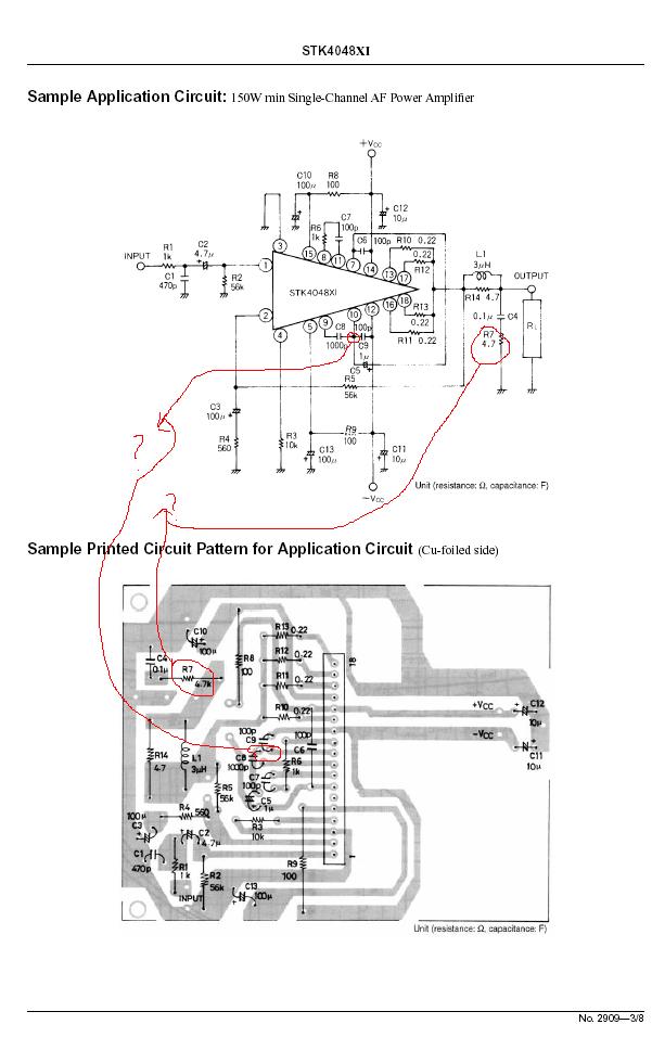

hi. i want to make stk 4048 amplifier. i m drawing pcb from orginal sanyo 4048XI pdf file. but in the pdf i saw two difrence between sanyo's schema and pcb. whichone is true??? can u help me bubu? i m attaching this pdf file and i spoted these erors on attached pdf.
