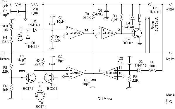

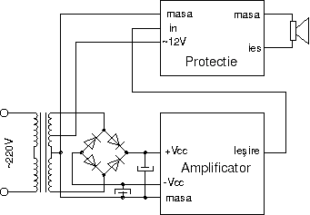

The protection circuit... Intrare=Input, Iesire=Output. Right?
From SR1 you can adjust the level where your speakers will be disconnected from the system. It will do soft start with 3 seconds delay, DC protect and overpower to skpeakers. The minimum power required is 6W. It does not protect you from short circuit and it was designed for diferential power supply. So don't use it when bridging! When you make the SR1 adjustments put a resistor as a load to your amplifier.

And protection part 2. You can order it from http://www.elmatrd.ro/prot-1.html if you are too lazy to build it for about $3,60+pp.

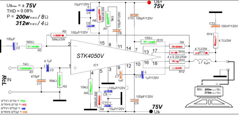

STK4050V and 4ohm and 200WRMS
How can I get from my amp, what is based on STK4050V, 200W RMS power, and if I use loudspeaker with impedance 4ohm. This 200W should be long-term power, continuous or smth like this.
i want tu use this scheme:http://bedrisus.sitemynet.com/ses/200W.jpg
and use STK4050V.
please help me
and use STK4050V.
please help me
