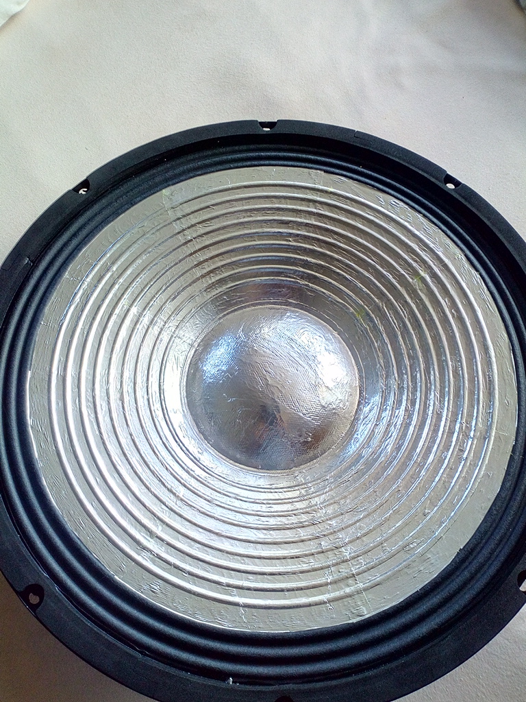

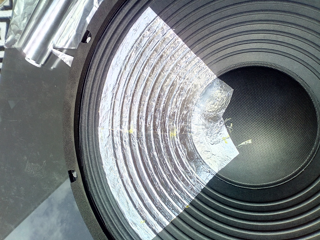

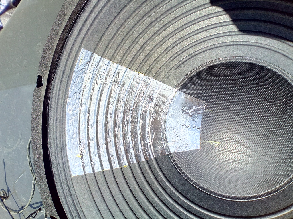

Aluminium foil on an 15 inch paper bass driver
