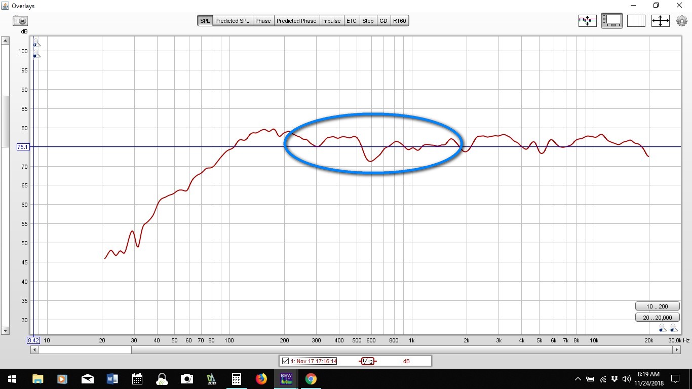

The attached response curve is for a sealed 2 way with 5" woofer and 1" dome tweeter. Crossover is about 3500 Hz. The woofer has a paper cone. I'd like to raise and flatten the woofer's output between 200 and 2,000 Hz. Seems like stiffening the cone might help here and I'm most likely going to Modge Podge it and re-measure. Thought I'd throw it out there beforehand for comment.

Use thin layers. Allow 24 hrs to dry. Measure each time. The top should fall off with more coats.

After getting another look at the woofer, it is pretty stiff as is due to its small size. I'm leaning towards thinking it will have no effect.

I agree. The wiggles are at too low frequency to be cone resonance. They are most likely baffle diffraction or boundary reflections, depending on measurement setup.

You already have an incredibly smooth curve; specially in the area that worries you.
If anything, you have a slight bump between 120 and 280 Hz.
I bet increasing cabinet volume by some 40% would both move it lower by 1/3 octave or so, flatten it in line with the rest of the curve and extend LF response downwards by the same amount.
