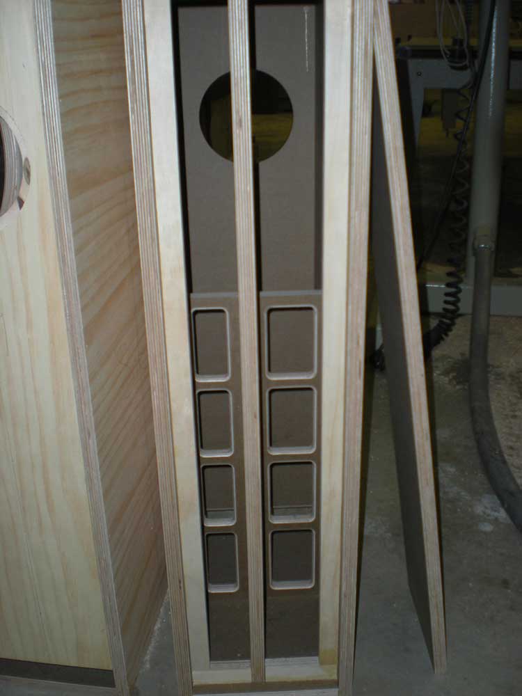

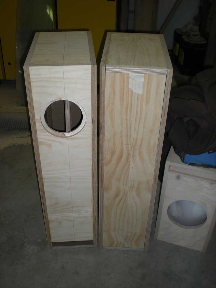

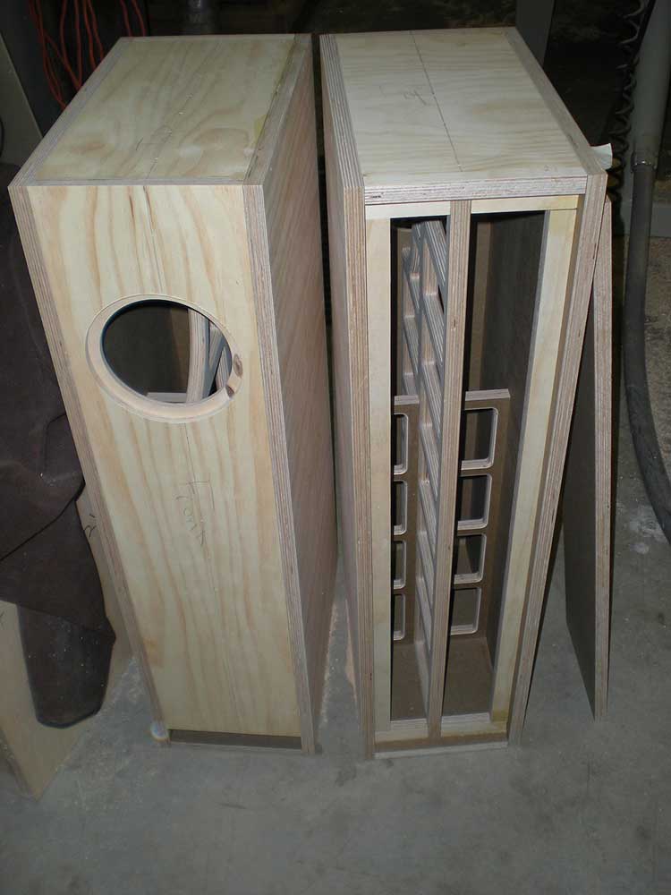

I know it's been a couple days without pictures or progress. Time to work on my projects is hectic and I've been working on other projects as well. Here are a few pictures to keep you entertained. Veneer should be here soon and I will finish off these boxes. Though I do need some advice. I haven't bought binding posts/terminal cups yet. Can anyone recommend a budget oriented post/cup for me?
Apex Jr has some nice gold plated copper binding post for less than 10$ a pair. Work great. If you want to spend big money, make sure this is your final system, otherwise you will have to change post every time you build a new set. You will be building more idf your like most people scowering these forums. Just got done with 10.2 Pensils. You will really enjoy them. Good luck!
Nice boxes. I'd use some 1/4-20 nuts and bolts with washers, but that's me just being me. 😛
Thanks for the recommendation Buzzforb! I'll be ordering a couple pair of those today. And I doubt that these will be my last speakers that I build. I'm already daydreaming about other designs and different drivers. I've actually been breaking in these speakers and am pretty excited about the results. They sound great even in their little cardboard boxes. Hahaha! I can't wait to see what they become in the cabinets I built for them.

How do you get 1.5lbs as the recommended stuffing? I'm going from the internal dimensions and I keep getting 1.8lbs. ((14.625 x 8 x 35.5) / 1728) x 0.75 = 1.8lbs
Am I doing something wrong?
I could be wrong, but i think that is what he had listed on the cad drawing. I believed this is what he used in doing his calculations for the design. I will check.
It was 1.59 lbs.
