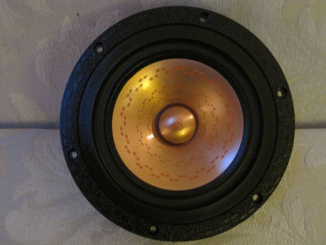

Wait wait wait. Are you telling me I could've bought my 10.2's EnABL'ed for $160 each? Had I known then I would have definitely gone that route. Does P10 break the drivers in at the same time while he applies the EnABL treatment? I wish I could send mind off to be treated. That would be nice.

$340/pr. Matched pr. They get 200-400 hrs really gentle break-in, test, treatment, and are matched as to T/S. A match requires them to be within 1/4 dB efficiency and 3% on my other metrics.
The 1st batch of copper were finished about 10 days ago. Got my drivers in our Mar-Ken10.2 monday. Silver just waiting for the queue to clear (or get bumped up in the queue from an order).
It is doable to treat client drivers. They don't get matched, and you are on the hook for post both ways.

Re Enabling, Dave's (Planet 10) has gained allot of skill over the years at applying fine coatings and finishes to cones. Some of his finishes look stunningly good. I'm possibly the only driver maker who encourages Dave to progress his efforts. But, please don't assume that Enabling or any other similar process is "automatically" an improvement. Treatments of this type damp/reduce the micro-reonsance emittance characteristics of drivers. Its about personal taste and listening preferences. Opinion on such processes appears to split into 2 camps; Broadly, those who prefer detail and clarity keep the drivers standard, while those who like to smooth the sound slightly would look to Enabling or similar to help achieve this desire.
I'm an "experimenter" at heart, Dave likewise. We usually manage a SKYPE conversation once a month. We'd both hope to grow the businesses to the point where we might invest in a new cone type that includes Enabling in the Multi-Form process used to make this component. Had it not have been for the Subprime crash and latterly, the disaster in Japan affecting business, we might have been able to make a start this year. We'll have to see what happens in the coming months.
My advise is to play with your drivers, run them in carefully. See how you like them and talk to Dave if you'd like to experiment further.

Perfect, I'll give them a go in stock form then. If I feel they need to be smoothed out then I'll have Dave work his magic. I like the sharp detailed stuff and tend to lean towards metal coned drivers as opposed to paper. Could be the woodworkers hearing loss, but who knows. Thanks for the input guys it's greatly appreciated.
