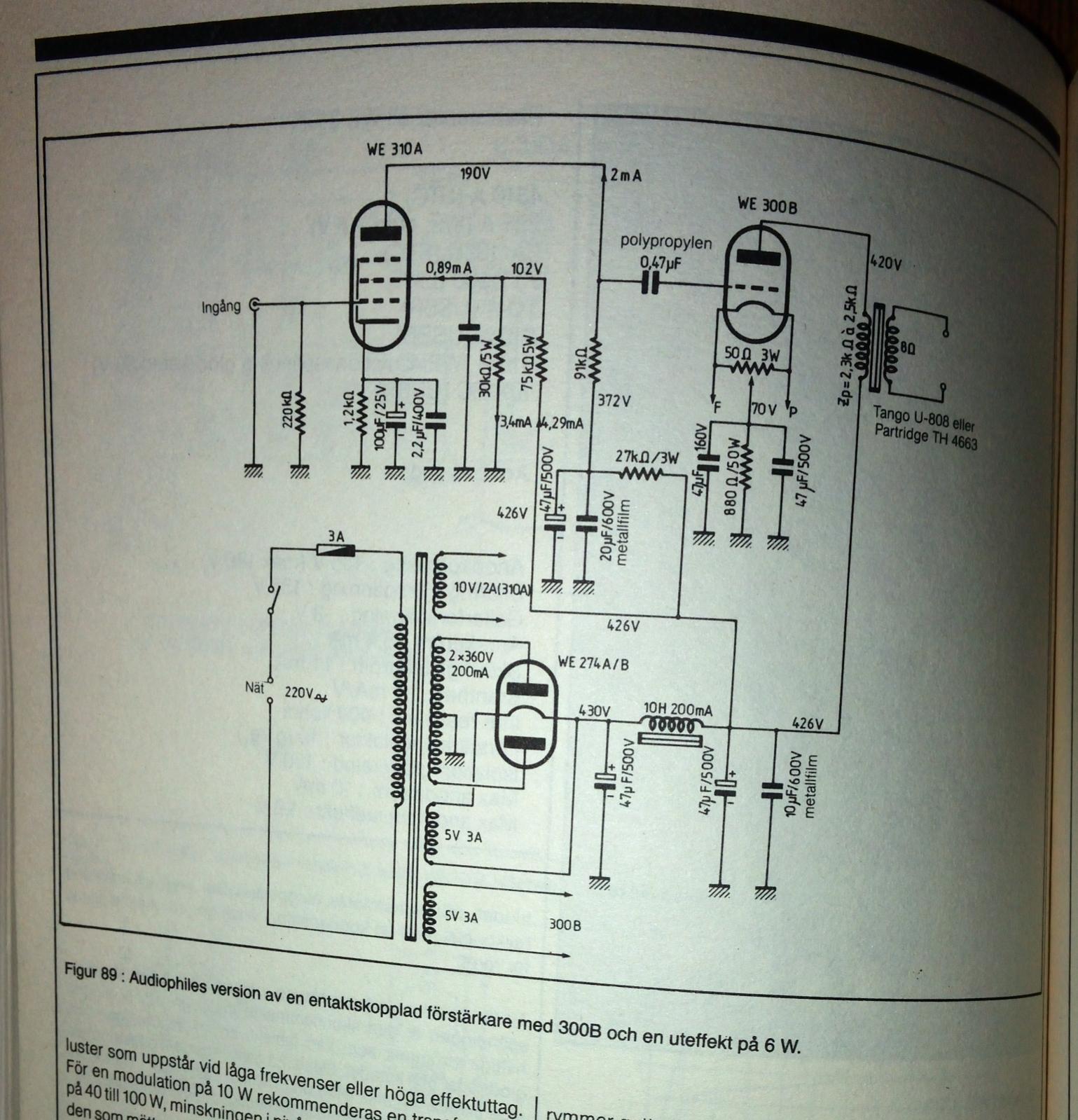

B is probably this amp.
The 10H choke seems to kill most ripple.......and if transformer is physical far away from tubes this probably helps reducing 50/60 Hz noise which seems invisible in distortion measurement.
