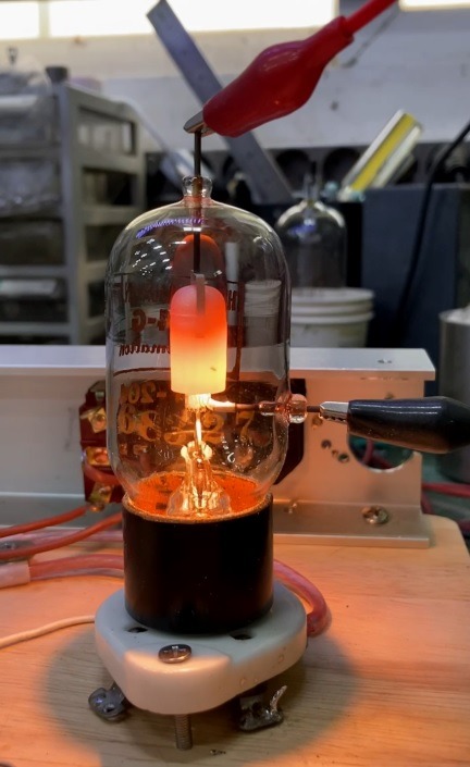

I think he means it looks too safe, compared to other ones. ;-)
Attached is a picture of 3C24 tube in a normal operating condition.
