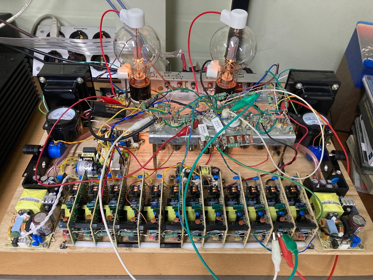

Built on a chopping board, it looks ugly like this.
Sorry, but you asked for it. 🙂

p.s.It was made for a test just two days ago and I need to build it again in a better-looking case.
Are you sure, that -below- 80mA is "enough" in this (below +30V grid voltage?) operating point?
These type of tubes requiring the "crimson plate" to activate getter properly.
The output transformer is for max. 80mA to the primary and I only keep the current.p.s.
As of now, it is adjusted at 480V 80mA. Of course I am not sure of this.
Typical circuits from Japan shows about 350V 120mA but I do not have the transformer for this.
Do you have other suggestions? The other transformer that I have is for 90mA max.
I also will try para-feed method.
If you read 808 datasheet, this operating point not quite optimal for this tube, the current is low.
https://www.google.hu/url?sa=t&rct=...49/8/808.pdf&usg=AOvVaw0qbDdpHYf64NuEMExki5lE
secondly: even with this low positive grid voltage the grid current is significant. Are you sure, that driver capable even 20mA continuos output current?
Hi Euro21,
First, this prototype build is not final, and like I said the available output transformer only allows max 80mA.
808 is 50W plate dissipation tube and I hope to try 480V and 100mA with para feed structure.
As of now, it is not the best but I can enjoy the sound of each step along with the change.
Maybe I have to listen to this as of now until whatever parts are available. This way I can see the change of sound clearly.
Another variable is that I am using Shade feedback or partial feedback.
I see that you looked into the picture closely. Maybe you noticed that I am using each half of two 6H30 tubes instead of one.
This is due to the heater supply of 12V, and I can parallel the two sections to increase the current capability.
And there's no hurry here. My friend is bringing 811 and 812 tubes to put into this circuit, and we will enjoy whatever difference they bring. 🙂. Nothing is tuned best, I am using whatever that I have instead of using the so-called good parts like the Tango transformer, etc.

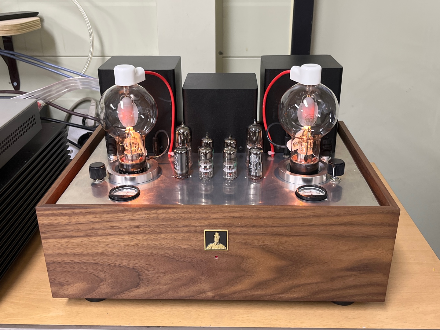

I finished 808 SE in a wood base. I really like this amp.
It is Steve Bench's 841 amp driver section into RCA 808 with 384V on the plate and 110mA.
Big and heavy 200mA plate choke + 10uF 800V para feed cap + 20:1 turn ratio para feed OPT.
I used changeable partial feedback of 2uF+10~60K ohm. But I do not feel a big difference. (I have dumb ears and it takes me many days to feel the subtle difference.)
Very cool driver stage and I am going to apply this to my 2A3 SE amp. 🙂
