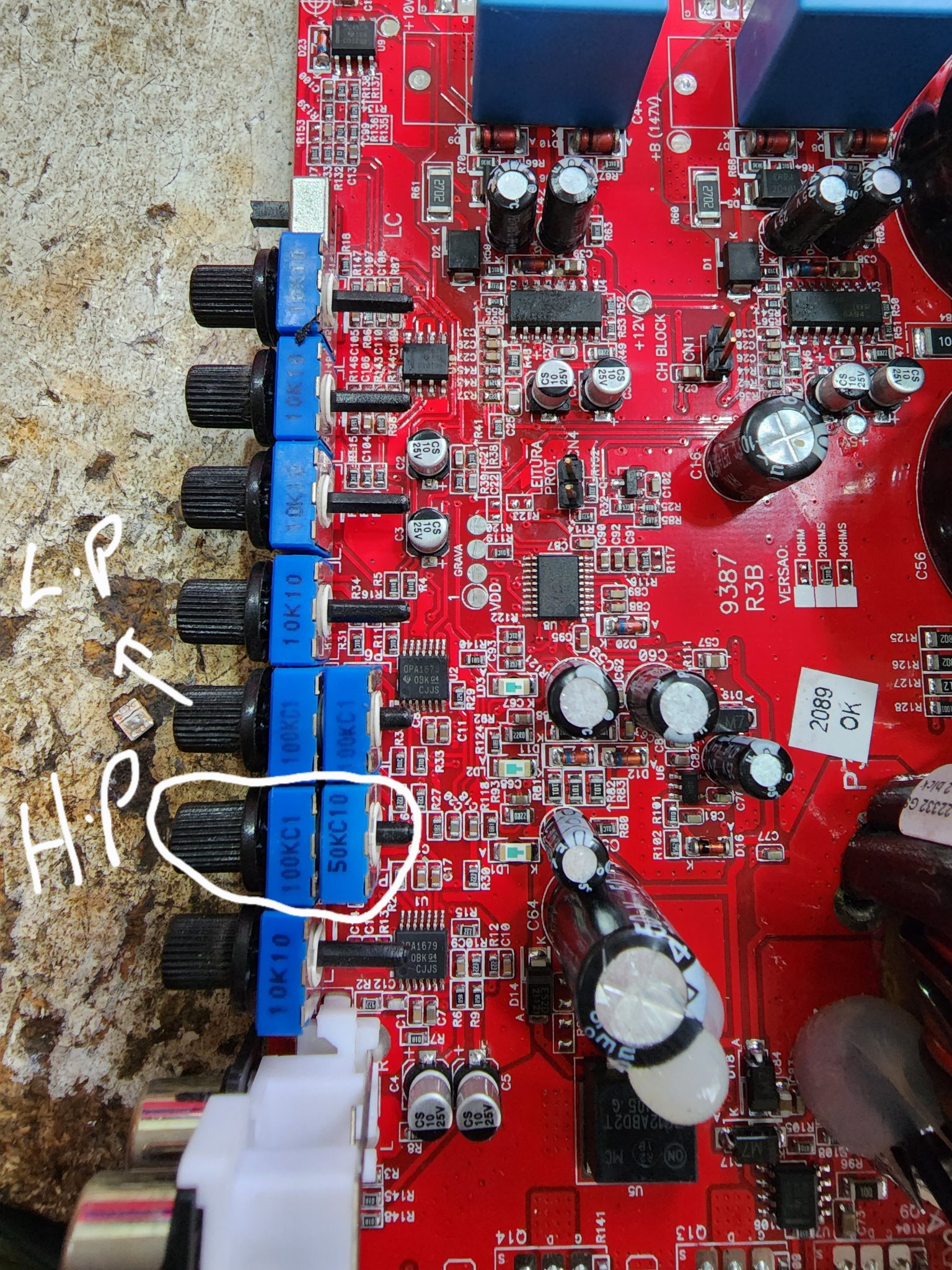

Stetsom with 2 irs2092 Ic. Two channel input with one speaker terminal output.
One ic has 42% duty cycle and the other has 47% duty cycle. Will that make any problem for the amp to go into protect after playing a minute or less?

Both sides makes no difference. I have 3.4v dc on speaker terminals.Does switching 'flat' on/off make a difference?
Across two terminals. Black on negative speaker and red on positive speaker terminal.Where was your black probe when you measured 3.4v?
If you monitor the offset across the speaker terminals from the time the amp powers up (output goes to about 75v (referenced to ground), does the offset increase just before the amp goes into protect?
Using the primary ground as the reference, is the DC voltage on pins 1-6 of the two driver ICs essentially identical?

What i notice is Amp only goes into protect when the flat switch is off. When the flat switch is off gain is very sensitive as I turn very very little amp goes into clip and then protect. I still have 3.2v across speaker terminals. Speaker offset is 45v on one terminal and other terminal has 49v referenced to primary ground.
With the flat switch is on, does the amp produce clean audio on both output terminals?
Are you driving it into a load?

Yes when flat switch is on it produce clean audio. I did not give any load.With the flat switch is on, does the amp produce clean audio on both output terminals?
I used 2.5ohms dummy load and it still have 3.4v across speaker terminals.Do you have a dummy load that you can connect to the amp to see if the offset changes?
Yes it have clean sine wave on both terminals. Even though it has 3.2v across it.Does the amp drive clean audio on both output terminals with the dummy load?
Switch onWhat's the DC voltage on R4, R5, R36 and R37?

R4=5.18v
R5=5.18v
R36 = 2.53v
R37 = 2.53v
Switch off
R4 = 5.18v
R5 = 5.18v
R36 = 2.53v
R37 = 2.53v
