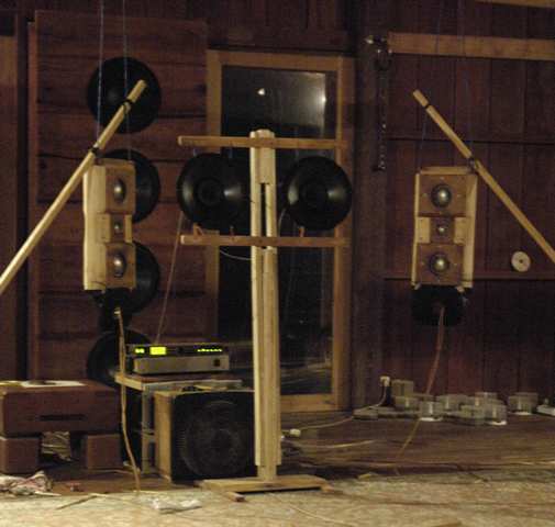

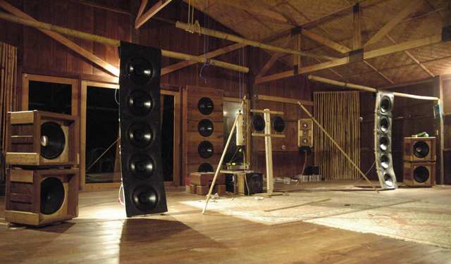

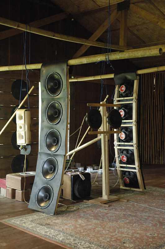

I have also been trying the SSS, almost OT because it's no more with the troika of 4" FR and not from a single speaker, but it's still SSS.
As it's a triamp, the SSS is only applied to the mids channels, but these mids allow many fantaisies till 12000 Hz if required, and at the opposite, the "tweeters" can go well under 1000 Hz, all this in a mouse click. The mid driver is a 12"PA in an array of 5 elements, actually not in Bessel but in power tapered with predominance of the central driver. Naturally as I have stock, the central driver will be the same, a couple of them paralleled, baffleless to go faster. All these details can have some importance, and are not definitive.
The SSS can be shunted at will with a good old cable. Speakers at 3 meters from the back wall, listener generally at 7 meters from the speakers.
first config:
I did very fast a side firing orthogonal. Average quality. With the SSS on, there is a very good first impression of sudden depth. Second impression,this only comes from the loss of level of the mids. Third impression, the mid channels don't give any lateral differentiation on music or pink noise. Left or right, it's the same. Even when asking the maximum from the tweeters it's never satisfying for stereo. Listened from close or far doesn't make any difference. Disaster.
second config:
Going back to the roots, this apparatus is more an OSD than a conventional triangle. For the same reasons, the depth is the first feeling, but this time, the stereo works, and there is something hard to describe, like a better extraction of the information, very evident on the voices. There is a lot of presence in the center, but there is also a greater dynamic of the stereo effect. For example when the guy comes closer to the mike (but it's not the unatural "wide mouth effect"). The background reverberations, as when speaking in a church are better perceived.
So, for me the SSS is in this case a real enhancement. Switching on/off makes no mercy for the normal system.
BTW what puzzles me is that the level of the mids channel is down ot a lot of dB with the SSS drivers in serie, but this is not perceived as a smile curve. The drivers are well in time, there is no cancellation. The central drivers are around -6dB relatively to the arrays, so they are barely audible. Of course without baffle, they start to roll of under 400 Hz, I did an EQ correction for this, but in no case rising up the level of the mid channel is positive. Strange.
Other detail, I have the feeling that the mid channel with SSS has to be low passed under 3000 Hz at least. Over this limit, there is something wrong, but this can be specific of this system.
Very positive idea Elias, thanks for the boost.

Radugazon, you 2nd config is closer to the Gerzon 3 channel setup, including to a degree the hp/lp filters that Gerzon uses.
I was running the Gerzon 3 channel setup with outstanding success. I will be doing this again at some point. I just got to sort out the best implementation.

Wow !!
I agree with optic that the 2nd setup is not a 'single' speaker any more. (Technically, the 1st one isn't, either. Arrays and modular everything, whew~ Oh well.... )
Anyway, the 2nd setup is more of linear matrix 3-ch, but not only that. You got a complex recipe here.

Can you develop more on this Gerzon 3 channels please? I have been searching in the archive, but I'm confused.
I already tried many setups with rear channels, but the SSS if far simpler to implement at first sight. The complications come when it's time to compare subjectively different slopes and different Fc. Any modification affects width and localizations or induce some spatial distorsions. Here, the use of a DSP (DCX in my case) can be seen as a luck or a curse.
An other interrogation is for me the equalisation of the system. Once the matrix is on, it's impossible to isolate a channel for measuring it normally. A thing is sure anyway, the SSS doesn't harm the time cohesion of the system. This step comes from a kind of LR 12 @ 3000, it could have been much worse.
About the pertinence of the extension to the subs, I dunno because the arrays go to 100 Hz already but the central speaker never goes so low, and it already gives good results. Maybe there is a privilegiated band ( exactly the telephone band...) where this works the best. I dunno but I could give a try to this idea.

Hi CLS, following your suggestion I have been trying the SSS on the subs. Paralleled OB going through the IB, this last probably in serie parallel.
I was not expecting this but something happens. In despite of their low pass IV th order under 100 Hz, when listening the subs channel alone, they can reproduce very progressively the translation of an appropriate source as a train passing. When listening the whole system, on a few records some events previously very externalized are now more centered, and the opposite happens with some others.
Better or worse, I dunno what to say, but it's clear that the SSS works also under 100 Hz.
