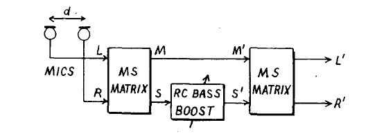

To address the potential problem of tonal balance of the negative vector dipole effect if left uncompensated, now there is a solution !
The signals for the three elements of the SSS are as before:
Lo = L - xR
Ro = R - xL
Co = xL + xR
where parameter x is between:
x = 0...1
Rearranging the terms:
L - xR = (1 - x)L + x(L - R)
R - xL = (1 - x)R + x(R - L)
xL + xR = x(L + R)
And utilising definition of MS stereo:
M = L + R
S = L - R
The three element signals of the SSS can be written as:
Lo = (1 - x)L + xS
Ro = (1 - x)R - xS
Co = xM
Heureka ! 😎
Because L and R remain in same phase in typical mixing practises, the only term causing negative vector is the S signal. S signal forms a sideways dipole in the SSS. This can be compensated easily ! I've drawn one possible configuration below:
Stereo signal is fed into MS matrix to form M and S signals. Then dipole correction is applied to S signal, and compensatory phase correction is applied to M signal. Then using inverse MS matrix signal is transformed back to L and R format which is fed into SSS speaker.
This is expected to correct any possible issues in frequency dependent tonal balance depending on input signals 🙂
- Elias
Looks like I was not shooting in the dark about the MS matrix equaliser, but reinventing the wheel ! 😀
Applications of Blumlein Shuffling to Stereo Microphone Techniques
Gerzon, JAES 1994
http://decoy.iki.fi/dsound/ambisonic/motherlode/data/6939.pdf
Also another document:
Studio Sound, July 1986
Stereo Shuffling: New Approach – Old Technique
http://www.audiosignal.co.uk/Resources/Stereo_shuffling_A4.pdf
I did not try it yet to the SSSx5, simply because I haven't noticed such obvious flawes which would need compensation.
In theory it could improve low frequency stereo effects.
Thanks to Blumlein and Gerzon, stereo reproduction has become very interesting 🙂
- Elias
