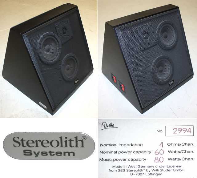

What kind of advertisement is this... Speakers for facilities ??
Now dont put down a fine concept The side firing from a single location is the createst audio innovation since Blumlein, and Ambisonics
What they should do, however, is to put all the marketing department people into the facilities, lock the door from outside and throw away the key

The Gradient Axis drivers could be nice for the sides. Inexpensive and good treble rise.
Übersicht Breitbandlautsprecher
Which one? Why rising treble? The Axis 5 looks pretty horrible beyond 4kHz.
Listening 90° off axis means you need good treble rise to get enough treble at listening position.
That way you'll get too much treble from reflections. Sounds bad, very bad.
Eh, in the Stereolith the treble is coming from the single tilted tweeter !
- Elias
Exactly that's why rising treble for the side drivers isn't necessary nor wanted.
