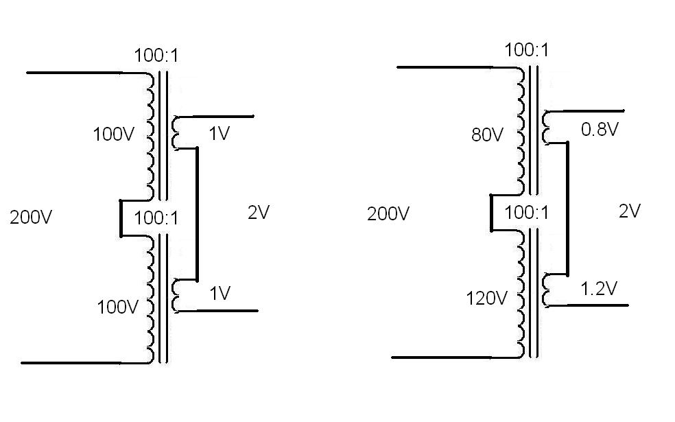

I wrote it before that it's bad habit to stack toroids but as the bearer of the bad massage I got punished by forum members. Only positive feedback is allowed here. Its the same like Facebook and all other social media. The builder wants positive feedback for pushing his ego. If you critizice something, you will be punished by other members.
Might you please elaborate on this? How could some considerable amount of electrical energy in the 50/60 Hz range be transferred simply by a capacitor of, say, in the nF (10-9F) range?The efficient toroid core exhibits poor paramagnetic ability, wide hysteresis loops and a predominantly capacitive rather than magnetic coupling between the primary and the secondary windings which means high distortion, poor frequency response and nasty transients.

Actually I think the builder just wanted some advise on what to build. I am just interested in the science. I guess N101N meant at high frequencies. I agree at high frequencies the core does not do much for you but the coupling is still mainly inductive not capacitive.
They do tend to have much bigger primary inductance, but saturate more ea sally you do need to care of DC balance. They can pass 50Hz at full current and don't saturate (or they would get very hot).
Surprisingly, this isn't the case with the big transformers because so many cheap SMPS mean DC bias on the AC outlet is a normal thing. I have actually used the PP interleaved setup with only one tube (a 120mA DC bias on the coil) and it still worked up to the SE power that the one tube could make without noticeable core saturation.

>Stacking cores will increase the cross section (Ae) by the multiple of the number of cores in the stack.
The magnetic path length (le) will remain constant. The AL can be estimated by the same method as
for single sets, where a leakage adjustment is estimated based on the ratio of window area (WA) to
core area (Ae). Because that ratio decreases as cores are stacked, the AL of n stacked sets are
slightly less than n times the AL of a single set.<
That is correct if the winding goes through both cores but not if each toroid has a separate winding. The magnetic field circulates around the toroid not through the centre - so they don't couple much when placed on top of each other.

One thing I learned in my engineering career is that you will have nearly as many different and often conflicting OPINIONS on a subject as there are engineers associated with it. This is from an engineering facility where over 1000 engineers of various disciplines worked. Many of these can back up their opinions with logical and justifiable solid engineering.
Putting 65 engineers in a large conference room and trying to design a cell phone by committee leads only to CHAOS! If a design were to emerge from that room, it would be a bland "least common denominator" piece of junk. I avoided all such scenarios whenever possible.
This situation is also very much in play in the audio world too.
The OP stated that he wanted a "bedroom power" level amp, and that he preferred PTP construction. The discussion of PC boards in not needed.
These are his only choices so far. We can't even make tube choice recommendations at this point since we don't know where in the world he resides. What's common in Europe is not always common here, and vice versa. The power output levels for "bedroom" SPL can range over 20 dB or more depending on the choice of music, and speaker sensitivity.
I have stacked toroids in some of my amps and would do it again. Ugly, yes. Bad engineering? Not in my opinion. I wouldn't stack an OPT on a power supply toroid, but power on power, or OPT on OPT is OK provided there is sufficient insulation for the voltage levels involved and sufficient mounting stability.
