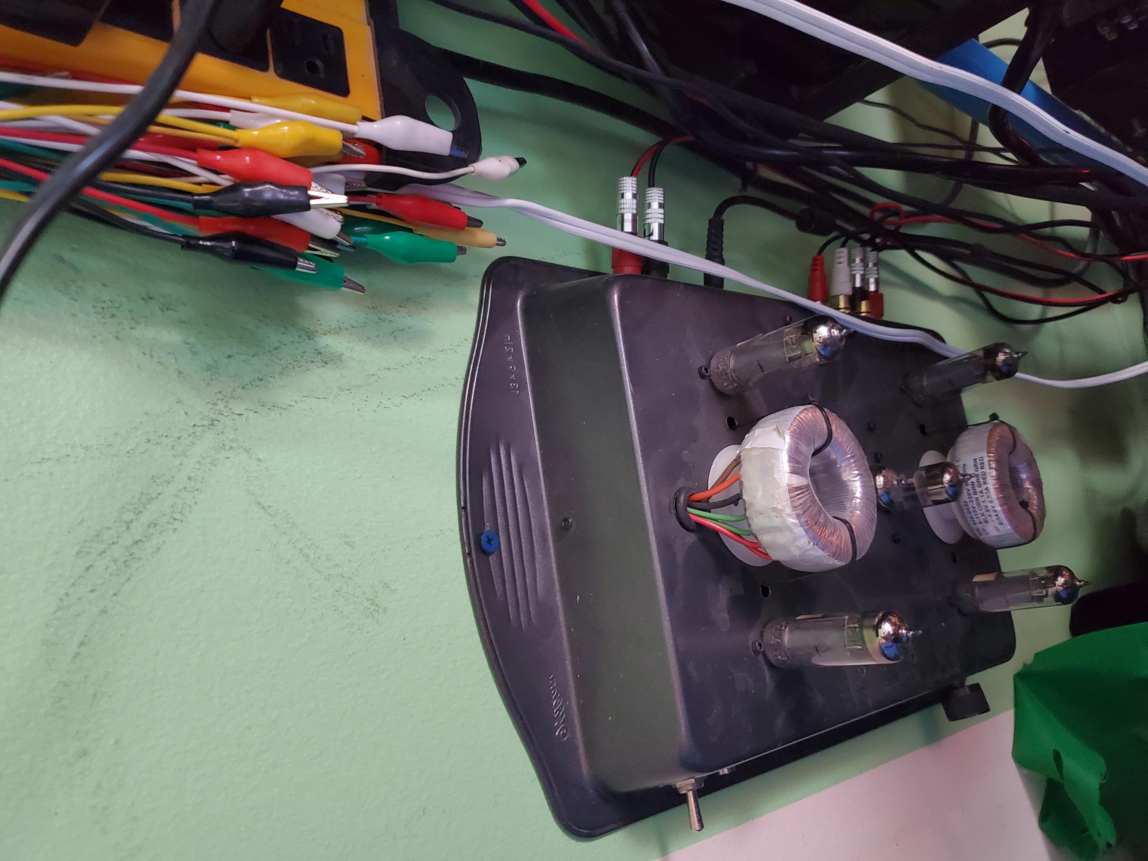

I think you should mount your second toroid on a screw thread a bit above the first with a gap in between. It would look well eccentric.
Haha Kind of like this? Sorry about the angle, it's hanging on a wall.
Originally, I had wanted to mount one coil on top, and the other underneath but I couldn't spare the real estate. This was my take on El Cheapo. It uses 6P15P as pentodes biased with LM317s bypassed by 1000uF, and the frone end is a 6N3 VA into cathodyne PI. It's powered by a 12V 10A brick and a 280V boost converter. Total cost was under 100$ CAD since I built it in a 4$ cake pan.

I think Schmitz didn't want to argue against the use of two toroids as a single OT (I think he's capable of reading the schematics…), but he doesn't like stacking those instead of mounting them side by side.
Anyway, I won't judge it. But I'd also cover all toroids with cans for safety reasons.

There is a cover for it. My dad just didn't want to pay 100$ for a cover for a 150$ amplifier. The transformer primary leads are in a robber sleeve, and the chassis has a rubber grommet. What's the safety issue?

The safety issue covers the toroids themselves. A cover, for instance a soup can ;-), will protect them against accidentally hurting them.

Yes, exactly. By own bad experience it never can be excluded that bare toroids (or other trannies) can be damaged by spiked, edged and/or acute things contacting them.
