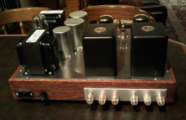

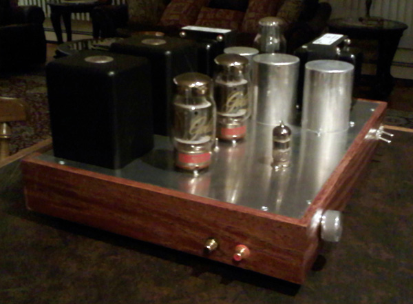

The externals of the amp are finally assembled, the red oak stained with rosewood finish, all terminals, switches, and tubes mounted, and the chassis work is completed, transformers have rubber grommet washers between the chassis plate and their bolts to eliminate any potential electromechanical coupling. For the RC filter (one for each channel) before the 6N1P plate, I bought parts for 10, 15, 47uF caps and 100R, 240R (2W). I am going with be using 10uF + 240R/2w.

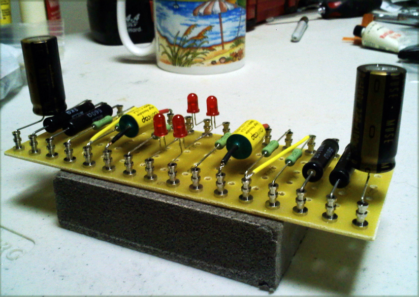

As you can see, the tag board is ready to go, but I am holding off on soldering the final tag board - I am deciding on which design to use.

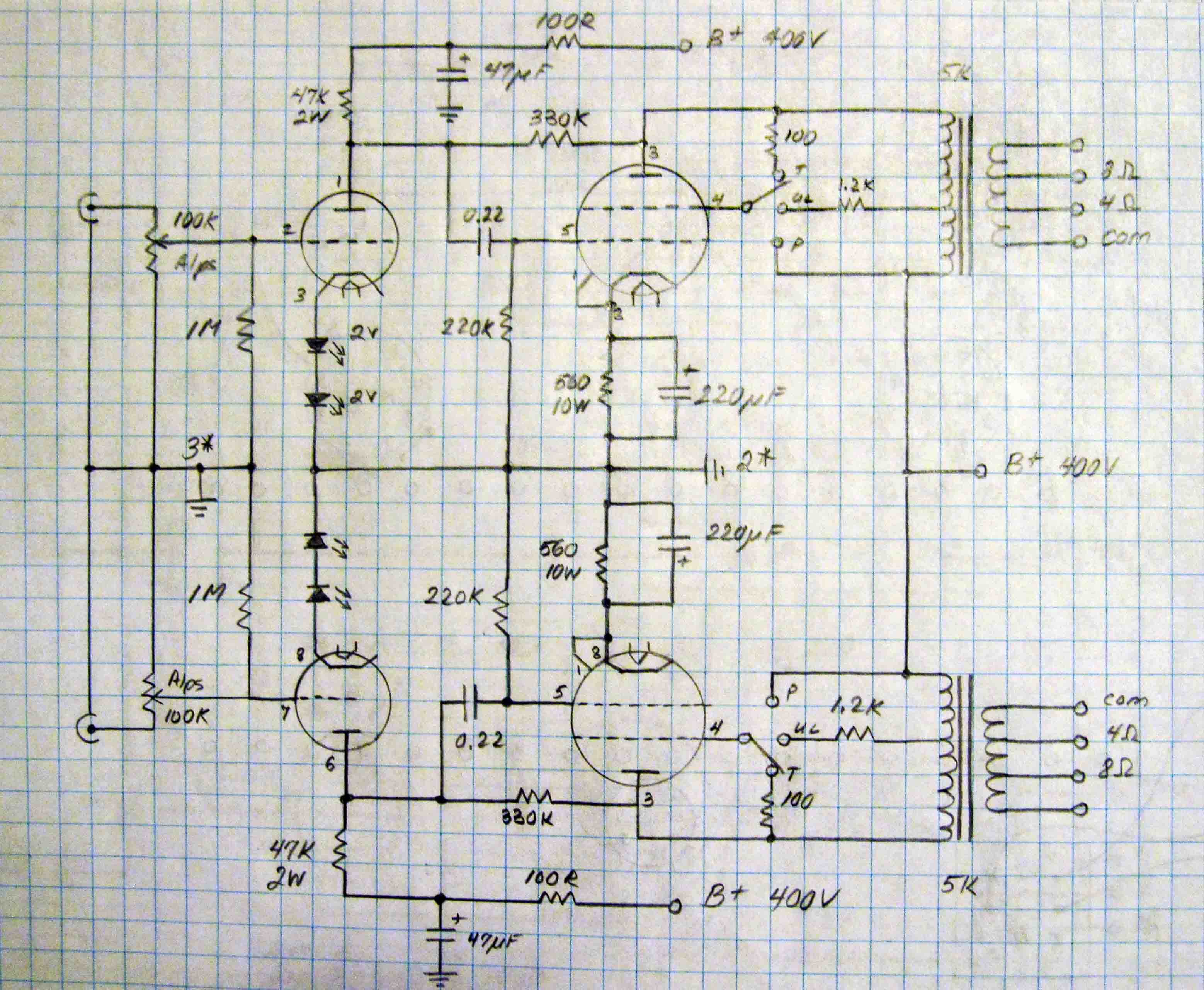

Tag board 1:
-with 330k feedback resistor between KT88 and 6N1P plates
-with 1k series KT88 grid input resistor
-with 1M 6N1P input resistor to ground
-OR-

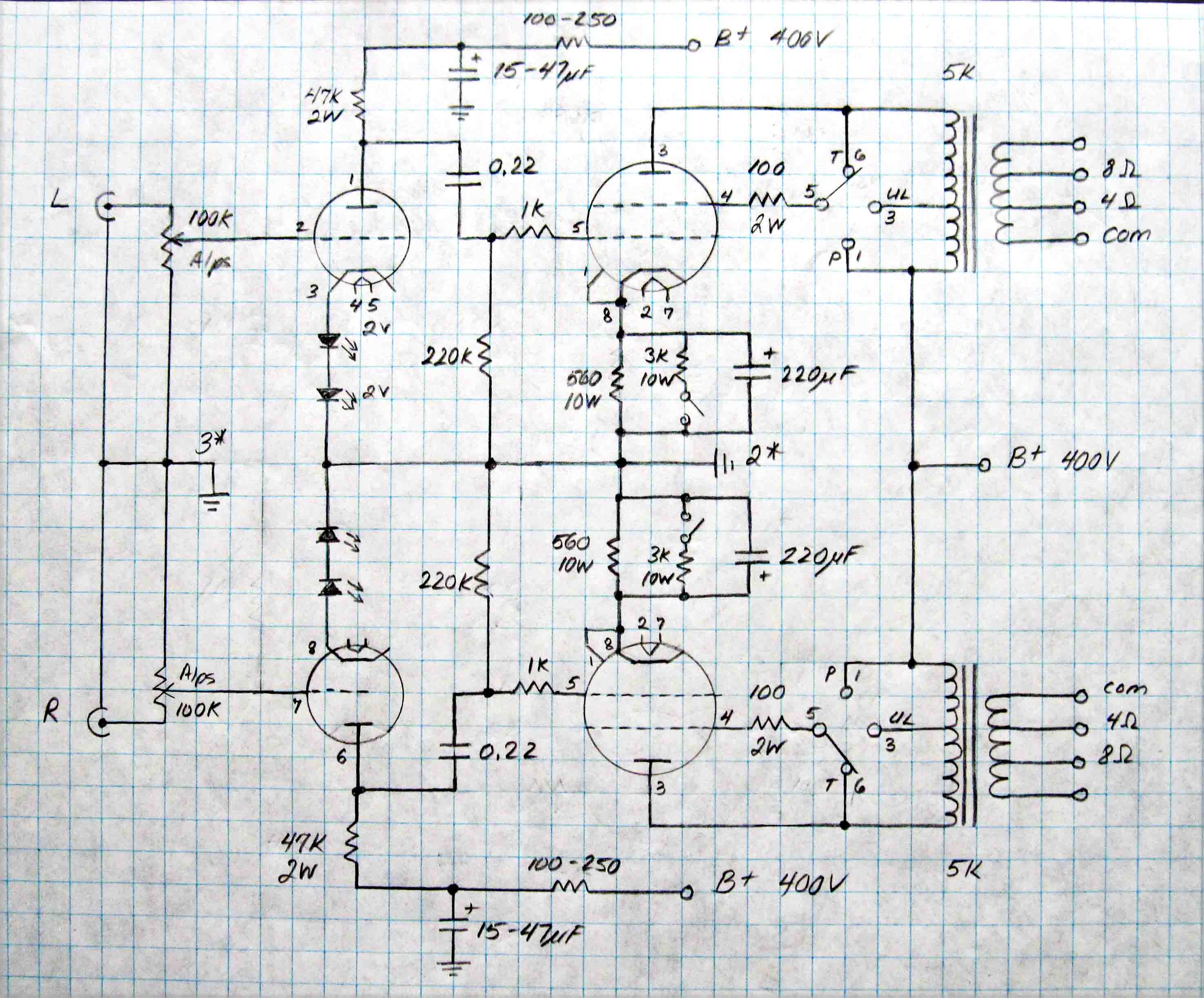

Tag board 2:
-NO 330k feedback resistor between KT88 and 6N1P plates
-NO 1k series KT88 grid input resistor
-NO 1M 6N1P input resistor to ground
Questions:
1. Which tag board/schematic will yield better sonics?
2. Will it matter what combination of RC I'll use for the filter?
Thanks guys, I could really use your advice since this is my first DIY project.

88man,
Your build looks very, very nice. Excellent craftsmanship. I would use the 1K grid input resistor on the KT88s. I did not use the 1M to GND for the driver, but I did not use a volume control on the amp. I used 100K to GND for the inputs. As far as the feedback goes, I would probably not bother with it if I was to build again as I think it takes away from the overall sonics of the amp. You could always add a DPDT and switch it in or out to see what you think. I used an LC filter (5H+10uf) for each driver channel. If you are going with RC it appears that most use the 250R+10uf circuit.

Does the feedback path only applies to UL mode? Is it safe to leave it there in the 2 other modes?
If you try feedback on this amp I would make sure you can switch it in or out. It only seems to clear up a bit of distortion in the UL mode when running wide open.
