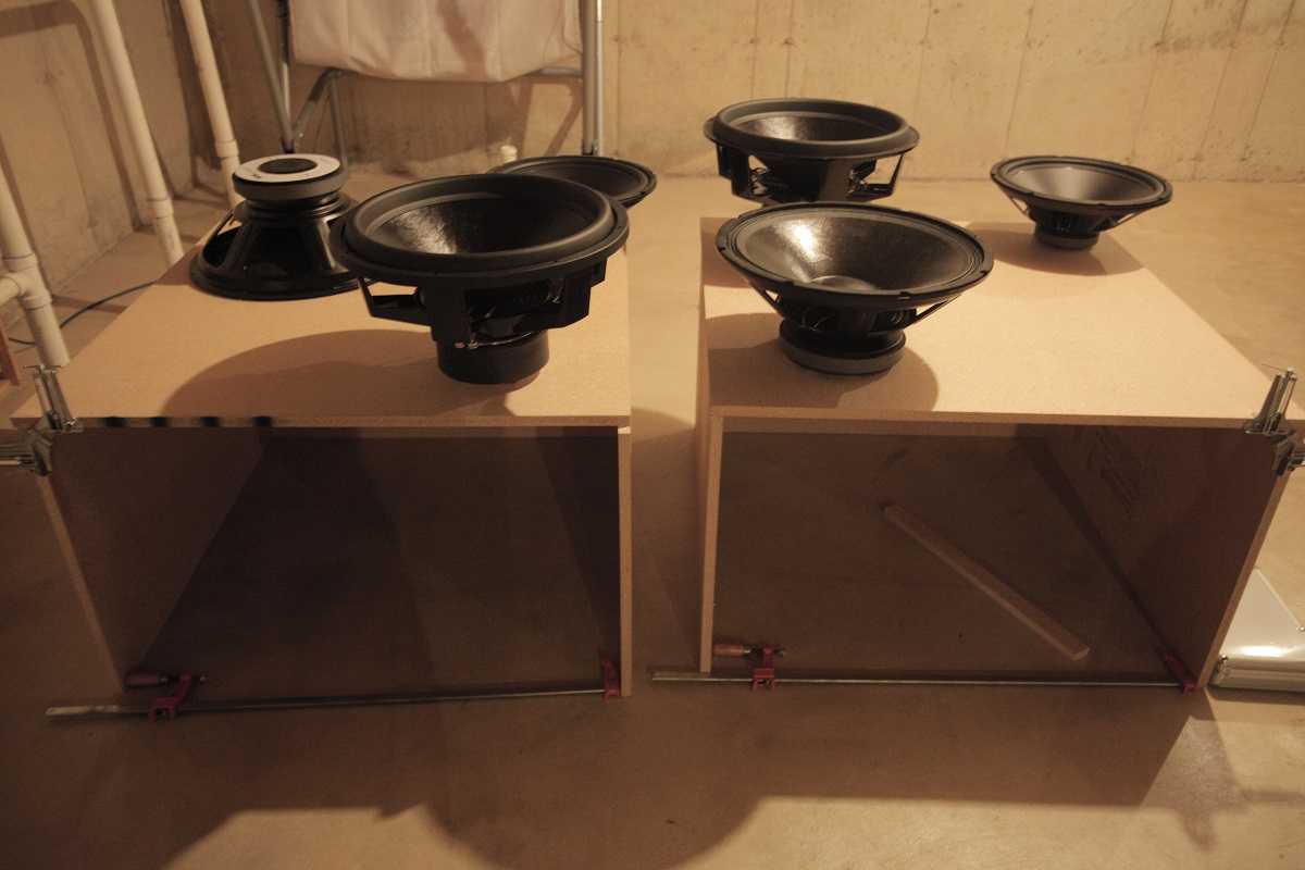

I did try a tapped horn, didn't work out too well. I'm not sure what to call the design I ended up doing.
It's technically a 6th order BP due to both the driver and rear vent being recessed enough for the 'trapped' air to exert a small amount of acoustic loading on the front of the driver and due to its long, tapered rear vent, this makes it a TH, just a very low gain one.

The back loaded horn will require a hipass regardless of the 50v input (no sealed rear chamber for excursion control below Fc), A lot of its smoothness in passband also relies on the smoothing of response when adding more horns to the stack (a phenomenon which IM *pretty* sure only occurs with FLHs, although as modeled with hornresp is attributed to all designs), AND the added smoothness from corner loading.
I was reluctant to rely on corner loading to have a smooth response. Although, I figured that I had my old 18's in the corner for almost 2 years, I'll just do the same with these.

I did add in the 3" recess in the Transmission Line software, the change was negligible. It wasn't worth changing the Hornresp input. Interesting how it can be technically considered a BP! I used that logic to consider it a TH, but I think Shadydave is right saying its more of a back loaded horn.

And my current progress:
