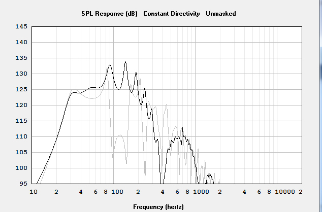

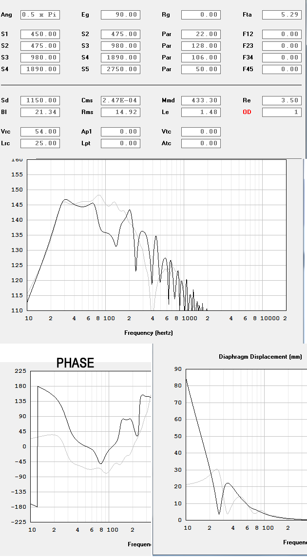

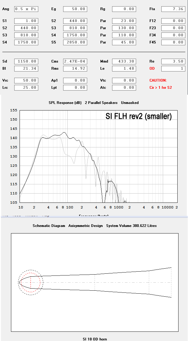

I know you've already built/cut your wood (and made a very nice model for your enclosure, GREAT WORK!), but heres a pair of FLH of similar size (425liters) compared to your BLH, both shown at 90 volts. The BLH does support a lower hipass (21hz 18 db/oct BW filter) vs the FLH pair ( 24hz 18db/oct bw filter), but since both of these are well out of the intended pass band, the result is still similar.
Black is your horn, grey is FLH. both compared in eighth space as per your spec. It likely took me longer to layout the picture in photoshop than it did to make the sim for this (fold is a different matter entirely).

In that case Al, I think you of all people should appreciate the benefit behind my proposed design. I've double the usable bandwidth, significantly flattened response, flattened phase anomalies (albeit added about 10ms of group delay down around 30hz), picked up almost 15 db of output in your precious "Kick Drum" area, all while maintaining the same net volume, and compromising very little in added excursion.
If kept to 50v (around the RMS value of the driver, and the proposed usage level for OP) it can easily be run without a hipass (with excursion peaking at a mere 17 mm at 25 hz, decreasing below that. It uses a low compression ratio (2.42:1) so little worry of cone damage as well. the only place where it loses ANY output (about .5db) is between 30 and 40hz.
The back loaded horn will require a hipass regardless of the 50v input (no sealed rear chamber for excursion control below Fc), A lot of its smoothness in passband also relies on the smoothing of response when adding more horns to the stack (a phenomenon which IM *pretty* sure only occurs with FLHs, although as modeled with hornresp is attributed to all designs), AND the added smoothness from corner loading.
hell, givin the 50v drive input into the SI, even our little friend the LAB 12 can almost match output down to 30hz in that sized package (FLH) without exceeding xmax (this isnt a shot abcdmku, just a observation).
a single cab, half space comparison is more telling in reference to the above mentioned points (before the lab12 bit).

IF willing to give up about 1 db of sensitivity below 40hz (which, at this voltage in, can be eqed back considering the gobs of excursion headroom left), and increase compression up to 2.61:1, you can reduce the FLH size to 380 liters, almost a solid 1.5 cubic feet less sim volume.
