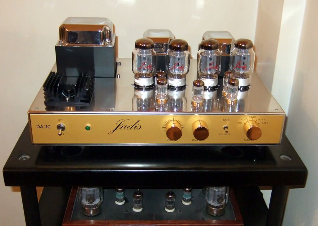

Some sound check.
I have a neighbor, he owns a Jadis DA30 (Euro 5600). He brought it around to compare, because he liked the sound of the ugly one.
He preferred the ugly one's sonics by large.
My opinion is that the Jadis is very respectable for sonics and has real value construction, but its tuned for classical.
Anyway, the ugly one proved potent in exalted company and that is good news.
In the photo, the ugly one lurks below the beautiful French waiting for the lights to dim out. 🤐

I have it on good authority that the French word "Jadis" translates, roughly, to the English phrase "don't bother us with engineering; we're artists". You've probably got the better amp there Salas, and I'll bet that you spent a good bit less than 5600 Euros on it. Still the Jadis is kind of pretty, but then so are Renaults and Peugeots.
