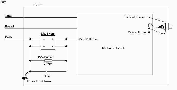

Note that I caveated the 27R a few posts back:
Your points regarding practical implementation are, as usual, greatly appreciated. See, we even agree on the cap value! A heavy duty bridge does seem sensible and practical.
I show a resistor (27 ohms is a safe value), but it's been pointed out that this could compromise safety. These days, I use a 27-33R resistor paralleled by 1nF and two diodes (in parallel, each "facing" the opposite direction).
That safe lift looks very similar to that posted on Elliot Sound Products page, with the exception of the resistor value. For reference, here is a link to the entire Elliot Sound Products grounding article.
http://sound.westhost.com/earthing.htm
Of course. I just edited the values as by Beck's recommendations. You can see 'esp' on top left of the picture I posted.
Sorry Salas, wasn't meaning to point the finger or anything... Just thought I recognised the diagram (my eyes did not see the esp logo). When I checked the esp page, I thought that the information there might be of interest to you and others following he thread.
Chris
Chris
No worries mate. We just diy and we try to put concepts together for all to benefit from. No sages here. Had this drawing in my hard disk, Beck was describing just that but with different decoupling values, I posted it fast. Came handy. Its about safety, and a picture catches the eye. Its because SY and Beck contributed a very important note on safety.

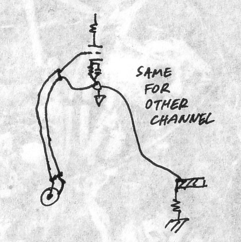

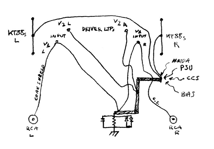

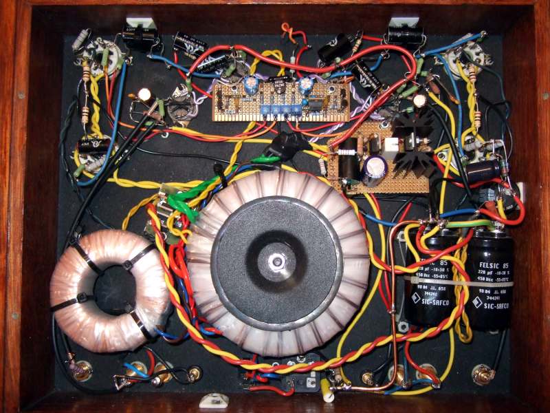

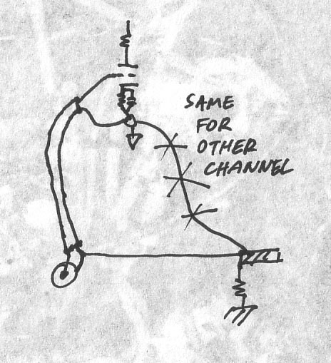

Did the amp. Sounds great. But I get a minor ground loop. Some zzzz, not that bad but its there. Followed our bus bar scheme. See how it finally looks like in the attached picture. If I plug one channel out, the amp is silent as a tomb. Both channels in, same low zzzz on both channels. If I break one input coax shield with a 10R, I get the broken earth channel buzzing louder than before but the other channel becomes quiet. Lifted the mains earth on amp, preamp, source. Nothing. Its between L&R meeting in the amp. Ideas of what to change?

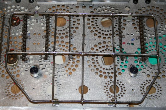

For over 40 years in amp designs I have always used a closed earth loop concept and it works. Pic of 3.5mm bus interconneced in grid form shown for 2x150W stereo using parallel o/p pairs. With this closed bus one can be rest assured that both sides will perform symmetrically with excellent 15Khz separation performance at full power and hum isn't an issue.
Using a chassis with tags, they nearly always work loose.

I have zero hum. I have minor zzzz when L&R inputs are connected. Dead quiet when only one input is connected.
Looking at the drawing you posted in #29 shows something of potential concern. You show the coax going from the jack of each channel, to the input of each channel, then to ground buss.
Do you have the ground of each coax going to the ground of the fist stage first, or were you just implying the signal only?
If you grounded each channels coax to the input of each stage first, that can cause a loop when both channels are plugged in. The coax ground of each channel should connect to the buss at the end thats grounded. This should also be the point where your first stage of each channel should be grounded as well.
Just remember your source most likely has the commons of each channel tied together at the output. So there should be no circuitry grounded between the point where the ground conductors of the two coax cables join. Otherwise that part of the circuitry will be in the loop.
If you get desperate try disconnecting one end (at the RCA jack side) of a single channels coax ground conductor.
Also, you may want to consider putting a grid-stopper resistor on the input of the first tube.
Jeb-D. said:Do you have the ground of each coax going to the ground of the fist stage first, or were you just implying the signal only?
Thats what I have now.
