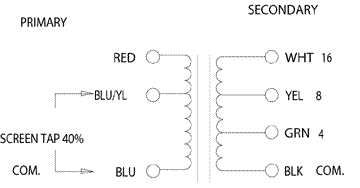

On another topic, I'm looking at the wiring diagram for the Hammond 1628SE OT's. On the primary side they list the the blue lead as common, then there is a red lead and a blue/yellow lead for the 40% screen tap. My question is, does the B+ go to the black lead, and the plate of the KT88 go to the red lead, or the other way around? I assume the screen (pin #4) of the KT88 goes to the 40% screen tap.
This is my first SE amp, I'm used of PP designs so this is a little different.

Does the red lead on the OT go to B+, and the black lead go to the plate of the KT88, or is it the other way around.
I assume this makes a difference, as the screen tap is not at 50%, otherwise I don't think it would matter.

Thanks Simpleton, but that's where I started.
The Hammond schematic still does not tell me which lead goes to the B+.
I think what's confusing me is the label of "common" on the black lead.
Does this go to the plate on the KT88, or to the B+?😕
Again, this is my first SE amp,
I'm more familiar with PP designs as on all my guitar amps.
Glenn

The wire closest to the UL tap goes to the plate, so in this case, it's the red wire. The blue one is B+.
