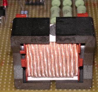

So I am experimenting with a stepped gap choke, that will result in a high inductance for low currents and lower (but stable) inductance at high current levels.
I am planning to use two EVD36 ferrite chokes in series.
The main winding is 41 turns in 3 layers. Wire is a 150x0.1mm stranded HF-litz with additional silk covering.
The auxiliary winding is a teflon isolated AWG 30, 12 turns.
(Probably 6 turns will do it, but the auxiliary is a side topic ....)
Each choke has a 2.8mm gap in each leg. I am partially closing these gaps with ferrite as shown in the pic above.
The small ferrite short cuts have an area of 20mm^2 in each outer leg and and 40mm^2 in the center leg, while the entire EVD36 offers an Ae=150mm^2.

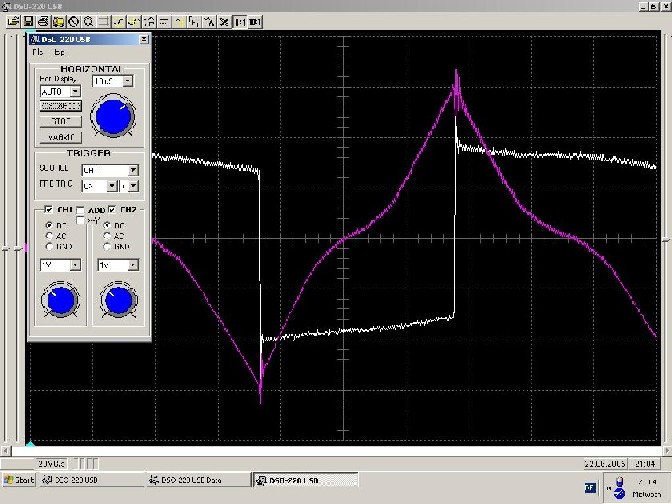

For low currents the short cuts provide a low magnetic resistance and the inductance is high. At high currents these short cuts run into saturation and the choke show an inductance as a normal gapped design. For the short cuts I have to use a low loss ferrite as N87 or similar, to keep hot spots during saturation acceptable.
I measured a single choke and got an inductance around 600µH at low levels and linear 160µH in the range between 5A - 15A.
See attached screen shot.
White Trace = voltage across choke: 100V / Div.
Red Trace = current though choke: 5A / Div.

I don't know how this particular topology will behave, but I have experimented with flybacks working in crytical conduction mode, and in practice, the minimum-load switching frequency is gently limited by the switching times, crossover times and the dead time. Note that crossover times increase dramatically at low currents due to the internal capacitance of the diodes and the switches.
I've also experimented with the stepped gap approach to create non-linear inductors and it works fine, but be aware that these small ferrite pieces will show some losses.
However, I think your switching frequency in practice will not increase above 400Khz, even using a standard inductor and very small loads.
