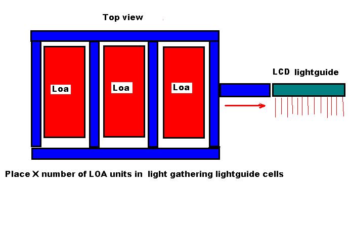

The other approach worth considering is overkill. Use more LOA units and flood the area. Some of the light will be contributing.

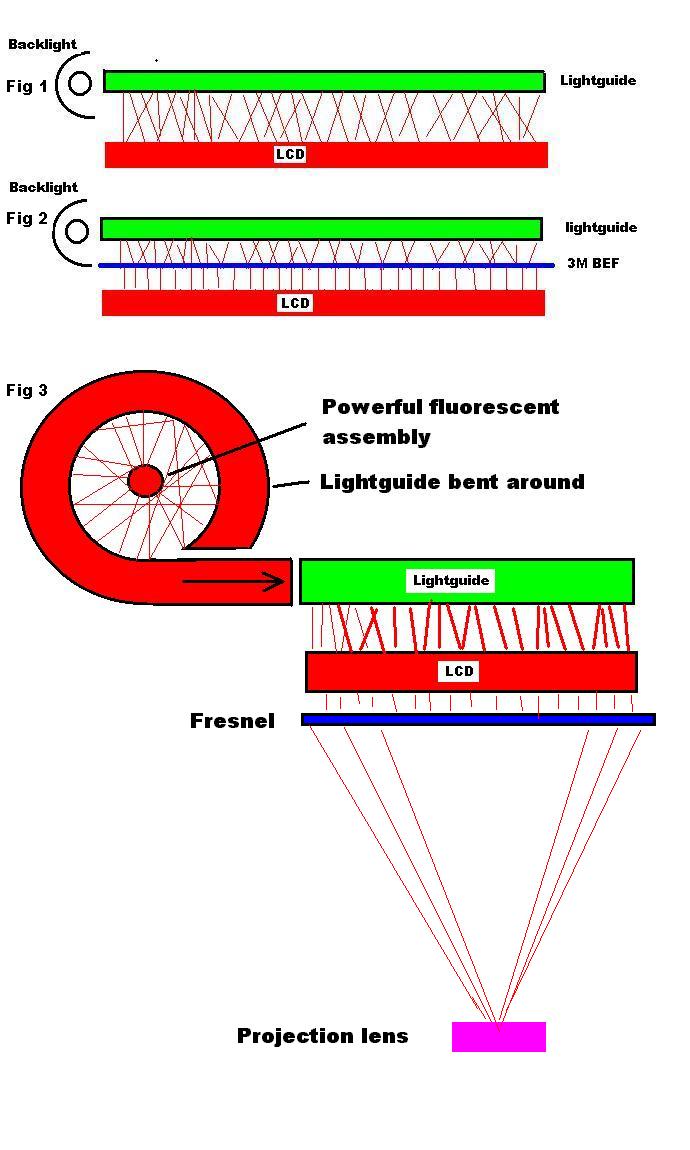

The drawing might help.
Fig 1 shows a typical edge lit LCD. Light comes in from a thin cold cathode fluorescent type lamp. Goes into a lightguide which spreads the light across the rear of the LCD and allows it to go forward.
Fig 2 shows the same thing but with a 3M Brightness Enhancing Film sandwiched between the lightguide and the rear of the LCD. Its purpose is to straighten up the light so you get more light going forward giving a brighter LCD with a smaller viewing angle.
Fig 3. Light processes are reversible. This is handy and if we took an LCD lightguide and bent it around an LOA tube or several or some other very powerful fluorescent combination it might be possible to collect a far greater amount than from a regular reflector and then channel that light into your LCD backlight and provide enough light for projection.
Lightguides rely on total internal reflection eg If you get a piece of perspex say 1/8 inch thick with highly polished surfaces and highly polished edges and you shine a light into one edge, all the light stays inside the perspex and does not come out. If you then scratch one surface some light will exit at that point. So I am thinking it should be possible to bend a piece of perspex around and score the surface on the inside. The light from the fluorescent combination should enter the perspex and not come out except at the exit port. This needs research but it could be a viable method and its quite cheap
I'd like to find a fibre optic sollution. With fibre attached along every edge of the light guide...all 4 sides. Perhaps even going a little further by having certain "areas" seperated from others for independant controll, ie: make the corners "dimable" incase you get "hot " areas due to the extra light concentrated in the corners. Anyone know the logistics of connecting fibre optics to the edge of the plastic light guide?

Spending some time at the 3M site I found some of this stuff that looks like it could possibly be used.
Vikuiti™ Transmissive Right Angle Film (TRAF) is a dual purpose transparent optical film that redirects light toward the on-axis viewer in edge-lit systems. While in displays with multiple or serpentine light sources you can use the film as a beam splitter to create a more uniform light source.
If you visit the following link you can see how they recommend its usage as an LCD backlight, which is essentially what we need to create, a really really bright backlight.
http://multimedia.mmm.com/mws/mediawebserver.dyn?rrrrrr9yJCFrL7Srd7Srrr2yFb4O0kAY-
I sent an inquiry in about pricing/samples of the stuff.. will see how they are about getting back to me. 🙂
If this could be used, maybe in conjunction with a light guide it may be possible to shrink the size of the projector considerably and still end up with better results.

I thought you might like that one.
Crash has got it sussed
Thats exactly right. None of this fiddling with huge bulbs and lenses and reflectors and such.
We got to get modern. Make a better mousetrap.

**ow** my brain hurts:bigeyes: is it me or do these plans look a bit comlex. nonetheless these plans are great. Great minds are at hand😉. what i plan to do is crazy and i understand that the chances are 50/50 of success/failure maybe less or more. as you guys might know, i plan to buy a high powered Opaque project and assemble/disassemble and make custom lighting and what ever i think may work. im optimistic 🙂 **On Topic** i plan to use LOas.
Goodluck to fellow Diy-ers!
-JimmY-
remp
remp you never cease to amaze me with the value and solid research of your post's. Without fail you dig out the nuggets (ever do any gold panning?) of knowledge that make the answers that much closer.
I think the 4 injection diagram in the data sheet is the answer, the light source to be determined....fibre optic, high intensity LED's or perhaps as disscused a HUGE light source collected and transmitted via lightpipes.
